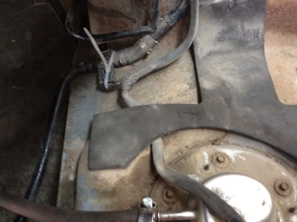

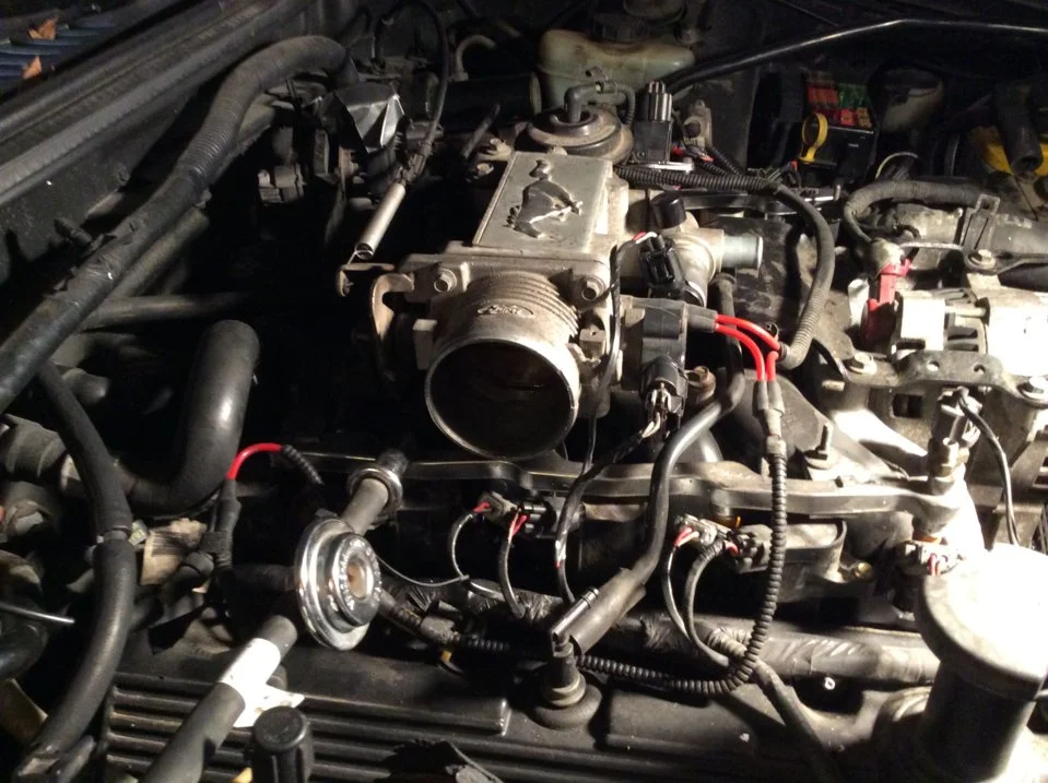

Also gas still coming out of here: attached picture..
Also this clip appears to not be attachIng properly see zip ties, what is this and what would I need to replace? The entire harness or is that part of the fuel pump?

The pressure building up with the ignition on is good. The pressure will drop off some , but it shouldn't just drop quickly to 0. If you try to start it, the pressure will probably go up a little more, until it starts. The PPRV in the fuel tank will keep some of the pressure on, so that when you turn on the ignition, it doesn't have to re-prime. So that is fine.
Gas coming out of the throttle body is BAD. I have actually never seen that before.
You are trying to start it with the intake on right? The air going into the engine must be metered by the MAF. If not, it is just like having a vacuum leak, unmetered air is entering the engine and the ecu is not adding enough, or adding too much fuel.
