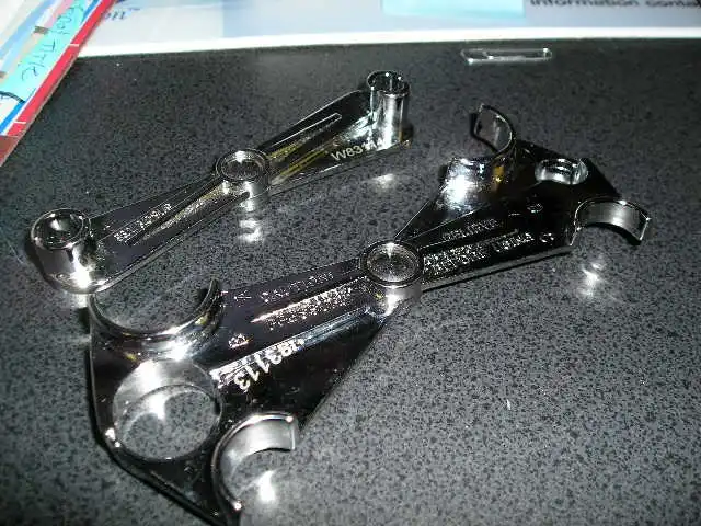

you are also going to need the line loc release tool it works on a/cs too heres the pic
