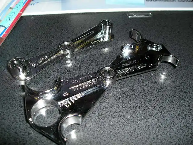

you are also going to need the line loc release tool it works on a/cs too heres the pic
u actually only need a flat head screw driver. forget wasting money on that thing.

Or you can buy the cheaper little plastic ones that they sell at Pep Boys or any other parts store.
Agreed! Those scissor style tools are a PITA. The little plastic disconnects make it simple. I fought with the scissor type for 30 minutes, then got the plastic one - and I was done in 30 secs.
