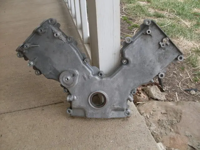

hey guys, my 2001 gt wont turn over after i replaced a timing tensioner and timing chain. while i had it all apart i painted my timing cover. does anyone know if anything grounds to the timing cover? would that cause the car to not start?

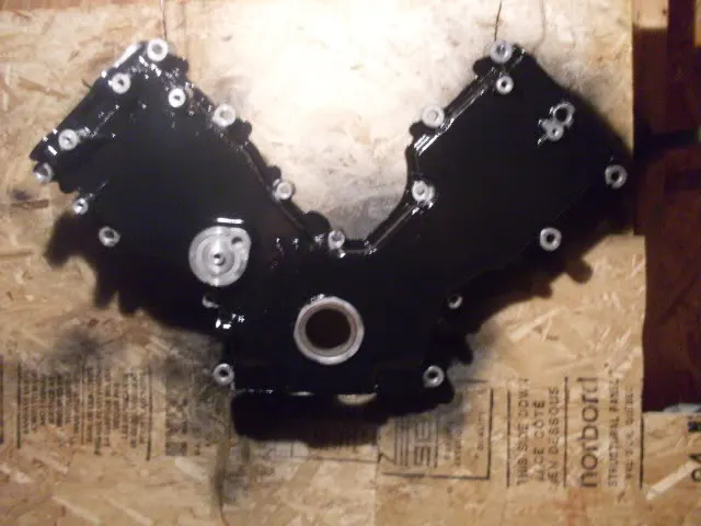

alright here goes the full story and progress pics....
i could hear my timing chain running like a bicycle if i would give the car a bit of gas.

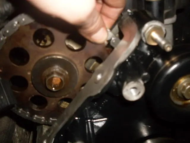

so i began to tear down to see what the problem is, and the passenger side timing chain was way too loose, so i replaced with a new tensioner and timing chain on that side and the chain now stays tight. got it all put back together and now it wont start and is having the symptoms i have listed above.

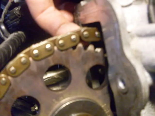

here is the loose chain
timing cover before paint
after paint
pulling on the new chain has hardly any slack at all

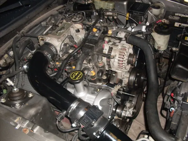

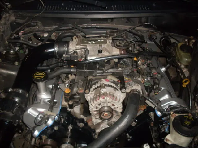

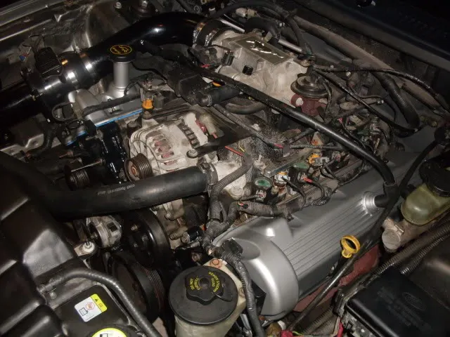

motor all put back together with valve covers painted...

The only grounds I can remember, 1 off the back of the d/s head to the firewall. 1 from the d/s motor mount to the frame, 1 from battery negative harness to the frame, then the h/l grounds and all those small little bastards. There should be two different o ring connectors going to your power dist box. The you do hav two metal brackets the mount to the bottom two timing cover bolts that hold ur wires up and out of the way. There are no grounds to the t/cover that I can remember.
