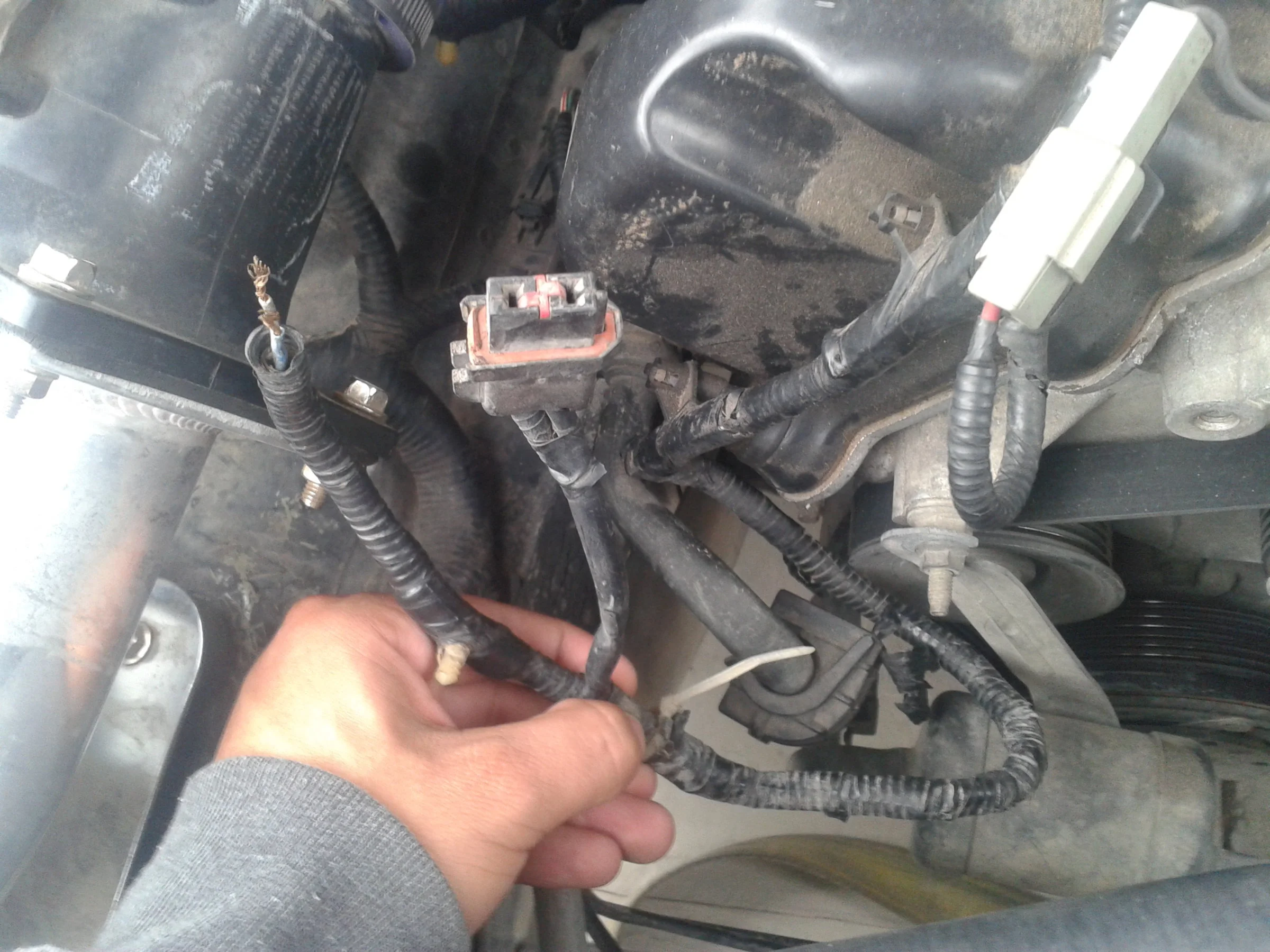

My car wont start I'm thinking its a bad pcm or n o power to pcm. car turns wont start, it had -------- on odometer and electric fan turns on when key is on postion. and need to know what plug is connected next to the tps, its been unplugged and I don't know where it should be plugged in. thankz anything will help

Pictures of your engine bay (point at disconnected connector) would be best. No guess work involved.

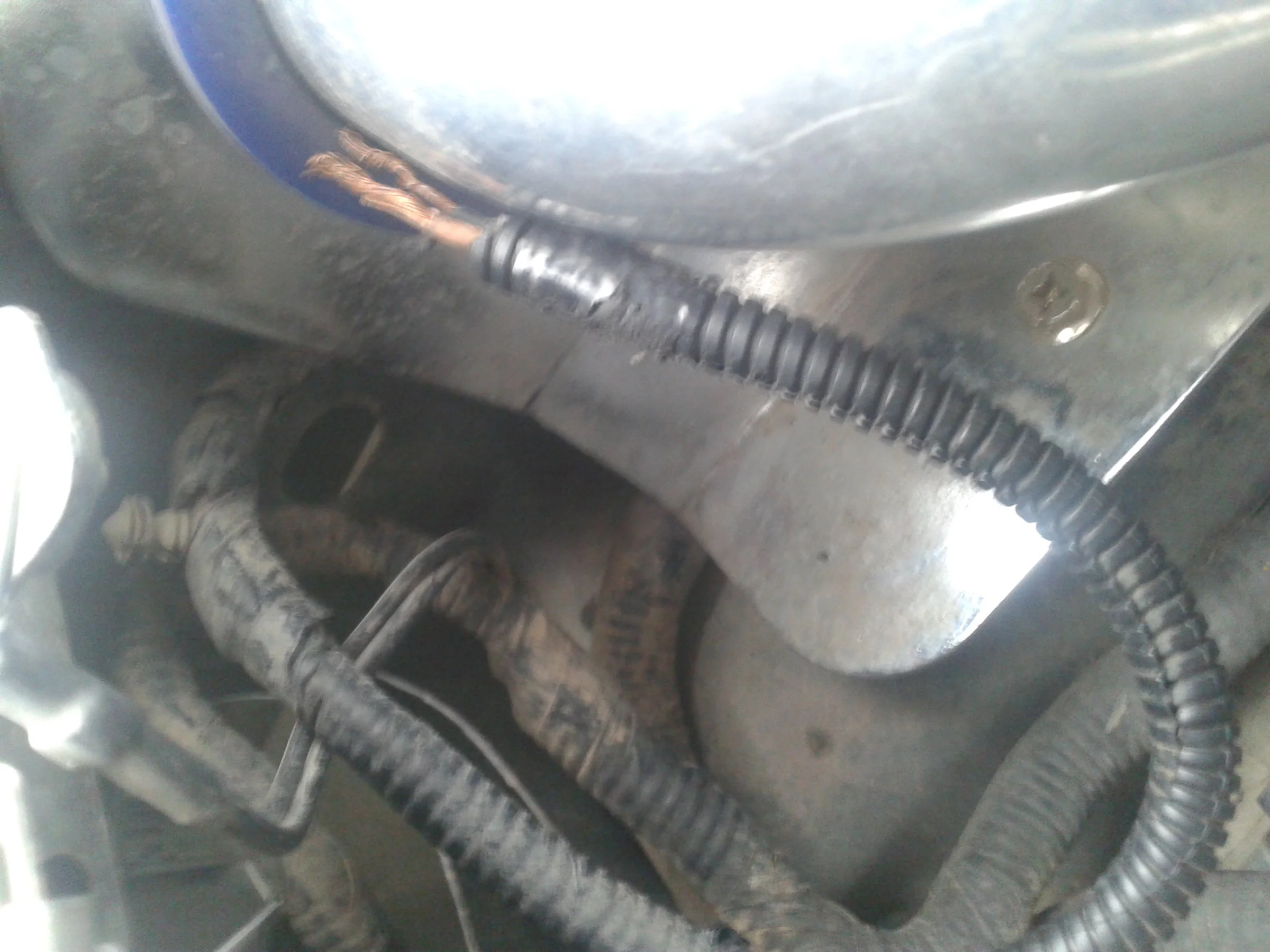

Hello hope this can help you out..: the -------means pcm readiness not complete. That happens when the brain looses programming sometimes can happen from the battery being disconnected for long periods of time. Or if the tuning hasn't been completed usually that goes away after a good charge and a long long drive. The plug you showed looks like the A/C power plug just from the shape but the plug next to the TPS is the IAC (idle air control) plug and that is not the same shape. the two stripped wires you have shown in the other picture are for the TPS (throttle position sensor.) So your easiest bet would either contact Ford for a new plug and solder it in place or if you want to splurge a little you can get a new wire harness that hasn't been doctored up. If you weren't getting any power to the PCM (powertrain control module) the motor wouldn't even turn. Fix those two and you'll most likely be cooking with fire., let me know what happens.
The connector goes to the AC clutch.
As for the ripped out wire. I seriously suspect they go to the CKP sensor. The CKP sensor wire colors are DB and GY.
OBTW, without a CKP sensor signal this motor will NEVER start. This looks like your smoking gun!
I also strongly suspect there are blown fuses.

FIX the wire that has been pulled out from the CKP sensor and you may be surprised what happens next.
Or go back to your Dads Friend's shop with the new information about the CKP sensor.
I can assure you that the motor will NEVER start as long as the CKP sensor wires are dangling.

I fixed the cpk wire. before the pats thing happened i could start my car with no fuel pump prime up on a HOT day but when I pressed the gas the engine would die real quick or would die after idling after 3 -5 mins whitout pressing gas but my fuel pump was good(tested it) and had it replaced recently, I don't know what would cause that to happen?? and ill have to talk to my dads mechanic to see what he did to cause pats-_- thank you for all the help i appreciate it burns :)
