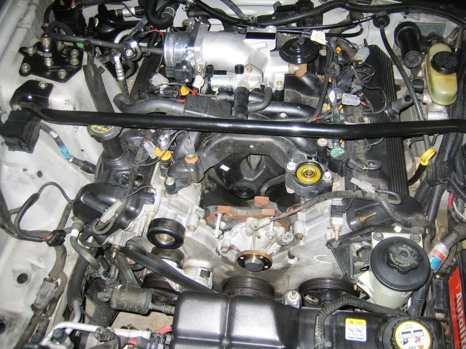

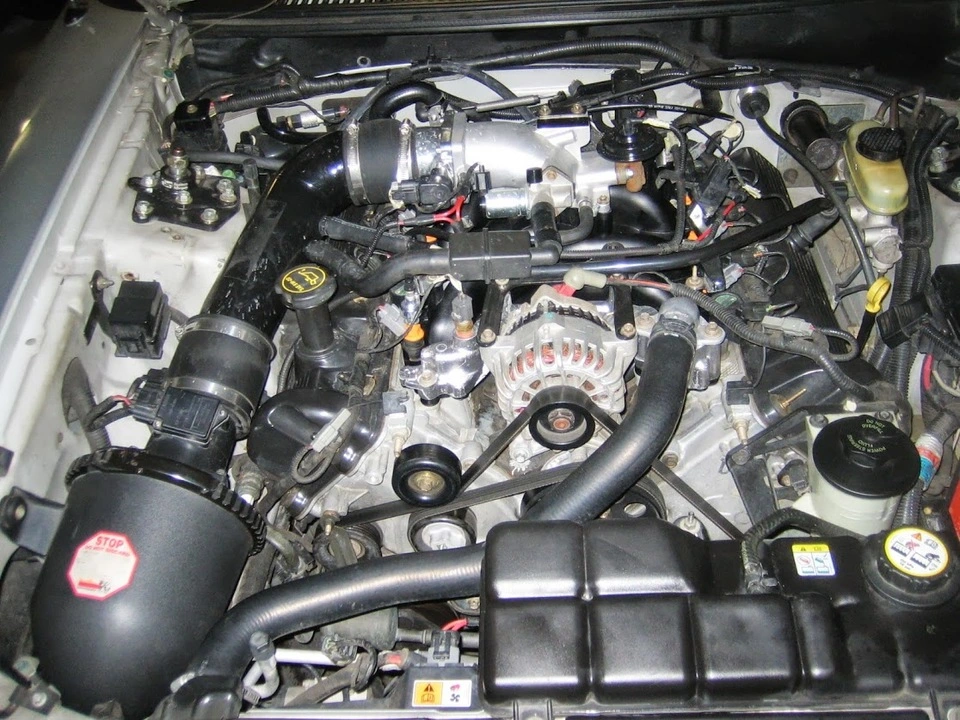

So far I've pulled off:
  • Intake pipe
  • Coolant hose
  • Vacuum lines
  • Water pump pulley (needed to since it was in the way of the alternator bolt)
  • Alternator
More to come tomorrow..

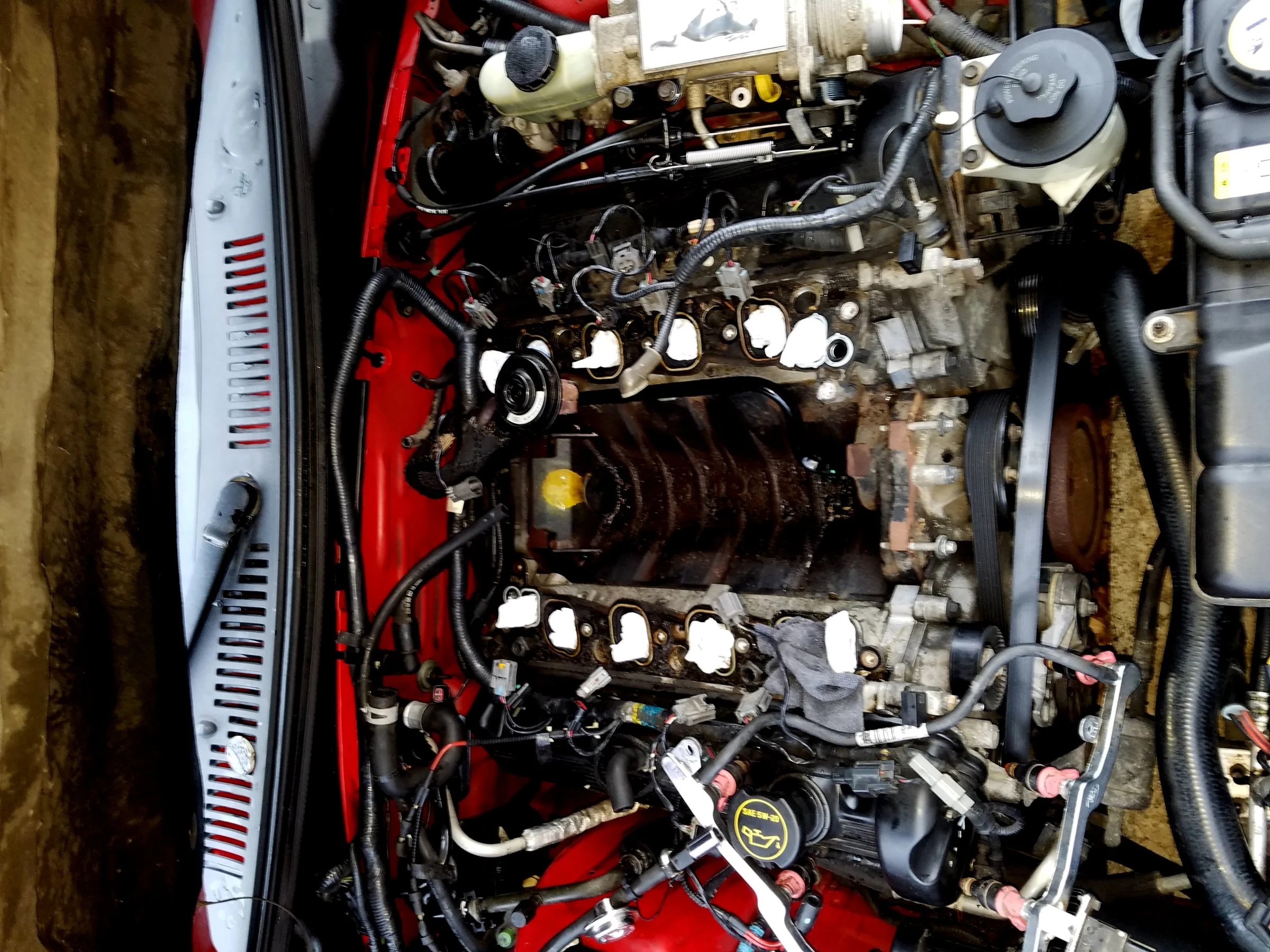

I had just filled up with fuel when mine busted driver side next to the fire wall. _facebook_953399302_.webp _facebook_-1152721314_.webp _facebook_-1505133945_.webp

Almost there, now. Snatch off the COPs, move that strut brace out of the way, disconnect the fuel line, and remove the 11 10-mm bolts on the manifold, and off she goes.
Here's a trick I've discovered after doing this a few times: get a fuel line disconnect tool ($5) and disconnect the fuel rail from the feed line(s) on the rear passenger side. Pull the manifold out with the injectors and fuel rails still on. The injectors are easier to remove and make a lot less mess when done outside of the engine bay.
Also, with 121k miles, there's a chance you'll tear one or more of the rubber O-rings on the fuel injectors when removing them. If it were me and it had that many miles, I'd replace all of them while I had them out. http://www.oreillyauto.com/site/c/d...54_2402&rpl=1&categoryRedirect=02524&pt=02524 For $10, it's cheap insurance. Replacing them or not, wet them with some WD-40 when re-installing to keep them from tearing.
Thanks for the tips. I'm going to try to pull out the manifold without moving the STB (we'll see if that's possible).
I need the 1/2" fuel line disconnect tool right? I hear they come in packs of 4 and at least 1 of them will work.
I'll definitely go with new O'rings too and use WD-40. Thanks again!

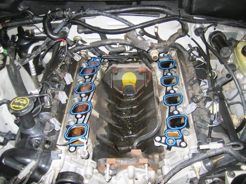

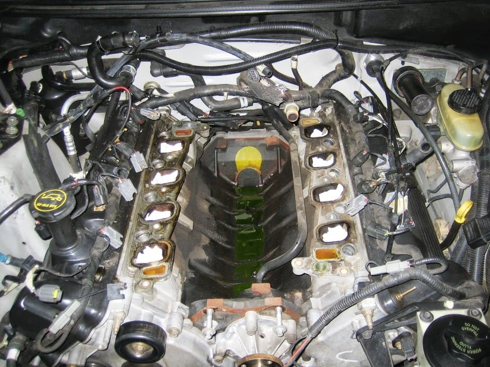

Here's one after the intake manifold was removed
And with the Trick Flow gaskets in place..

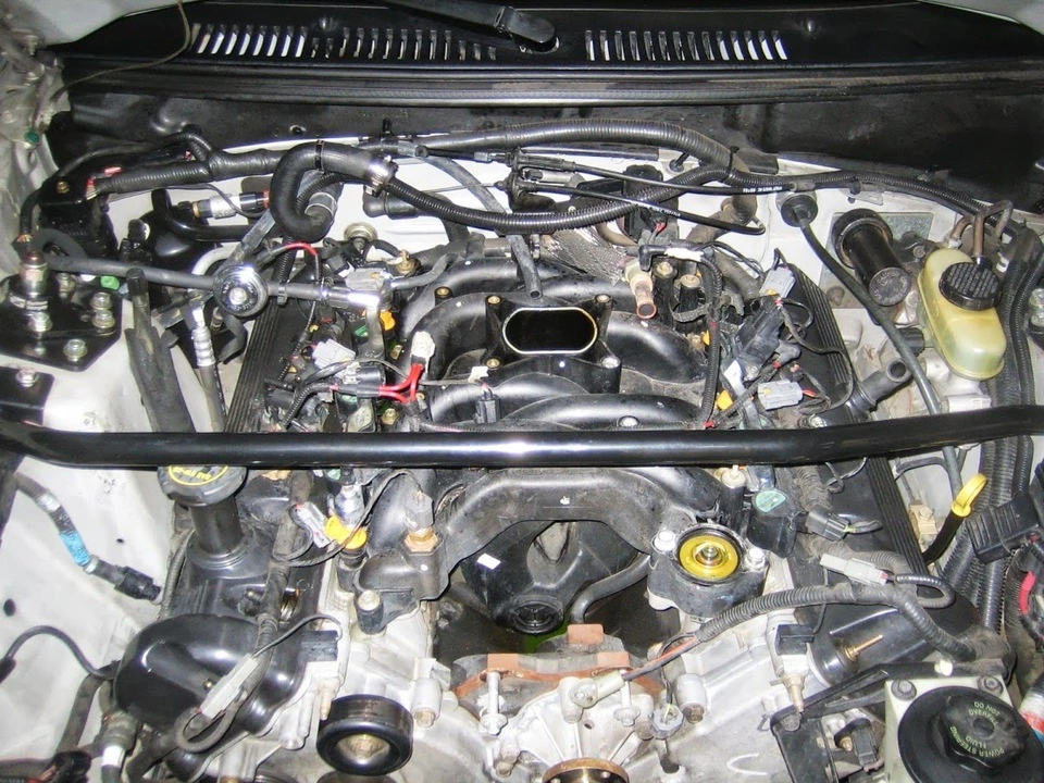

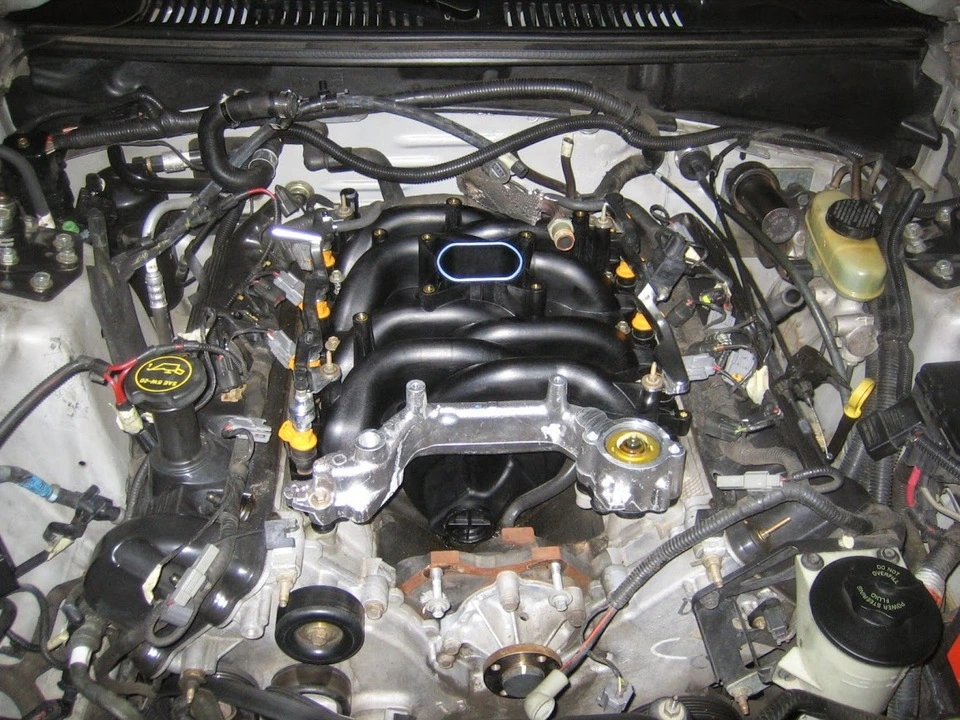

And with the new Ford Racing part and fuel rails in place...

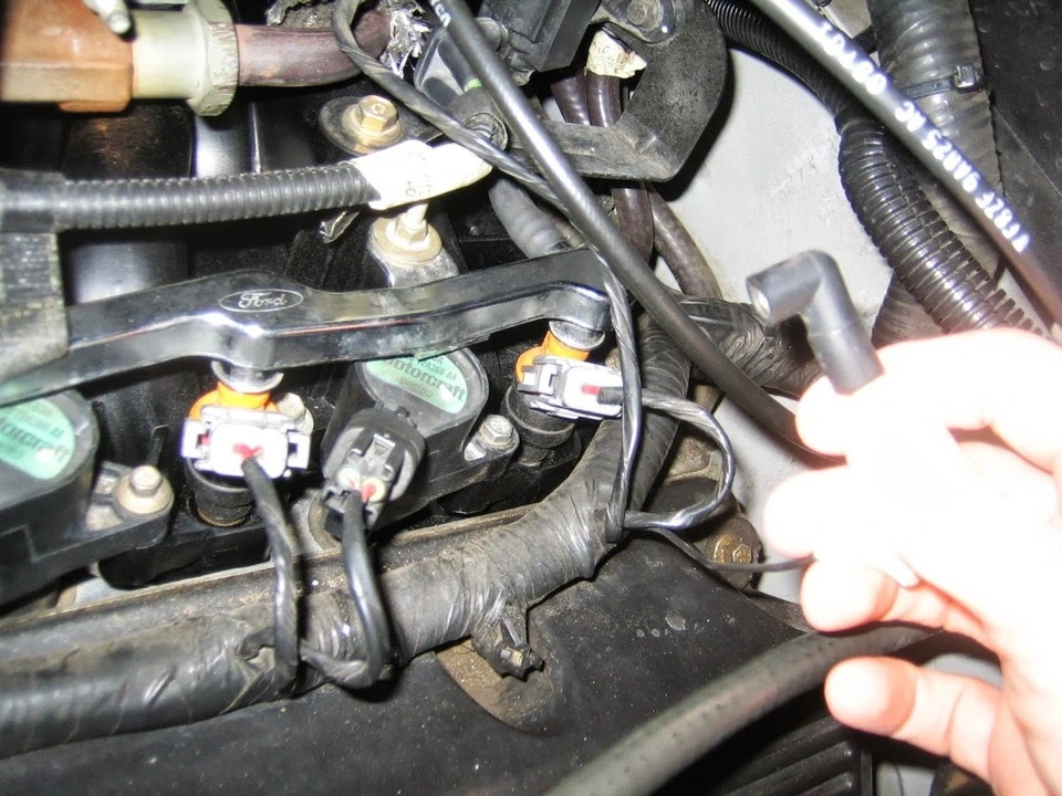

I finished the project and ended up with one "stranded" sensor coming off the harness on the driver's side by the firewall, one of those pinhole little ones.. I'll take a pic tomorrow to see if anyone can pinpoint what I missed.
Otherwise, on first start up, I experienced rough idle, shut it down, unplugged and re-plugged in all of the COP harnesses and injector harnesses, and 2nd start up sounded good. We'll see how she does on the way to work tomorrow.

With the car off, try unplugging and reattaching the injector harnesses and coil pack harnesses (looking for a nice click/secure feeling). Then start it up again. Let us know if that fixes it. Those harnesses can be sensitive.
