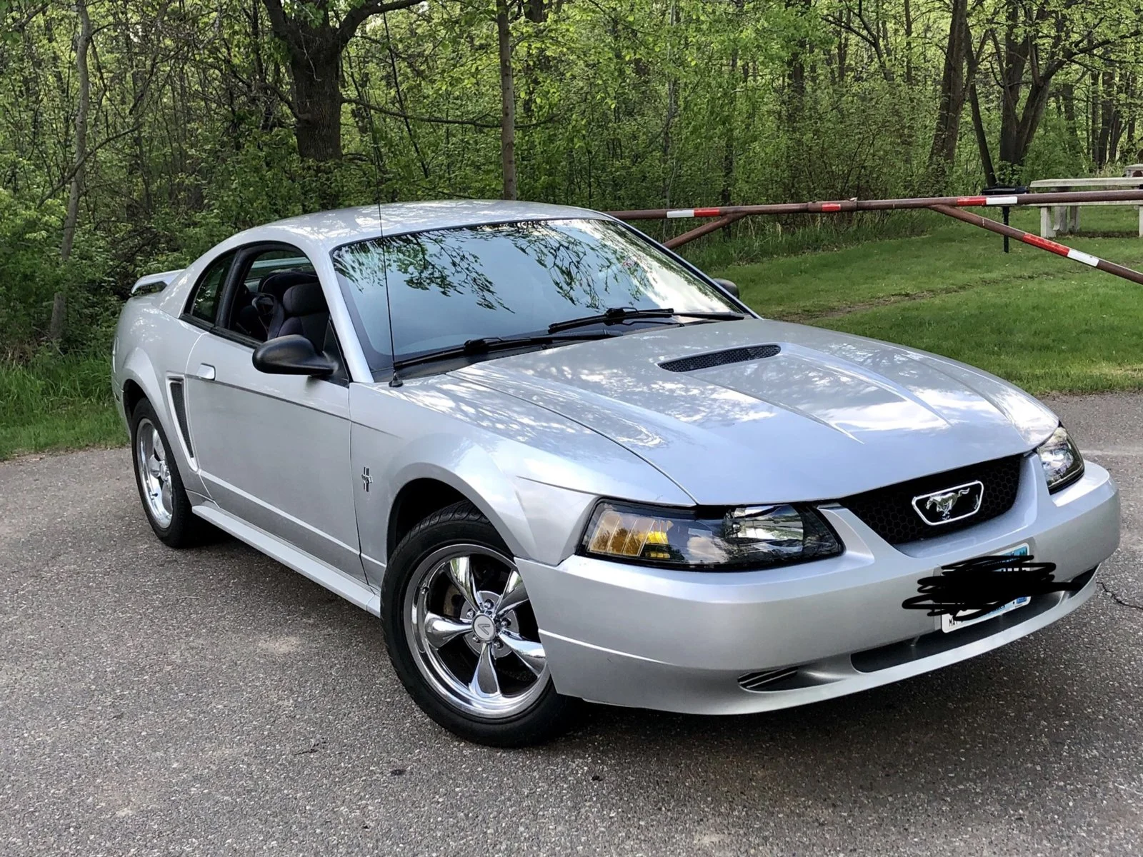

Here’s a pic of the Stang for those who want to see:

Sharp mustang btw!

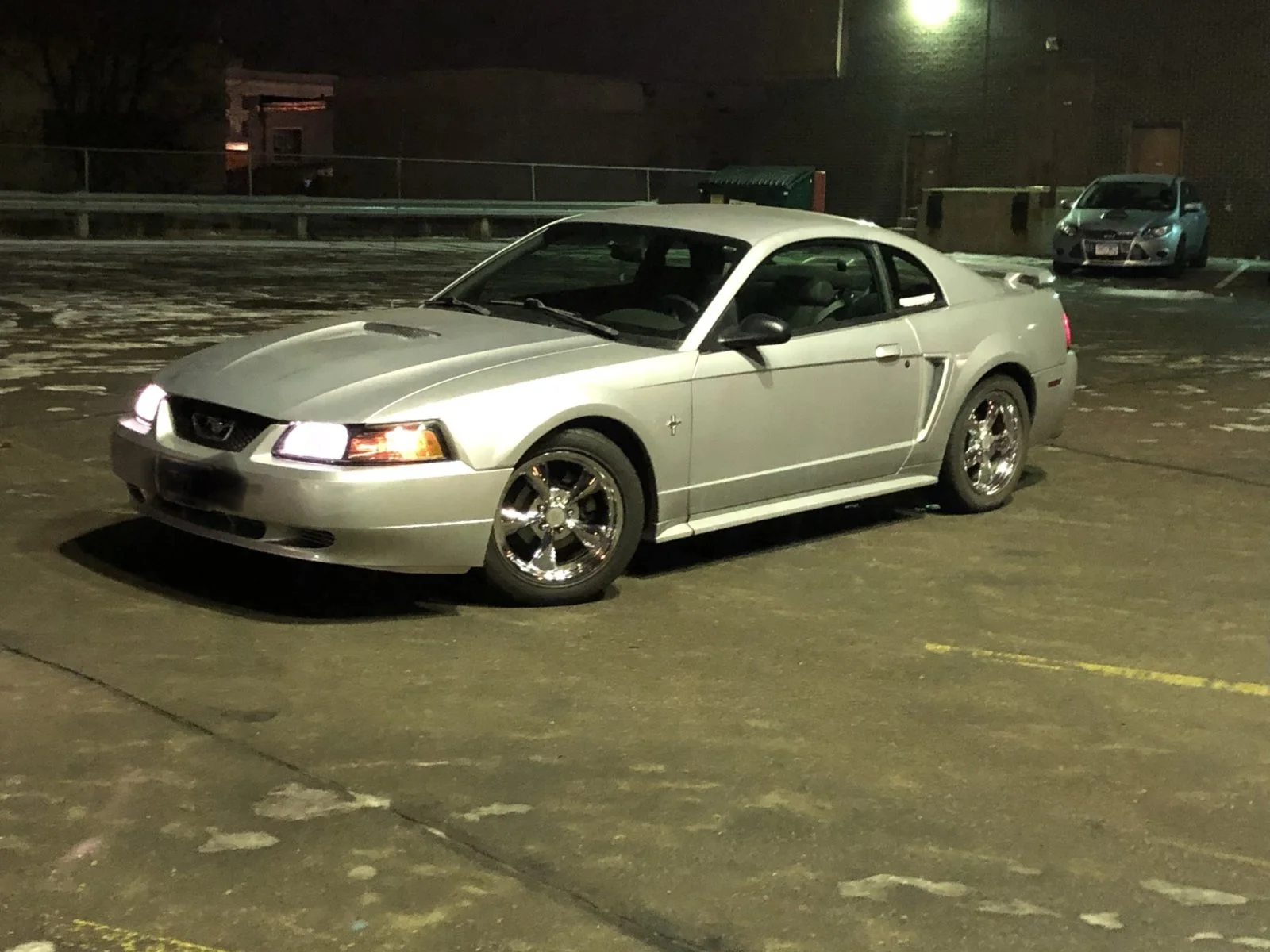

Glad you liked the photo here’s another for ya
