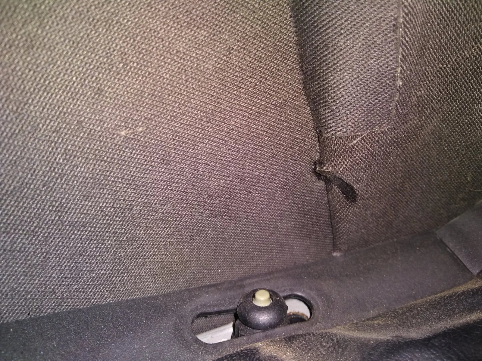

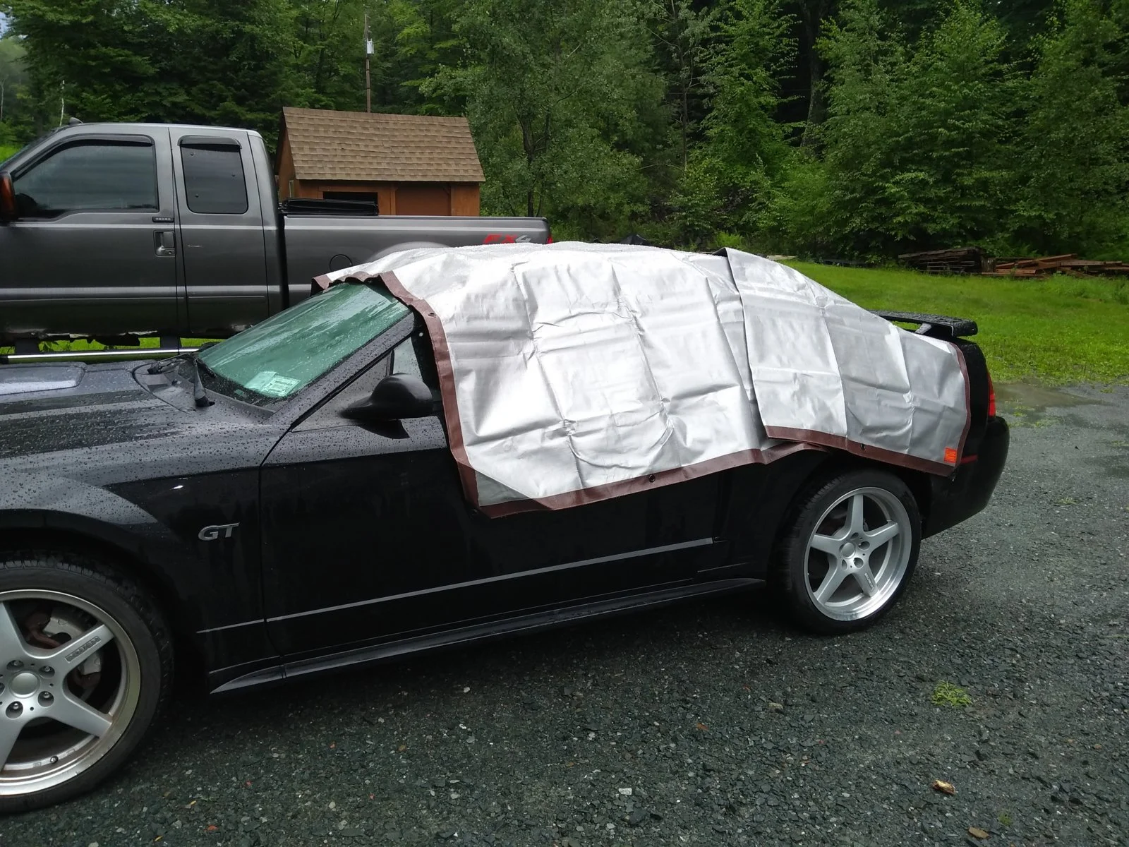

Well it rained like a bugger last night so of course when I get out to the car this morning the floor is wet again. Driving down the road I heard sloshing back and forth (see picture 1). The little vinyl beauty cover is just holding water until it reaches those 2"x2" access panels and is dumping onto the passenger side.

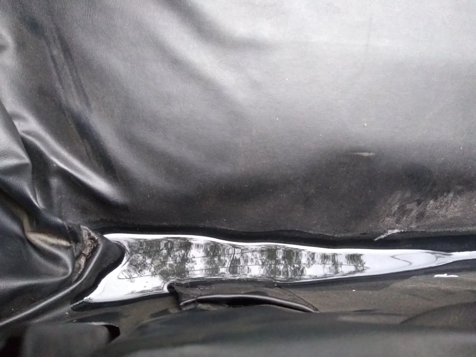

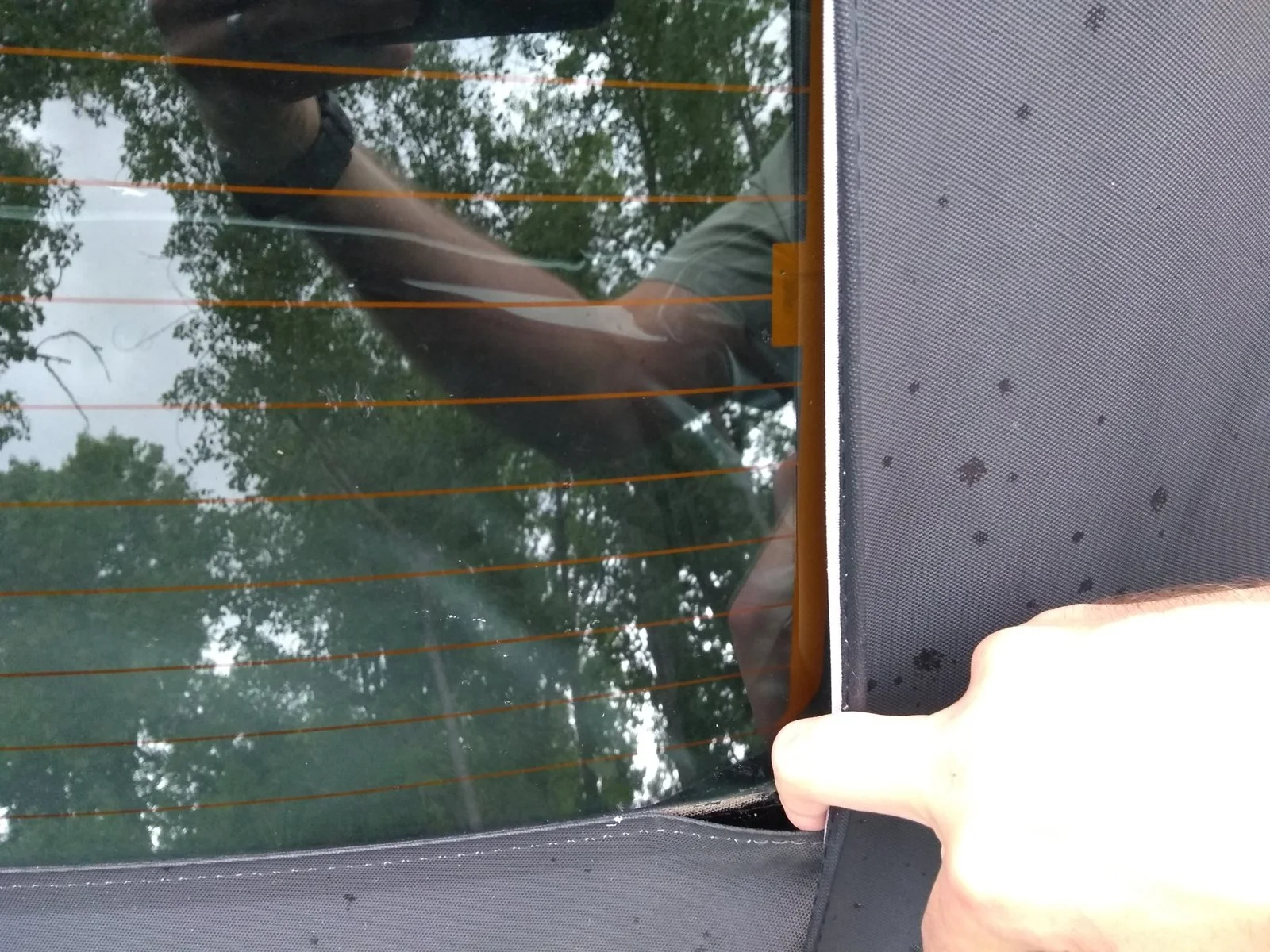

I thought I could see water dribbling in from what looked like the area in picture 2, but that was only looking back quick at a stop sign. I took that pic on my lunch break and that area looks pretty dry right now?

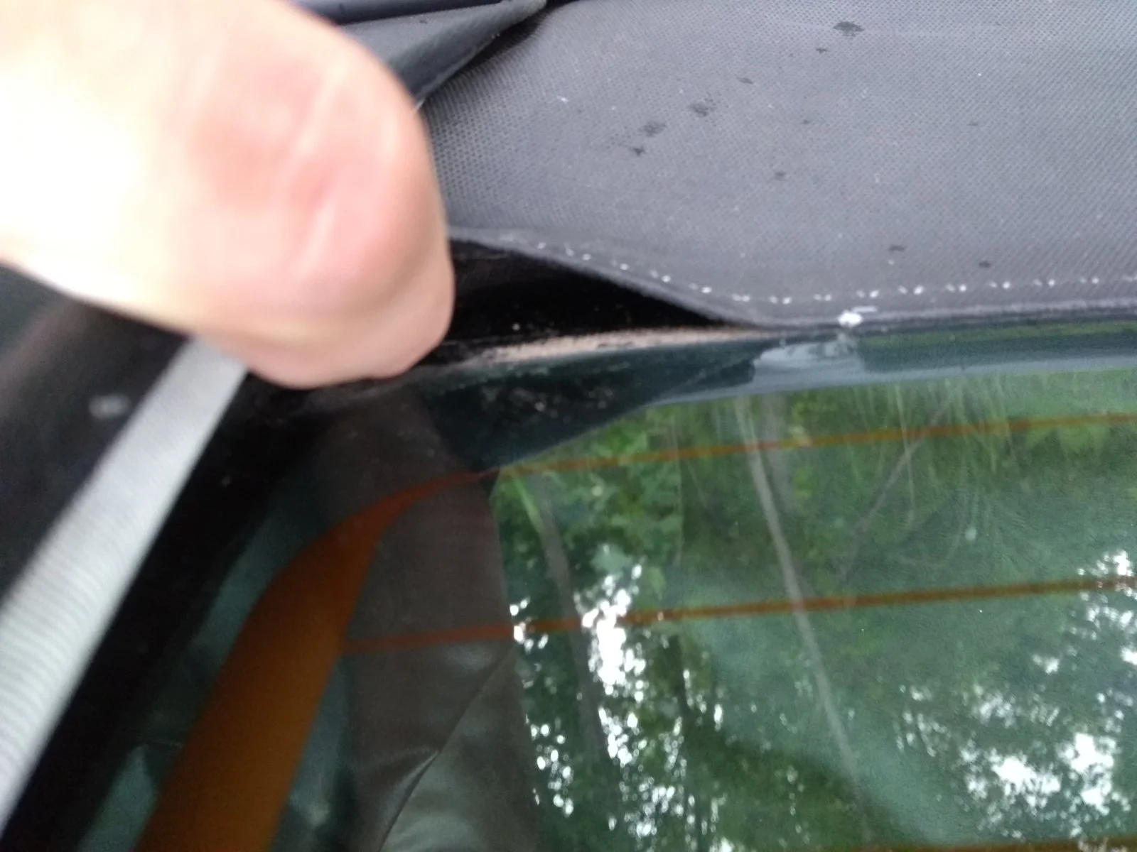

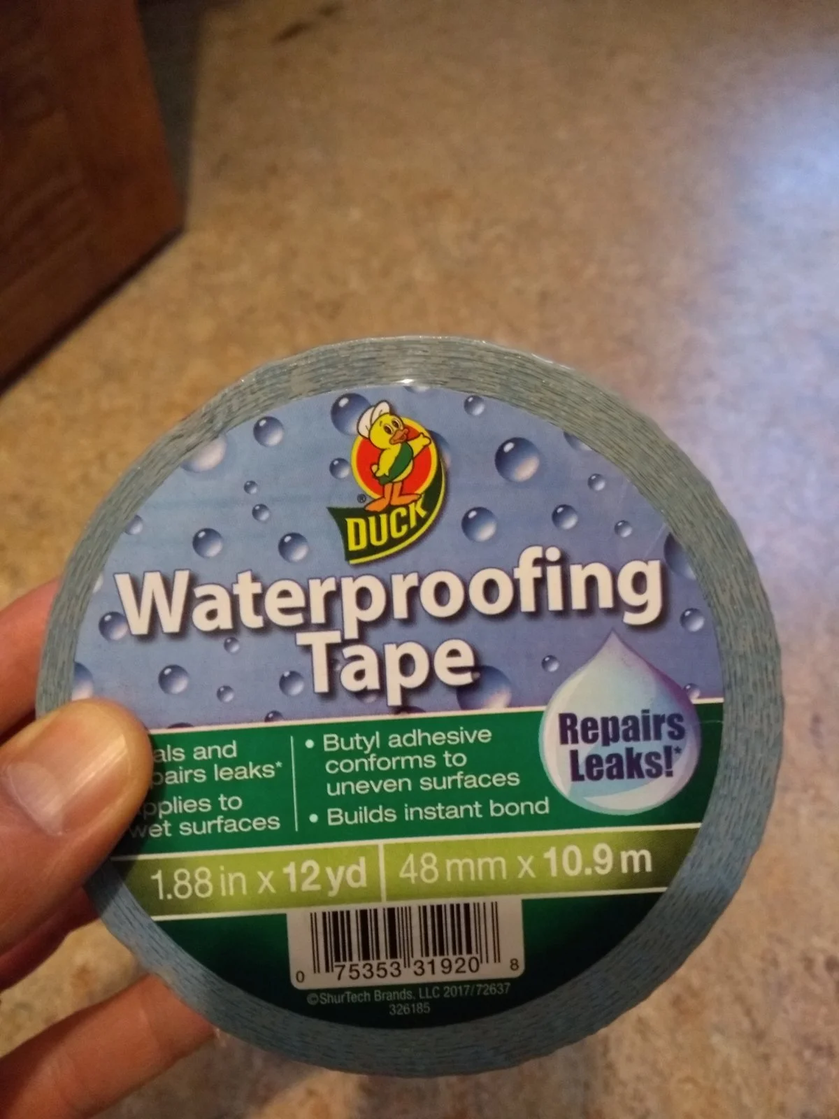

So I started looking at the outside and some of the vinyl is separating from the glass window as you can see in pictures 3 and 4. Is this the problem? I know the vinyl is supposed to be glued to the glass, but as you get underneath that flap on the right side of picture 3 it doesn't look like that later of vinyl was ever actually glued to the lower later of vinyl? I ask because if that's the case, all of that water should just go into the channel and out the drains in the quarter panels. Picture 4 shows the view from top down.I'll seal up the seams in the floor pan with the tape, but I'd love to stop somewhere on my way home from work and get something sealant to stop where the water is coming from in the first place.

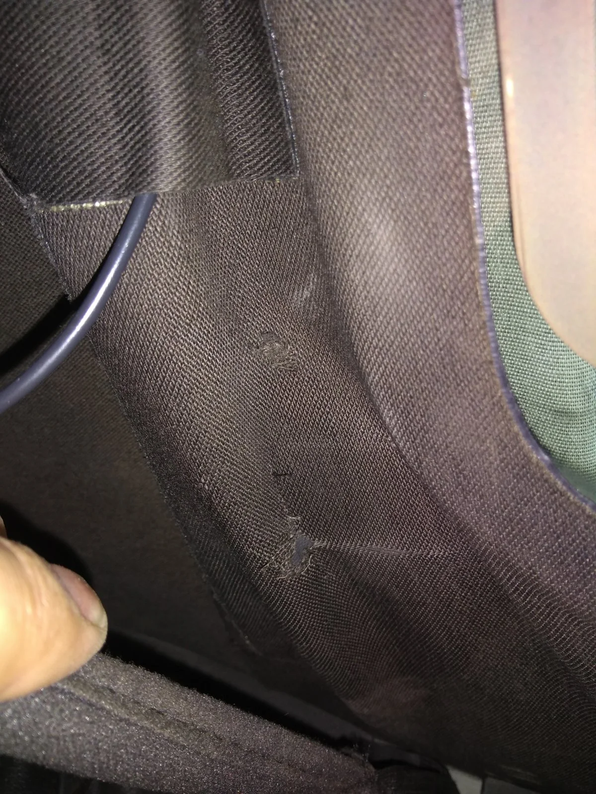

Aight, we're getting a little warmer here now. There is what appears to be a pea sized hole hidden near the area of picture 2 above. It stopped raining an hour or two before my lunch break so by the time I went out to take the picture it was dry. Apparently the fabric dries relatively quickly when you're trying to document a leak :rolleyes: but if you look very closely at the new picture I've attached you can see a little dark spot. I took that while I was parked and it was raining lightly. As the rain increased it became a steady stream. Once I started driving down the road it was a freaking river pouring into the beauty cover. I picked up some "E6000" at home Depot after reading a number of Miata and S2000 guys had good luck with it, just need it to dry out/stop raining. It's supposed to rain until Sunday morning here and I have my cousin's funeral tomorrow so until then this is how she sits.

Just continuing the blog here...I coated the wear hole in a good layer of the E6000 yesterday morning and it baked in the hot sun all day. I threw on another coat tonight as they are calling for more thunderstorms around :mad:

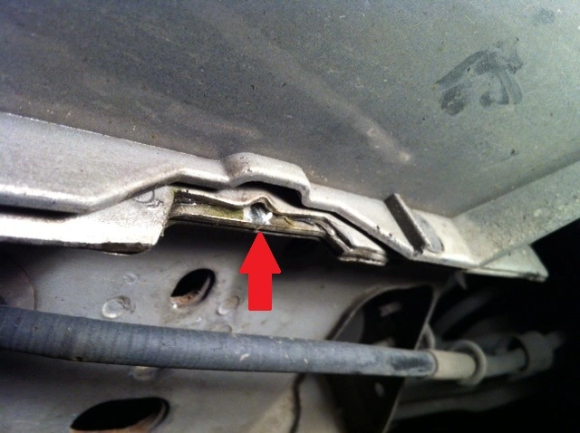

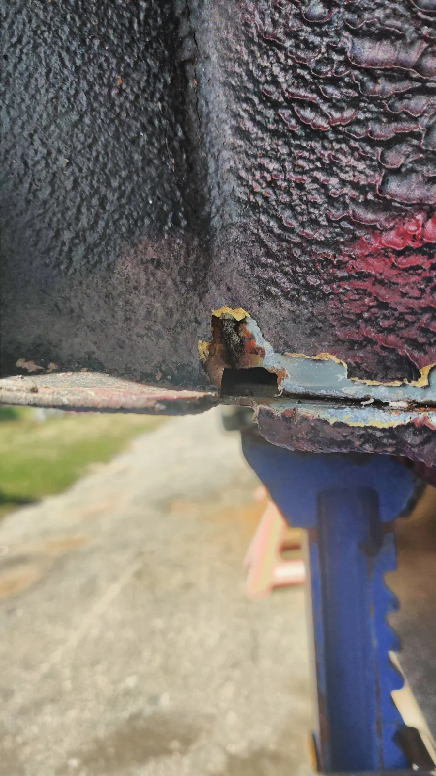

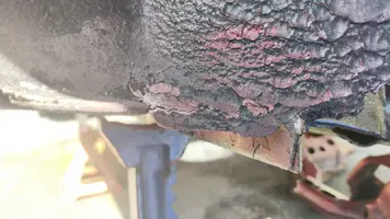

I know this thread is a little old but.... I found an alternate resolution. The back of the water channel where it meets the wheel well has an opening that is usually plugged up with seam sealer from the factory. Those reliefs in the pinch weld just aren't enough and sealing the floor pan is a bandaid that just allows the water level in the channel to get higher. If you remove the seam sealer at the bottom and reveal the hole chances are the floors will never get wet because that channel will never hold enough water. After testing with a hose lots of nasty stuff that would normally block up those smaller reliefs/holes in the pinch weld started coming out thru the back. Hope this helps someone. Chances are that extra seam sealer in the wheel well already has cracks in it like in the picture.
what Did you remove to get at the sealer to open it up in the pic? the rear inner wheel plastic? take off the ground effect? I have an 03 vert gt, not far fropm you on cape cod. 2 years old thread just found....
