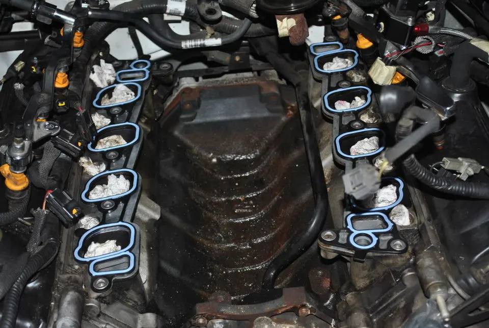

A new intake is about $190 plus shipping. Summit Racing and a host of other Mustang shops keep them in stock. ONLY replace it with a Ford Racing Performance Parts (FRPP) intake and Ford gaskets.
