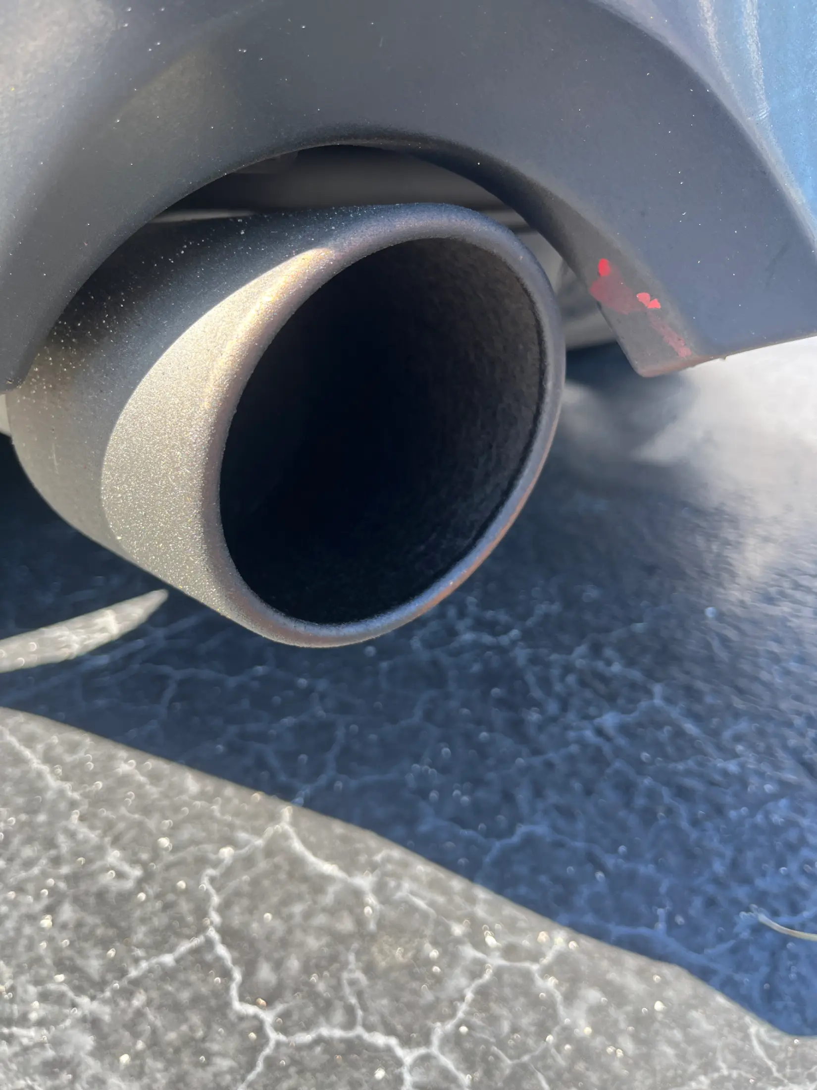

Hi i have a 2002 gt 4.6L and currently its smoking when idling or any type of gas while driving even. Ive been told its my valve seals could be a cylinder i dont know what it could be? Note the motor is most likely the original from years ago so just to throw that out there. Ive done new ac compressor,motorcraft ignition coils,sparkplugs,iac restrictor plate, and recently a new water pump. On the exhaust tips theres like a residue on the tips looks like oil but im told could be carbon build ups. But it has gotten worse hopefully the people on here can help me figure out this problem!

Definitely blueish white nowhere near black n i have a full catback exhaust havent touched anything on them yet.
