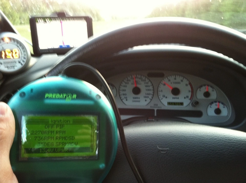

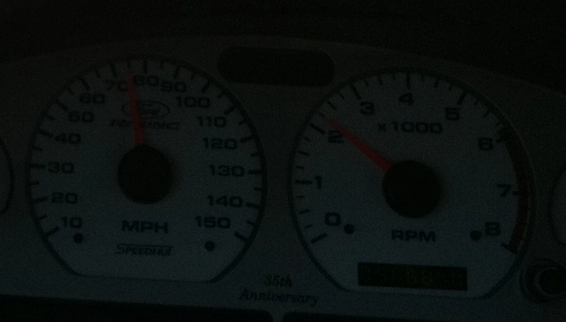

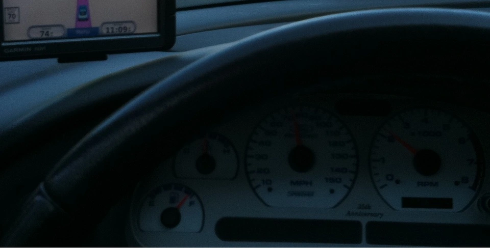

Here ya go. Found these from a recent road trip. Doesn't get more exact than that. Only around 75mph though. With ~2,300 RPMs @ 75mph, I don't think the other speeds really matter :)
