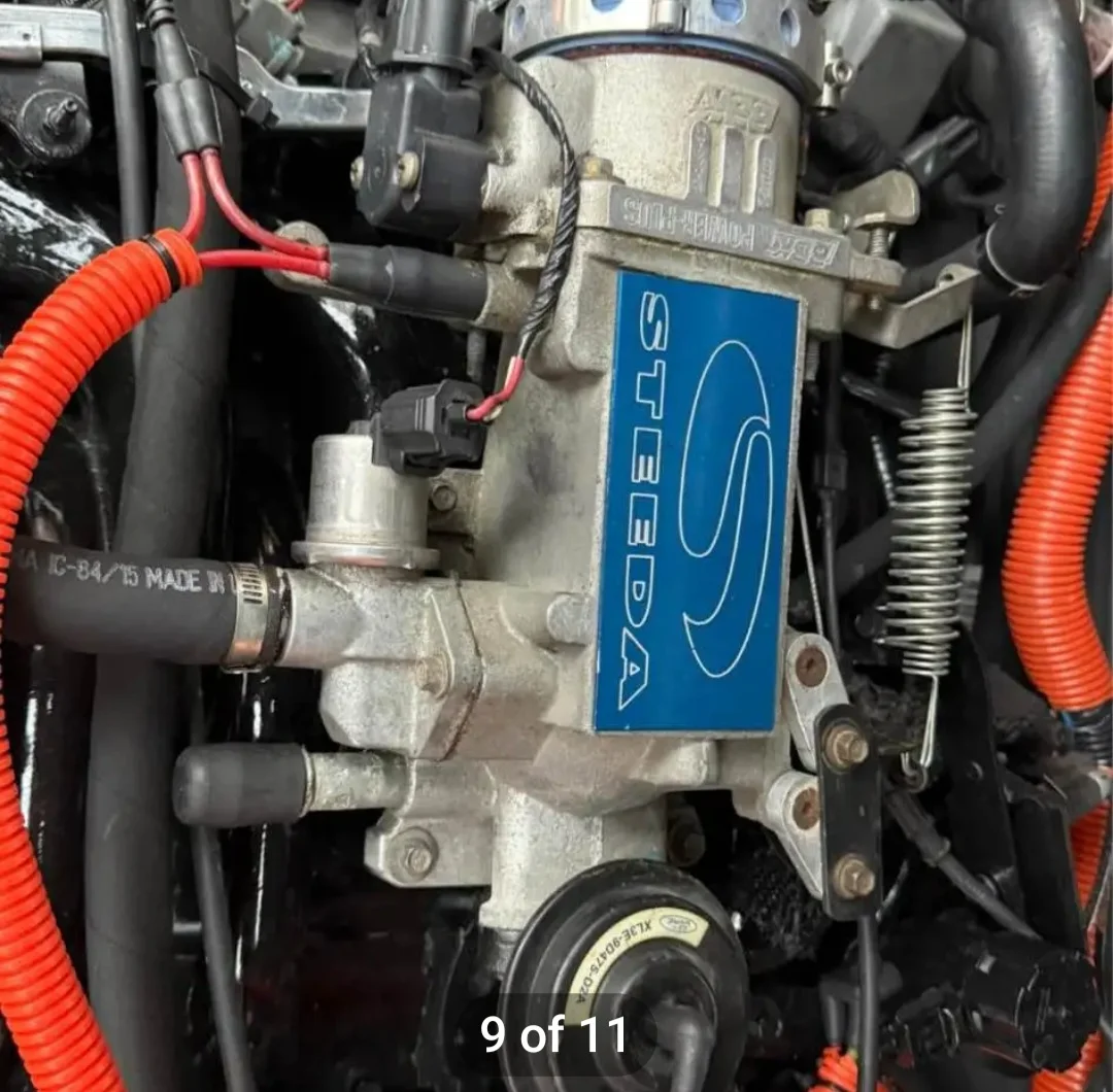

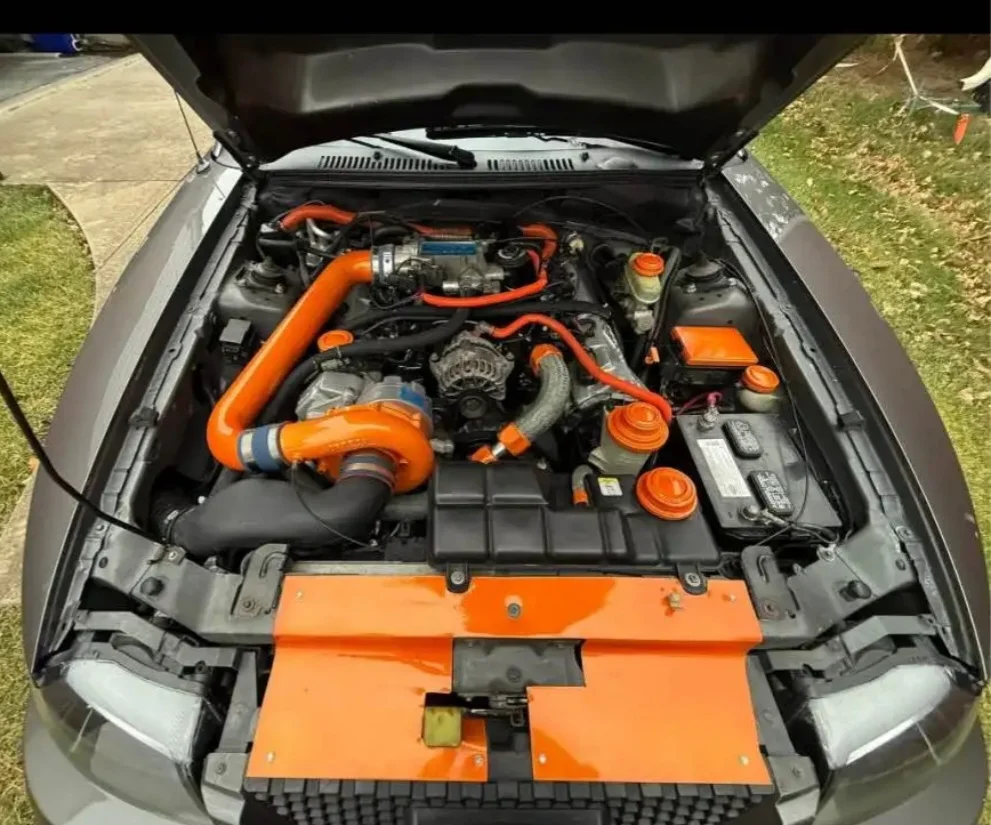

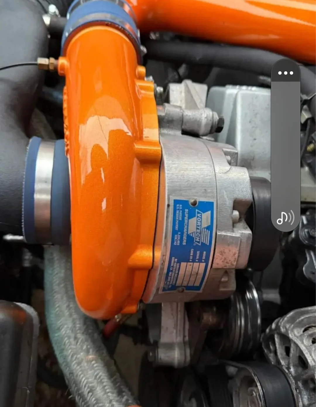

2003 mustang gt 4.6
Am note really shore i bought the car with the procharger on it .. it does have bbk throttle body bbk headers pretty much bbk everything

Ok I found out today that my 03 mustang gt with a v2 vortech procharger.... I took it to a tuner and they found out my computer is locked with a sct tune and the hand held tuner box does not work and to make things worse is who ever had all the work done to this mustang my tuner guy found out they stuck a 07 computer in it and it can't be tuned with that in there he said I would need the stock computer in it ... where would be the best place to obtain one and how would I know if I am getting the factory computer ??
