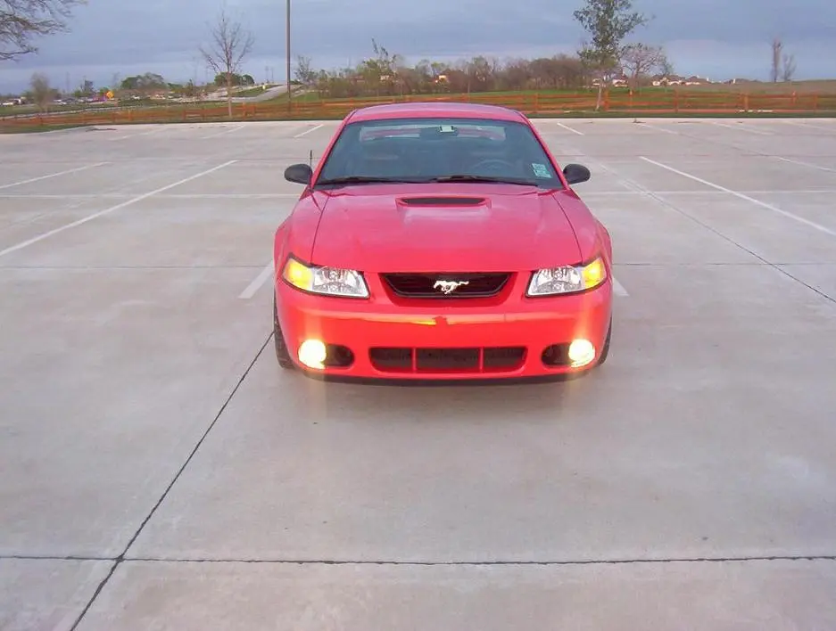

jezzi55 said:
I got into an accident and front ended my car recently. I went to the body shop and got them to do the job for me. I believe the bumper came from the local dealership non-painted. I believe the bumper itself was cheaper than the OEM GT bumper but I had to pay extra for harness for the foglights and floglights itself, and also the plastic piece for the chin add-on.
My experience exactly in putting on my 03 bumper. Looks much more aggressive.
