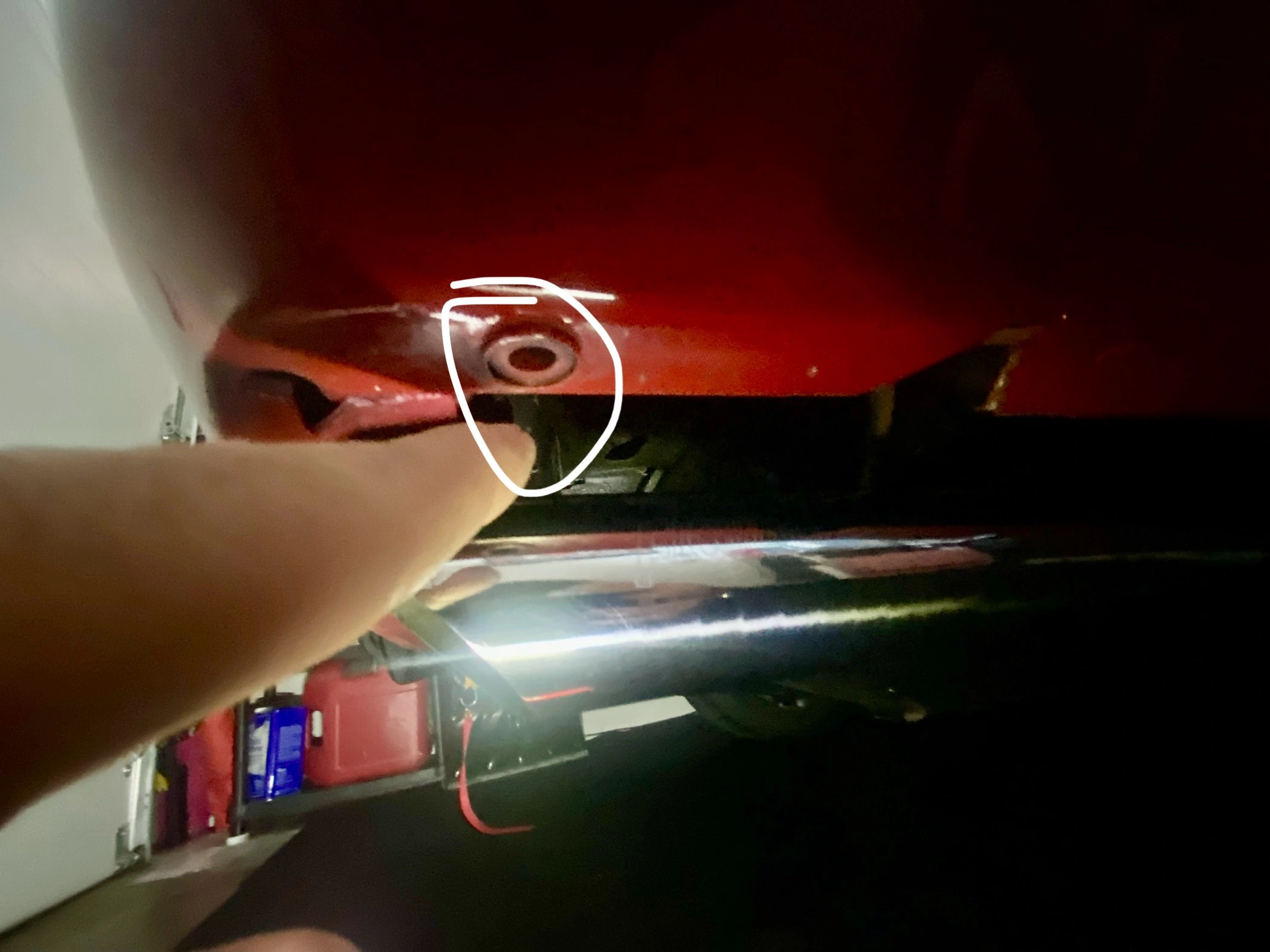

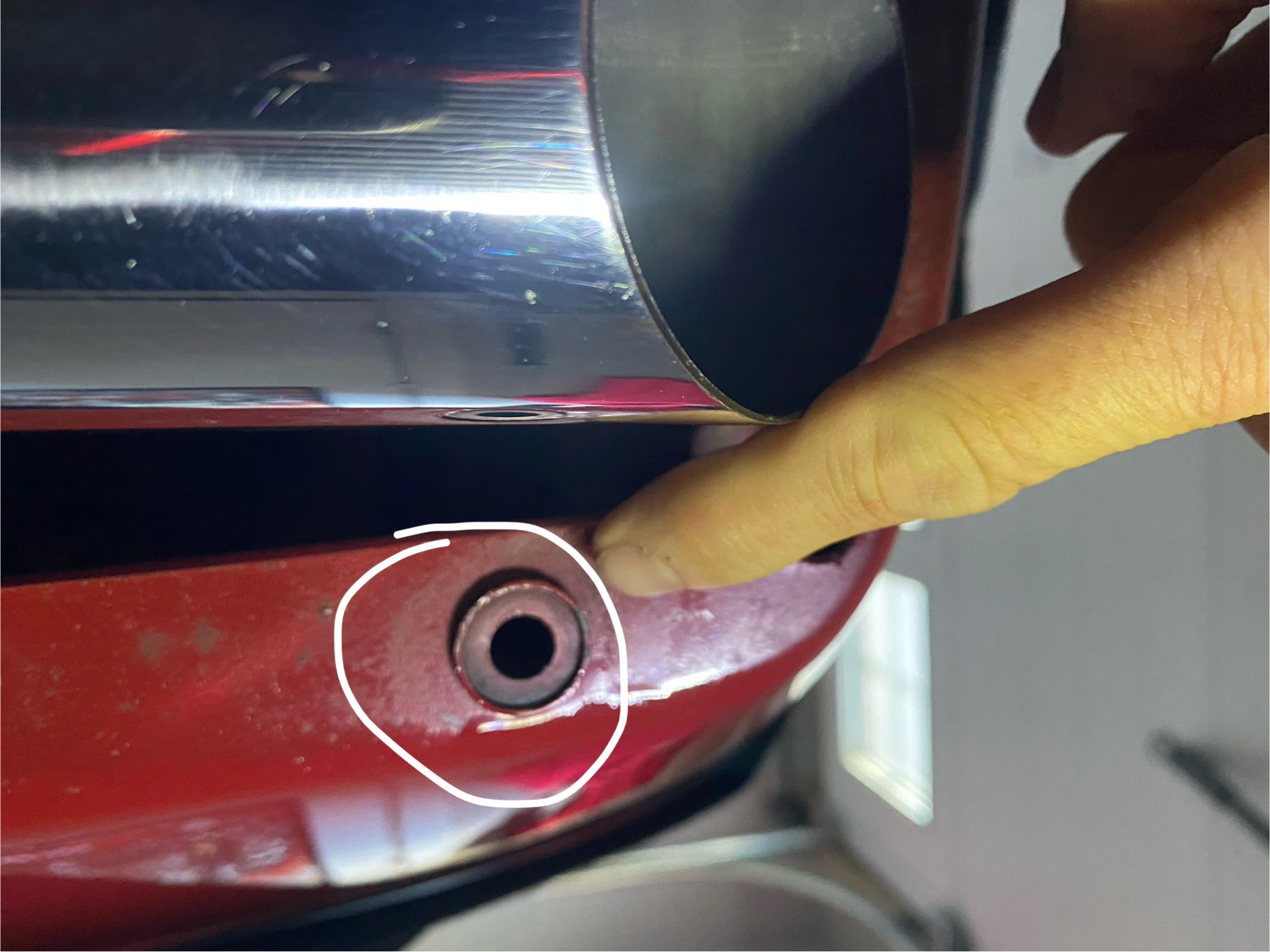

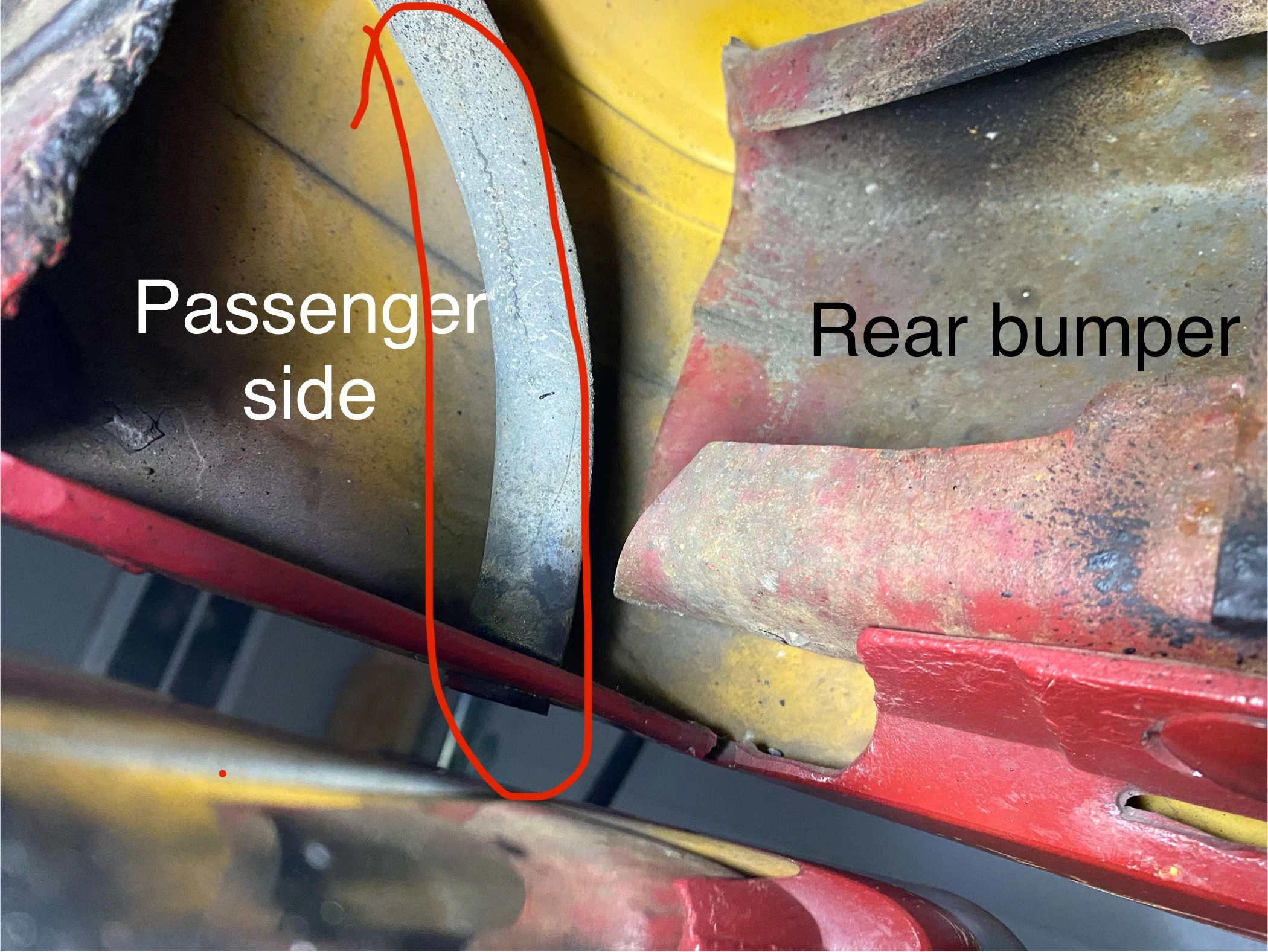

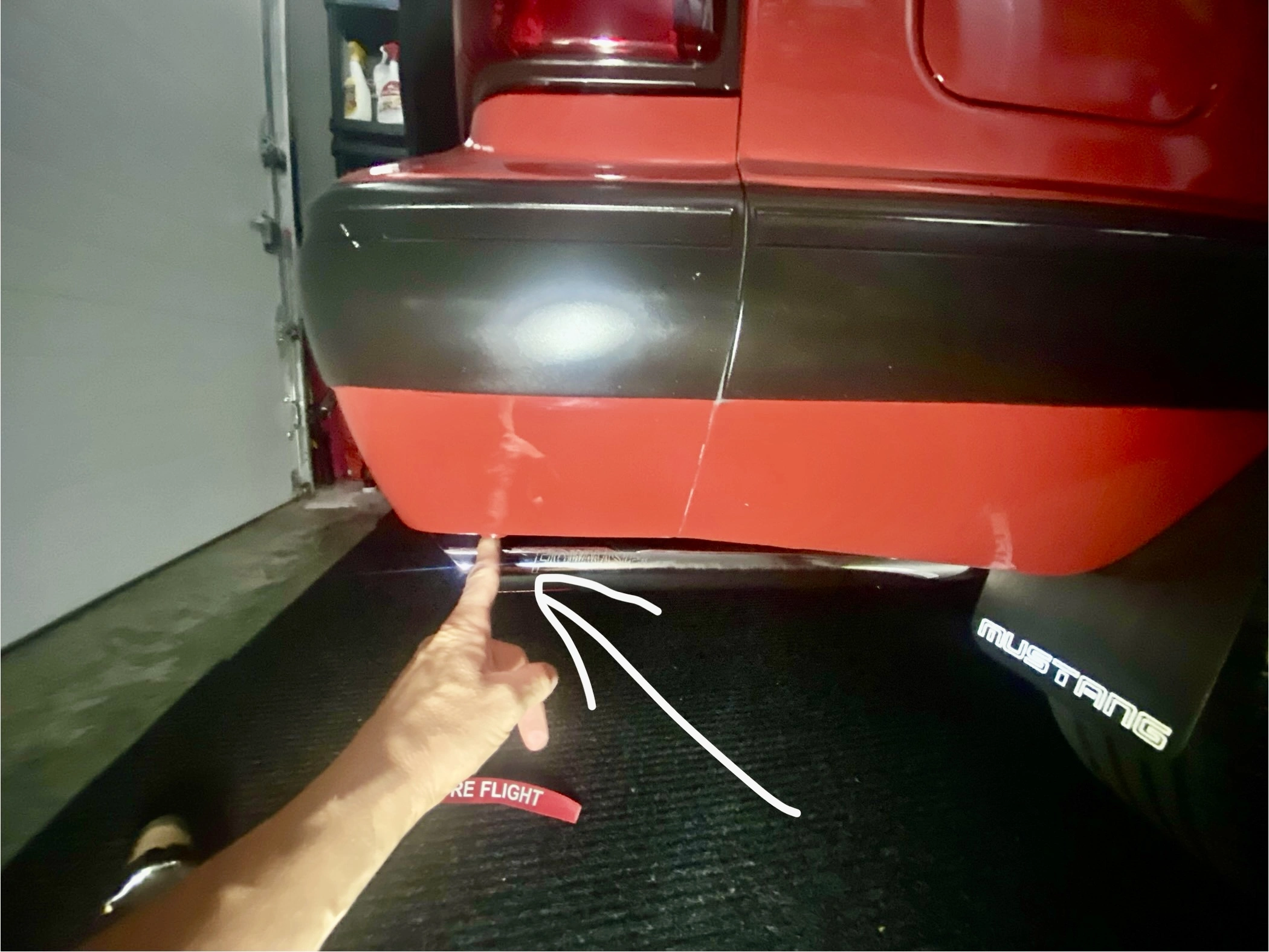

I took pictures for you. Hopefully it’s helpful.
The tube comes down the rear passenger side as you know. It goes into a grommet that’s underneath the side of the bumper that has a flat lip. It (tube) doesn’t just hang. If the cobra bumper has that flat area underneath you can make a hole and install a grommet then cut the hose to length if needed and secure it in the grommet. If that makes sense?
See pictures attached…..
