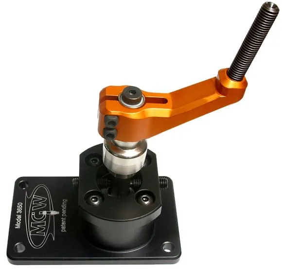

In several previous threads concerning shifters the MGW appears to be the people's favorite. I've had the pleasure of trying one out and it's very nice.

can someone explain how the mgw is better than the triax, i'm kind of interested in one, even though i'm pretty happy with my triax,only thing i've never liked is the slight gear whine u hear with it......
1. Shift handle is placed farther back thus making it easier to find and more comfortable to use.
2. The throws from gear to gear are shorter than either the Tri-ax or the Pro 5.0.
3. The internal mechanics are better and the shifts are easier because of its superior design.
U.M.
No noise
does not look like its in gear at all!!
