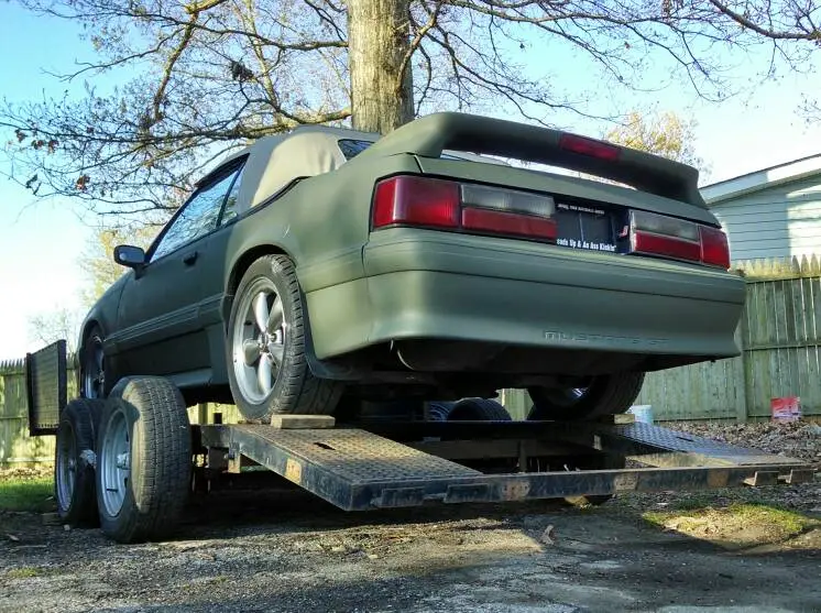

Details on my build here... Bird_dog0347 rescues a Fox - Ford Mustang Forums : Corral.net Mustang Forum and here....

@RacEoHolic330 here... Build Thread - Want To Blow 4 Years And $40k On A Foxbody? Step By Step Instructions Inside! | Mustang Forums at StangNet
