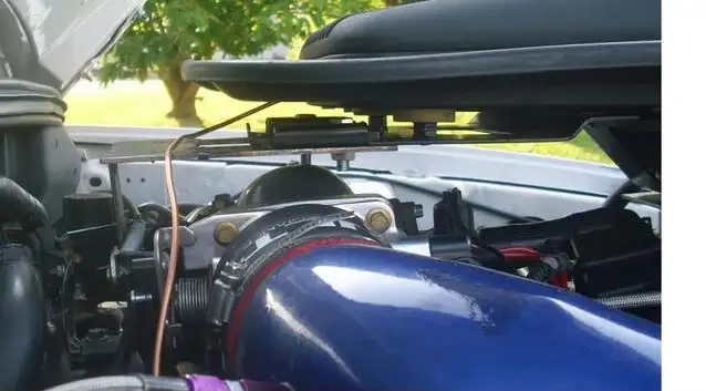

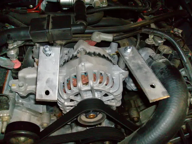

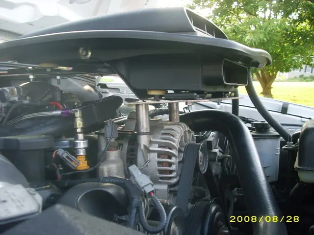

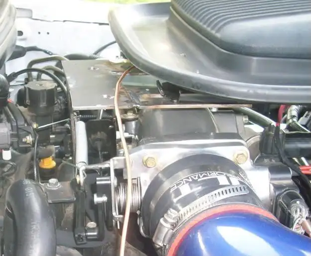

yep i did it. i pm'd the op but i'll post the info here incase anyone is interested.
you're gonna need the big black bracket that holds the shaker to the engine.
i had to make two front brackets to hold the front of the big black bracket.
then i made a bracket for the back. it's pretty simple. these pics are similar to what i did. hope these help
i used the 2 bolts where the throttle cable is attached to the plenum to attach the back bracket.
i think the spacers that i used ontop of the alternator were only like 1" tall instead of 2" like pictured. i don't have the shaker anymore so i can't look at it:(
