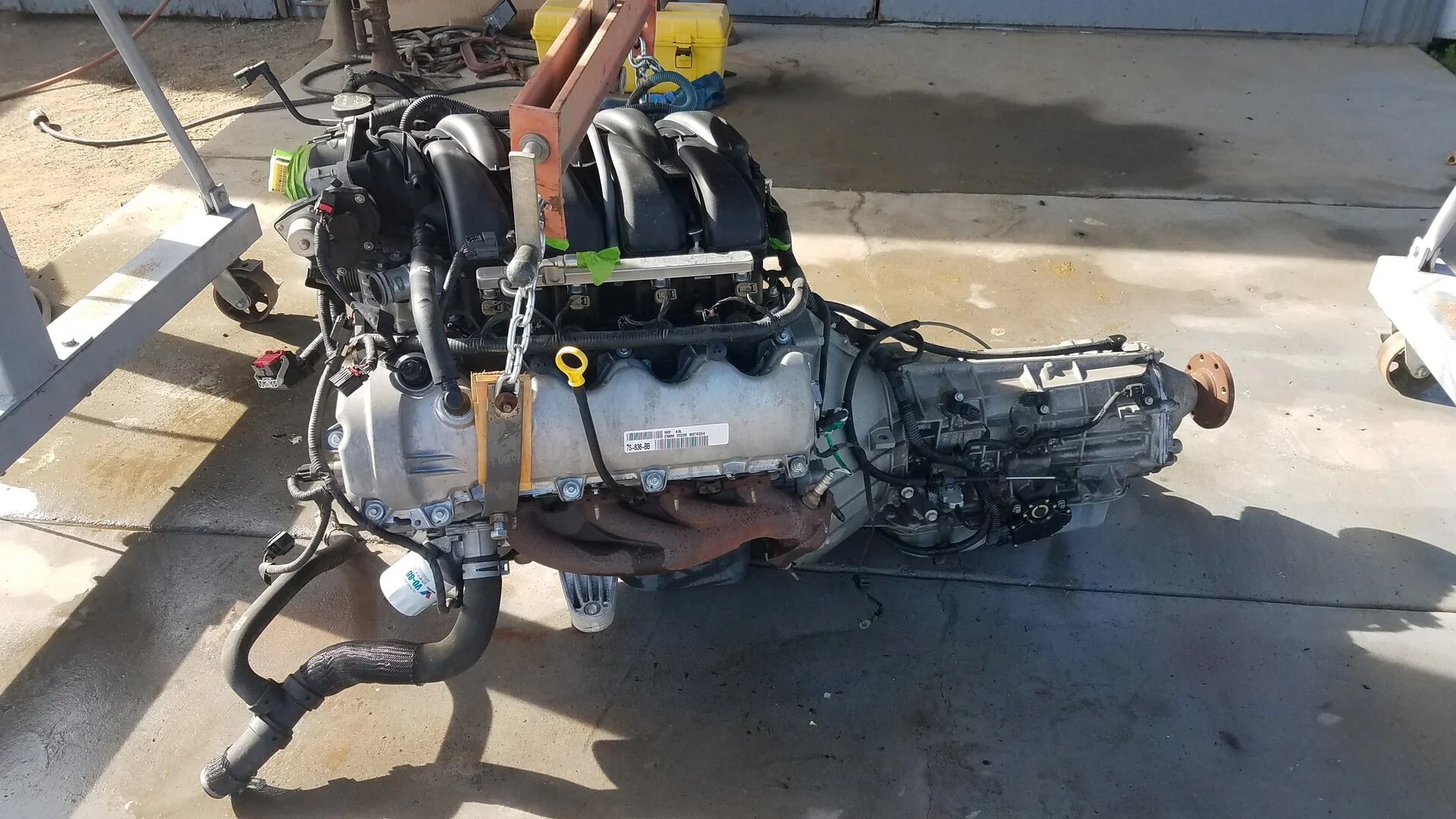

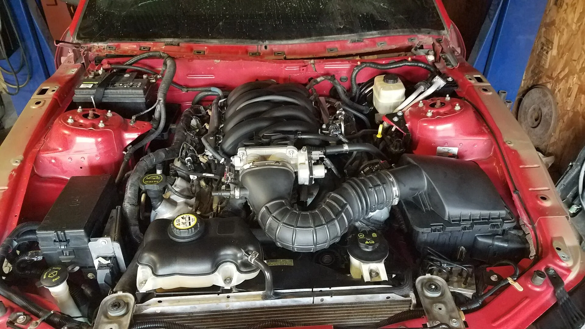

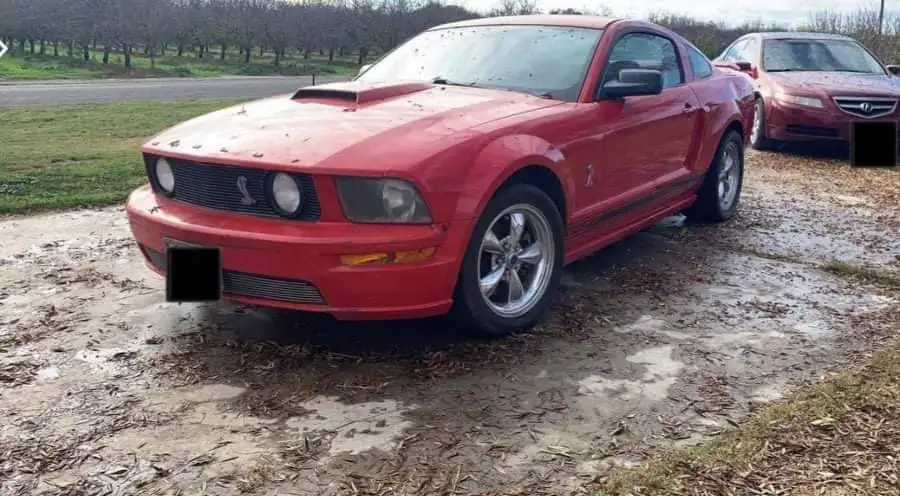

Just picked up a 2005 GT ,the motor is blown . I have a wrecked low mile 2007 GT that i want to pull the motor and drop into the 2005 . My question is ,can i pull the motor and automatic as a unit or am i going to have to split them to get it all out . Motor is the 3 valve and 5 speed auto .

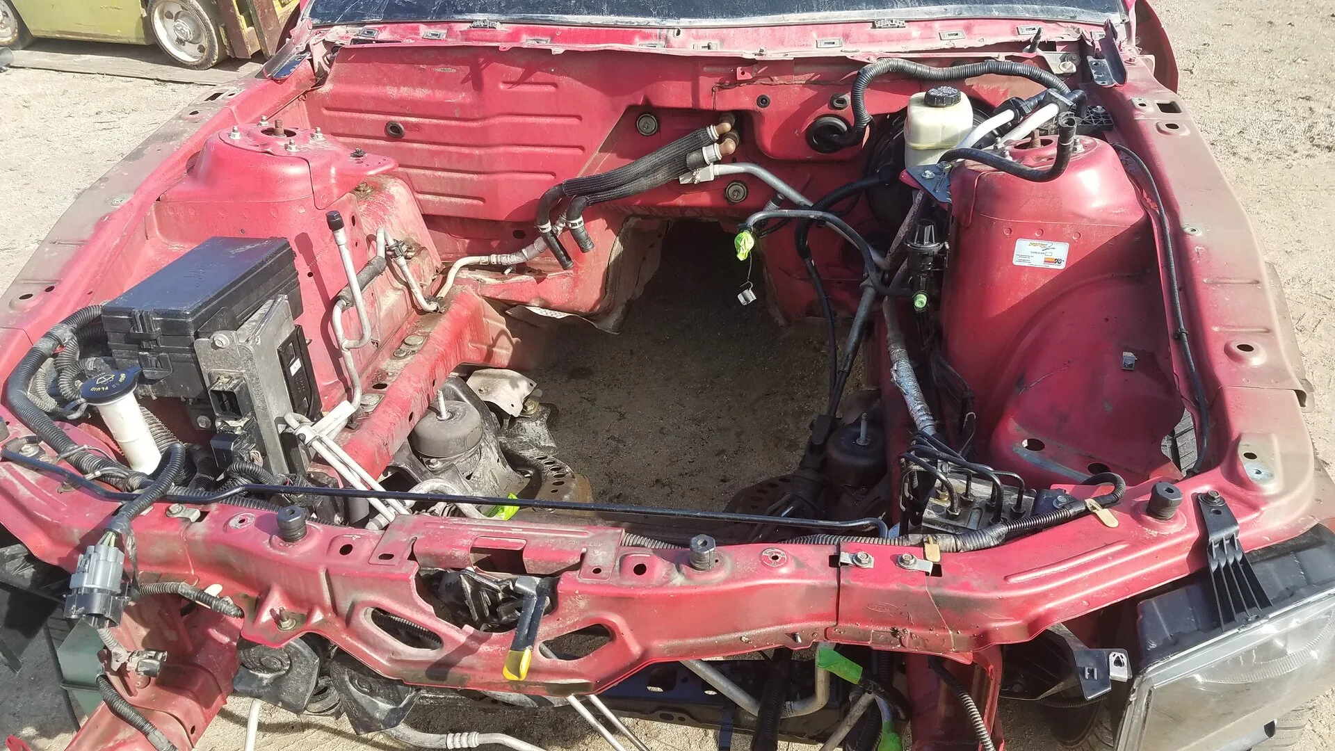

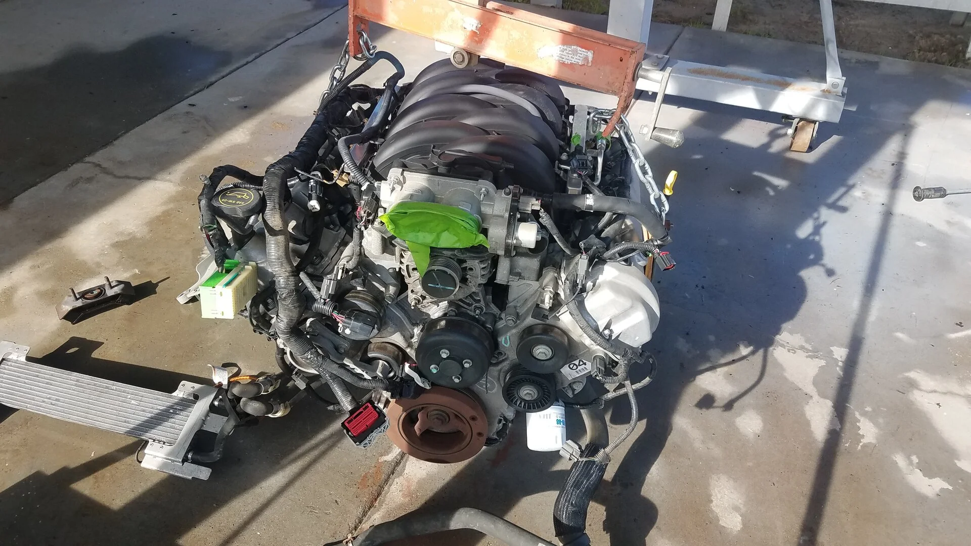

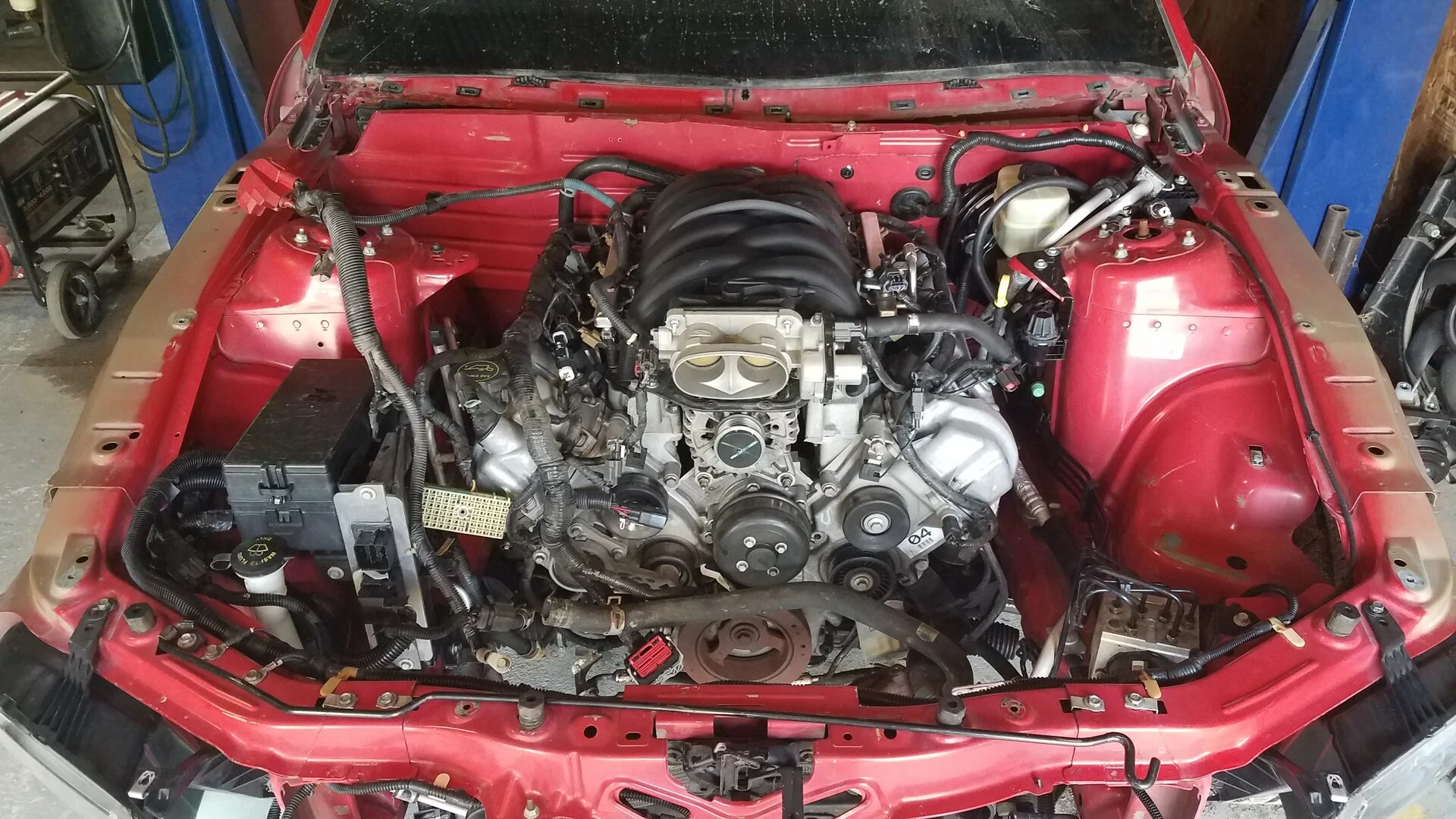

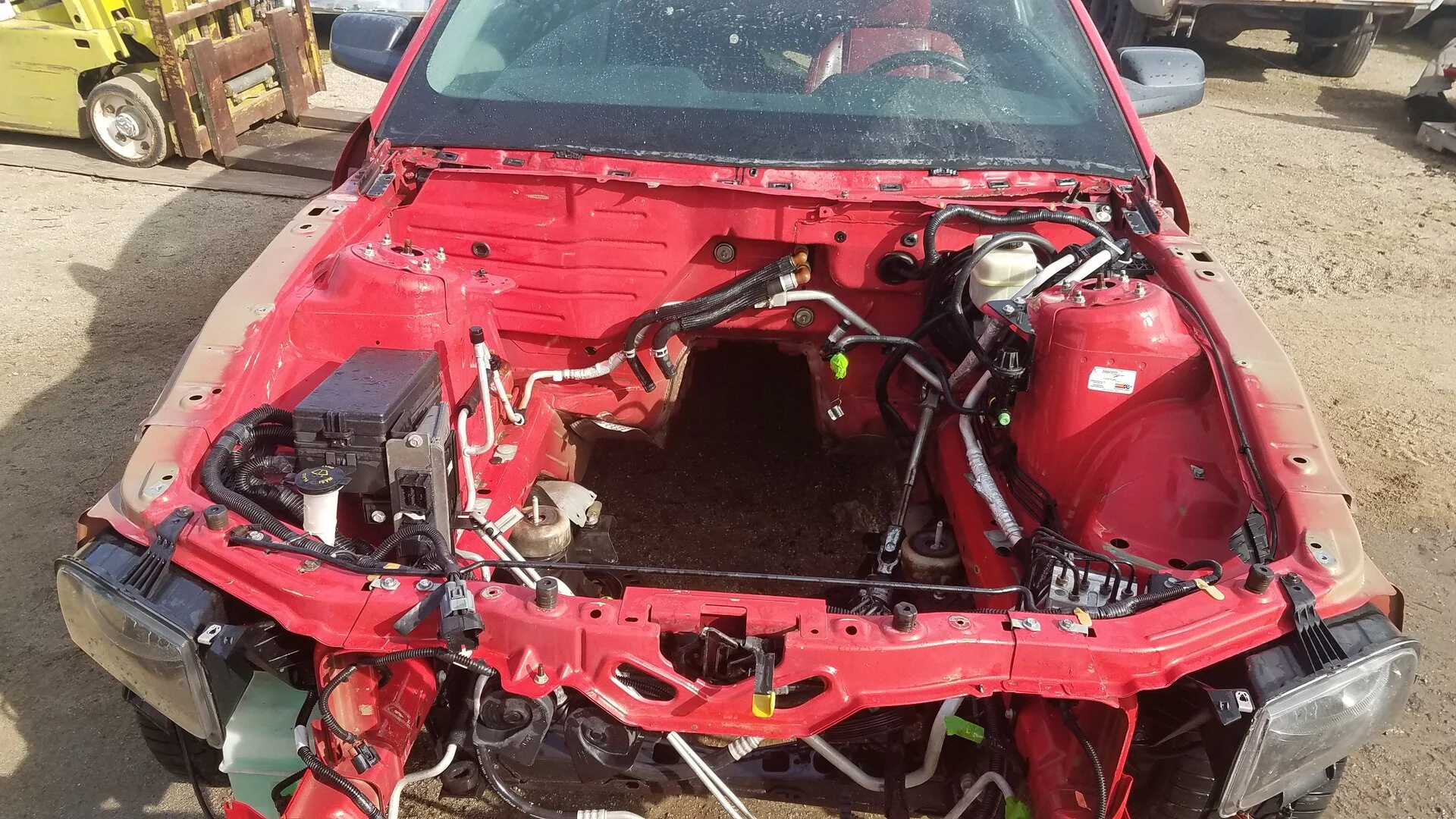

I spent yesterday and today pulling motors ,the 4.6 3 v from the wrecked 07,and the 3 v from the red 2005 ,easiest motors i have ever pulled . And by the way the blown motor in the 05 isnt ! Yep the starter was stuck ,the solonoid kicks but the starter doesnt spin ,i put a breaker bar on the crank and it spins with no problem haha ! Pulled it any way because it had around 170,000 miles on it and the wrecked 07 only has 70,000. Time to pressure wash the engine compartment and the 07 motor and put it back together . And all the shelby trimming is coming off
It runs ,but i noticed a problem ,the 05 harnes has one plug in different from the motors 07 harness so it looks like i have to change the engine harness . The cluster reads limp mode ,i will hook up my code reader and if i cant find the problem i will stuff a viagra down the throttle body ,that should get it out of limp mode!?!?
