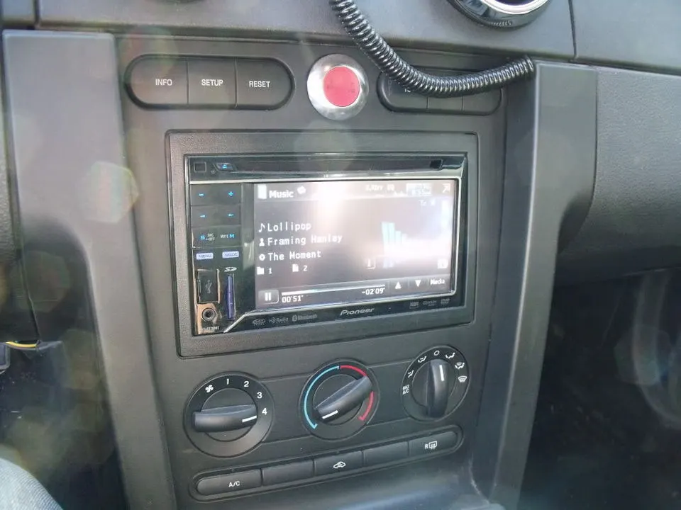

i bought it from them and went to the install techs and bought the harness and bracket. I LOVE IT!!! the safety wire needs a + piggyback though so i just connected it to my primary power on the unit. it was an easy install and ill post pics of it if you need. the hardest thing about it was getting the dash apart in order... only thing i hate about my car XD

whenever i bought my car it was the base model and didnt have the shaker 500 in it. i got the speakers, door subs and amps but my wiring harness wouldnt work with it so i had to rig mine some but now, with that pioneer, im getting better and more sound than i was before because of the built in amp. yes the aux port on the front works but let me ask you this. do you have that aux hook up in your center consol compartment? the reason i ask is because on the back theres an aux hook up. i think its for the ipod. anyway when you install, if that hookup doesnt work with this new head unit, you could buy a red white hookup, trim the earphone plug off it, splice that end into the center consol aux's wires then conect the red white (cant think of the stupid name right now) to the rear of the unit. the reason i bring this up is because i have a manual and having something sticking out of the dash when i drive is annoying and gets in the way. plus im all about a clean look.
it wont come with a remote so scrolling can be annoying sometimes, and it does come with a blue tooth and mike, i put mine ontop of my steering wheel collum and superglued it because that stock adhesive strip sucks. it took me about an hour to install by myself and that was it. it works great and i love mine. heres that pic i promised

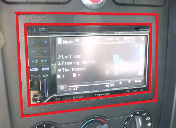

Just wondering, is there any way to buy bigger unit /bigger screen and eliminate the spacer (see attached picture) so the system will integrate smoothly with the console and give it a cleaner look without the need for additional spacer?
