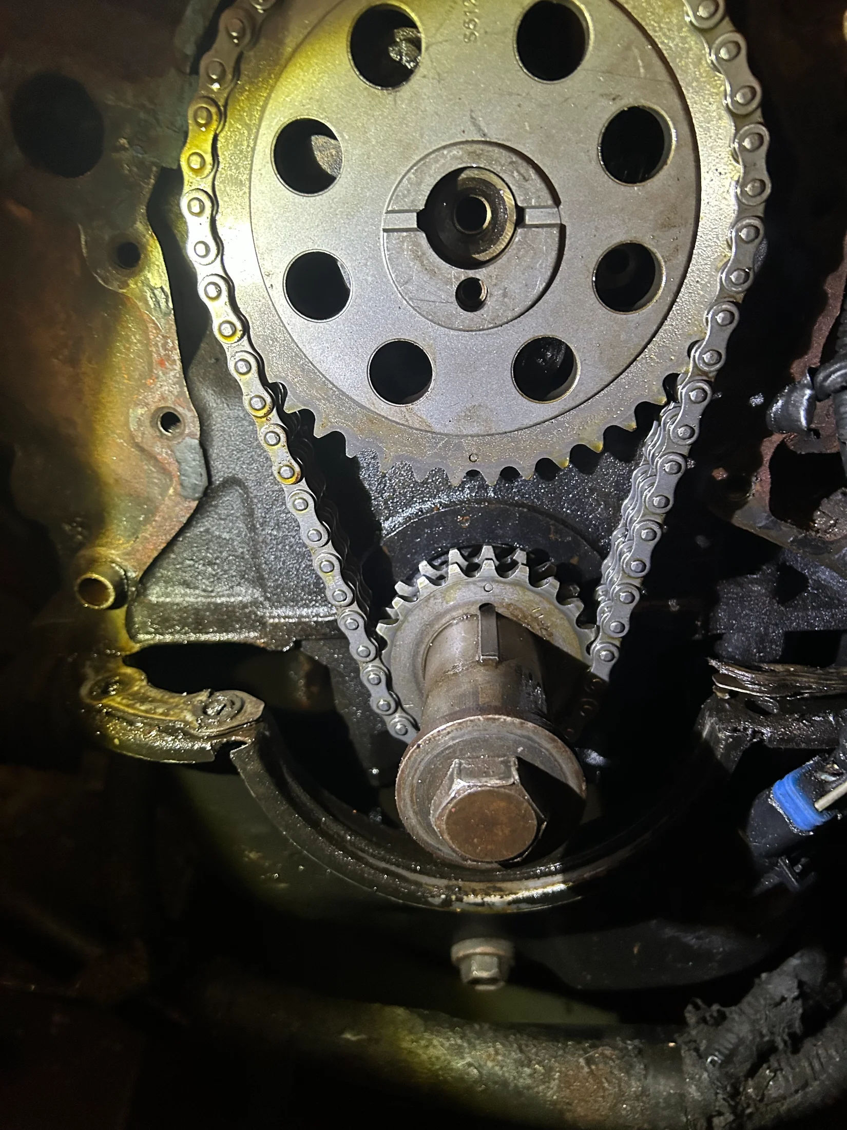

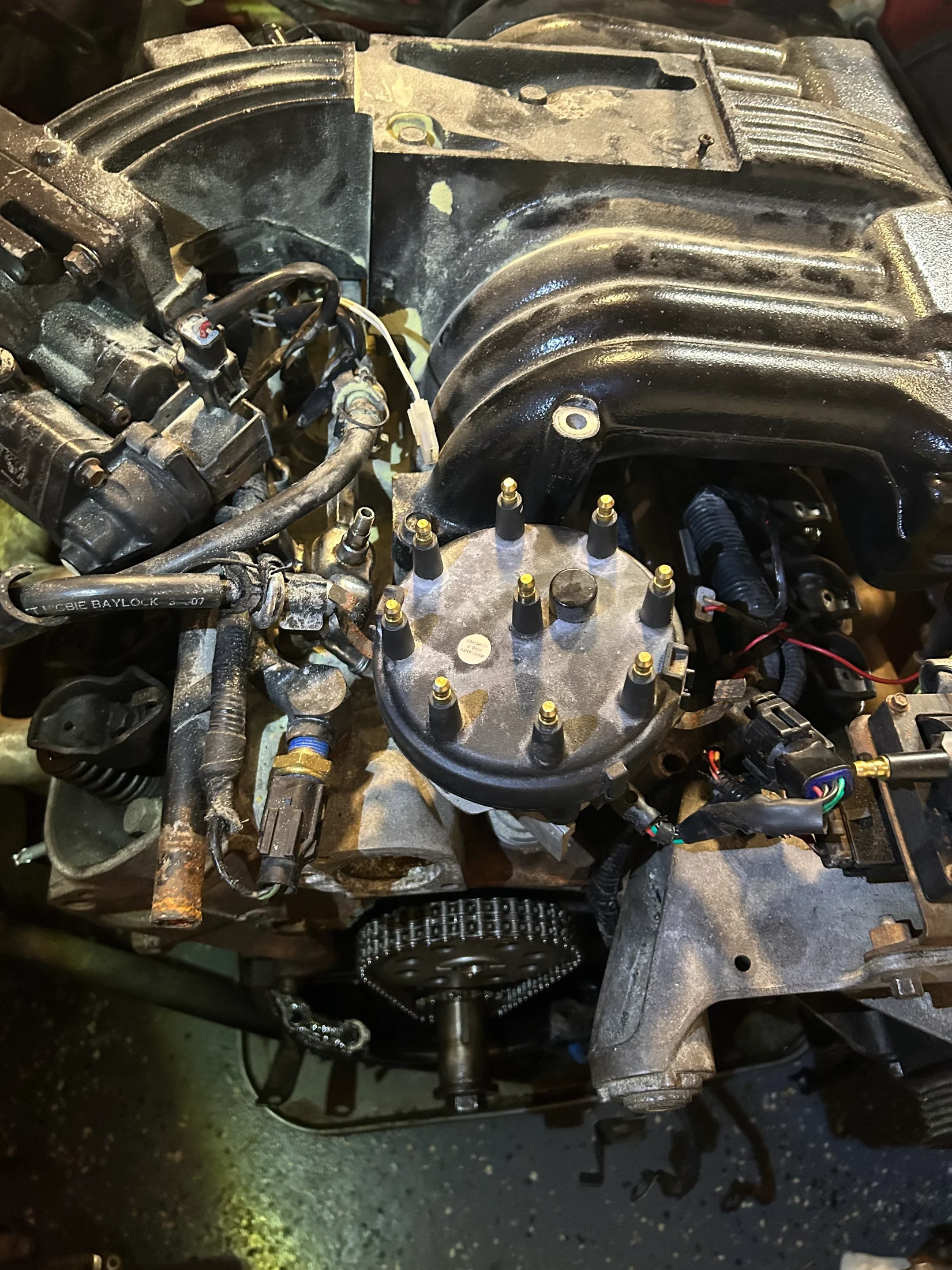

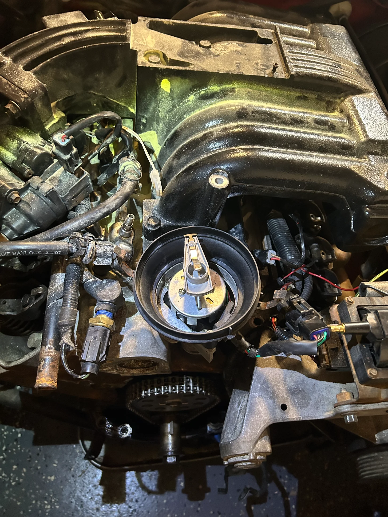

Here are pictures I just took of the cap, rotor, and timing chain. Valve cover is off so TDC was located by watching exhaust valve close, intake open, intake close, and then bringing the piston up to top, verified by an endoscope, and the timing chain dots all line up. I have the dizzy centered on the #1 terminal. Forum posts elsewhere conflicted as to if it should be centered or the center of terminal should be in line with left edge of rotor, I've tried both.
No idea how many miles are on these injectors. The ODO on the dash shows 686 miles.... which makes zero sense, I assume the cluster has been replaced at some point. I have not cleaned or flow tested the injectors. What I did do was confirm they are pulsing by unbolting the lower intake and separated it from the block by about two inches, it was a bit wonky but was able to leave the fuel lines connected and reinstall the distributor. With the coil disconnected from the distributor I we cranked the engine and the injectors were clearly spraying fuel (all over the place).
I haven't smelled gas in the garage, at least not very strong. The car is back down on the ground, next time I pick it up I'll do a quick sniff test on the exhaust, which is currently nothing more than long tube headers.
New compression gauge should be delivered tomorrow. Once it is here I'll get new compression readings and report back.
