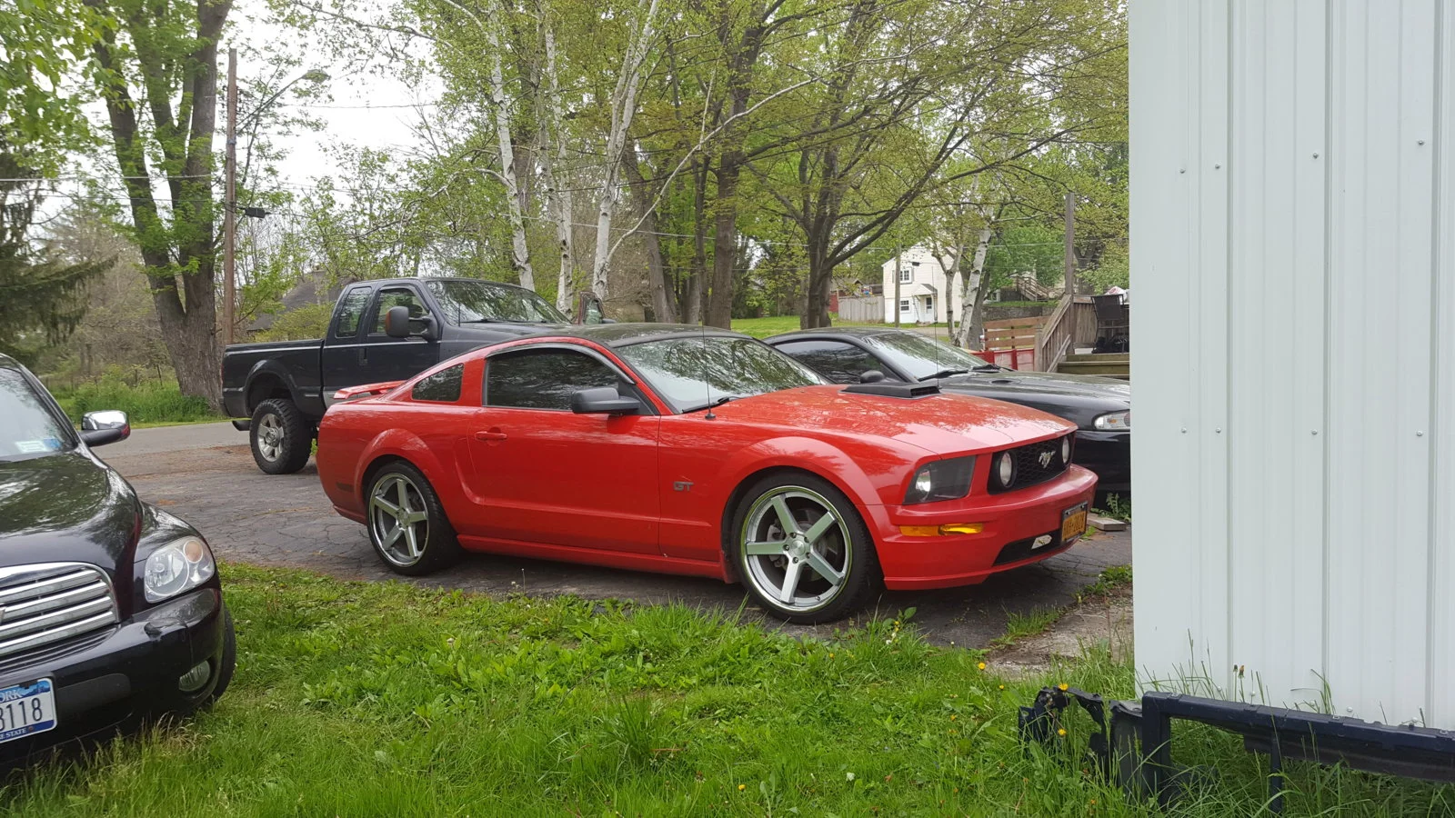

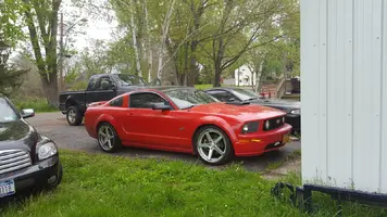

Wife has a 2007 GT. Car had a slight miss before putting it away for the winter. Well it's time to get it out again, so I did plugs and it was still missing. Put a set of coils on it, still missing.
Pulled the valve covers and she has a cam lobe that is wiped out.
Are the FRPP hot rod cams the best option? I will be changing the rollers and phasers while I am in there. She doesn't really need anything but factory cams, but it's probably a waste to put stockers back in there.
I have read some threads that say a tune is needed, and others that say it is not.
Does anyone have any real world experience?
The car has jba equal length shorties, full exhaust, CDC shaker and is a 5 speed.
