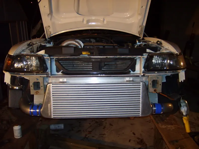

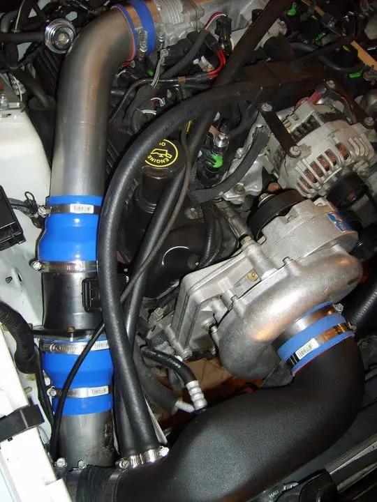

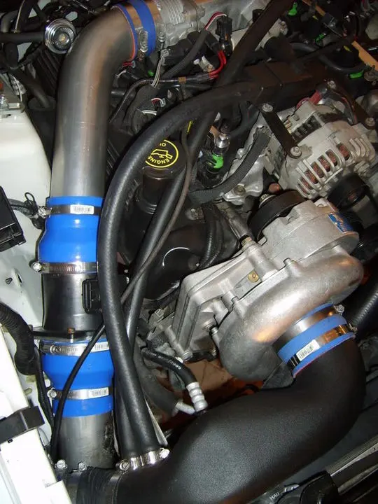

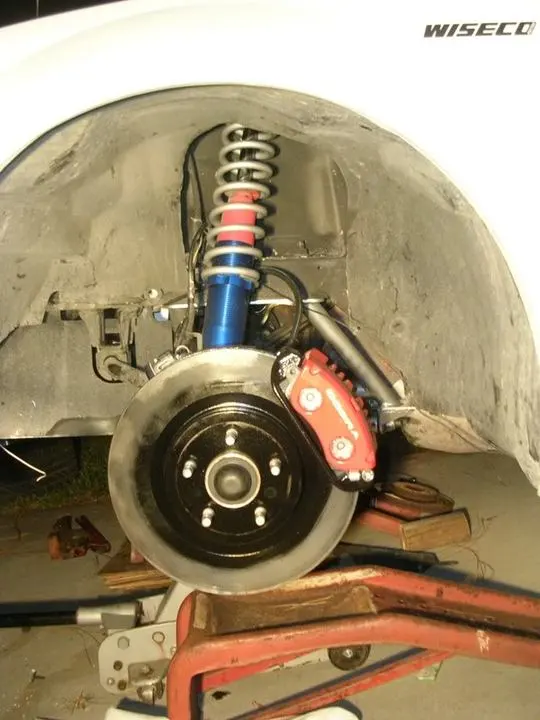

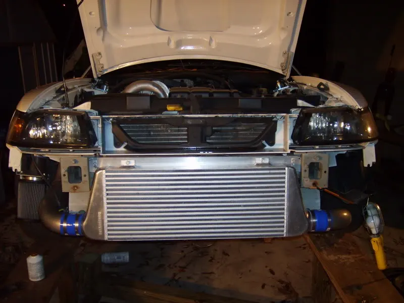

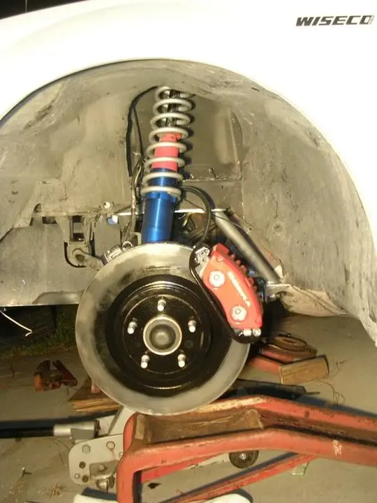

3rd gear fly by
had to make room for the turbo piping.
the 42#rs are gone now... running 60#rs, twin focus pumps
Right now I have a stock 4.6/vortech back in it so i can still get to work. I should have the 5.4 done in about a week, but I still dont know if I'm going to run it in my car or my friends, I have a 5.0 stroker almost done as well, and I think I will be going with it so I dont have to spend so long modifying the turbo setup that I have. It's also an aluminum block.. which would be nice... I'm upping the turbo from a t70 to a t76 Q trim. Power will not be an issue. My main concern is staying on the ground.
More pix soon as I get them... Been working my a$$ off lately to feed my habit....

I would like to take the time to let everyone on her know that I dont plan on DEFINATLY hitting 200.... I have NEVER raced on the salt, and have no clue how the car will behave. And I havnt run it full out with the top down, I dont know how much that will help/hurt my speed either. Before raising a BS flag, please read and find where I said i WAS GOING TO RUN 200MPH. I didn't.
I want to, and I am shooting for it. But for my first time out there, the elevation, and lack of experience I believe I will do a best of 170-180. I will still push it until it blows or just doesnt go faster... I am kinda worried about running the engine full load and at 6K rpm + for a few minutes.... thats a lot of stress. My car will make 194 mph @ 6K rpm with my current gearing (if the tranny holds, i'm sure it will be the fastest tr3650, and the engine, possibly the fastest 2 valve)
