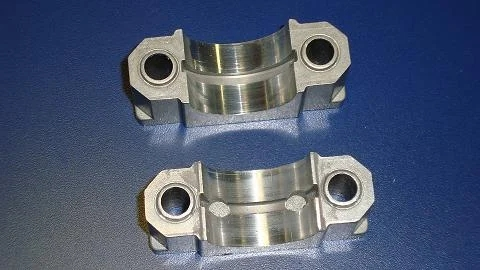

I ordered kit AT4Z-6A296-A to plug the camshaft oil holes. I was planning on taking the camshaft caps down the street to the machine shop for a quick modification instead of paying $400 for a metal cutting hacksaw from Ford (tool 303-1597) that would do an inferior hack job (no pun intended).
However, detailed instructions for using the tool don't seem to be available and I just need to know how these camshaft camps should be cut. Looks like no more than 2-3MM deep or so and as wide as the groove cut into the camshaft from the one low resolution relevant picture I found online. Pic attached. Any help would be awesome!

I have no answer for the first part, because even as a former Ford tech, I read that TSB and said "dafuq?"
That was my same reaction. At first I thought there was an existing groove to make deeper in the camshaft caps, but this is cutting a new groove on each side. My plan was to just rotate the engine to where the exhaust cam lobes are in a neutral position, take off all the cam caps, run down the street, machine them, bolt them back up and perform the plug procedure, then do the same for the intake cam side the next day.
