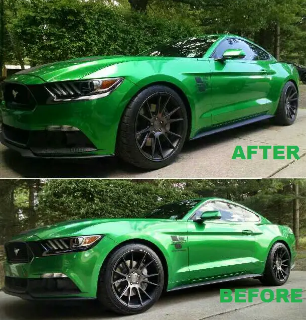

This was before and after lowering the car. I'm waiting for some better weather here in NJ to be able to get some more pictures:
is H&R in the spring game with mustangs? good to know on the coilovers. That is some nice HP gains from just catback. Are you wheels stock? I definitely will be doing a wider tire out back, If I can get 315's I'm happy. I've heard good things of the stainless works stuff. At this point though I plan to do at most a mid pipe, and cat back.
Your car looks nice. I think I would want it a little lower but it's hard to tell. Post up some new pics when you have time! :)

As far as being low, maybe it's me getting older? I originally bought the sportlines and last minute changed my mind, I still have them and would cut someone a good deal on them if anyone was interested.
