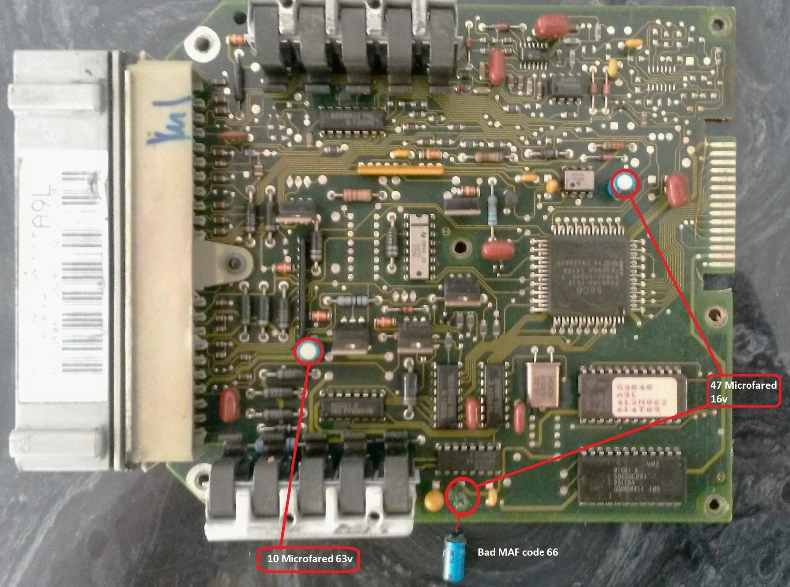

Yes, It has gas lol. My wife was driving and that's the first thing I asked and checked. She said before it died she smelled a chemically smell. Which sent me in the electrical direction. I have had the EEC out for a visual inspection and saw no burnt looking pieces. That said, I have not ruled it out the EEC.
