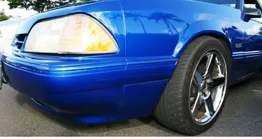

i got kuhmo spt 255/40/17s upfront on some 03 cobra wheels. they dont look stretched at all. the rims do rub the control arms on full lock turns. heres a pic.
