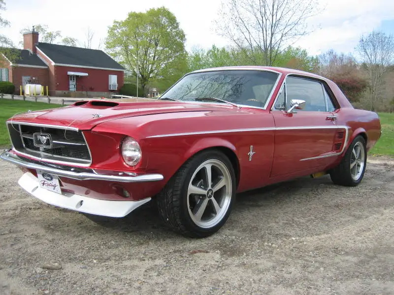

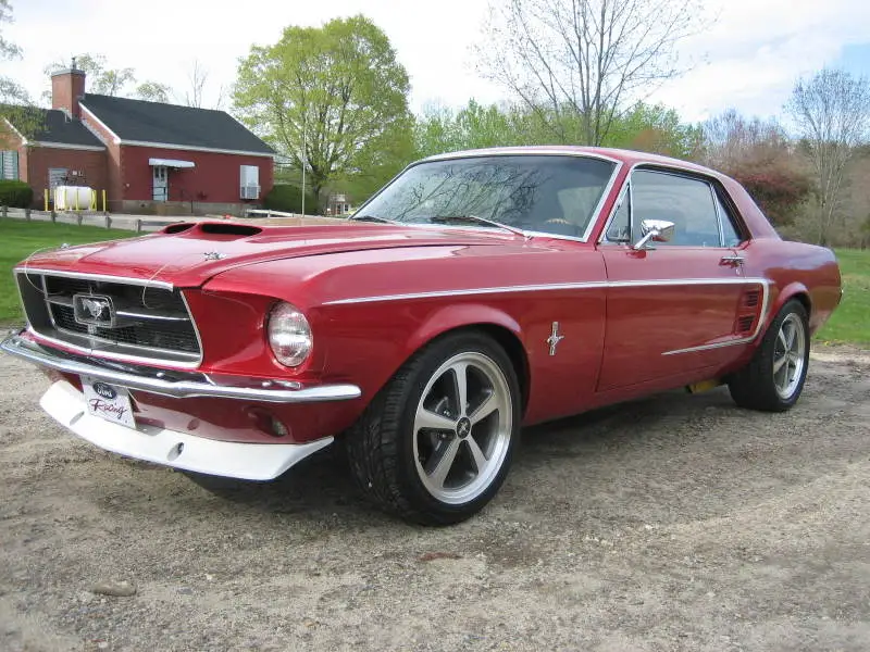

thanks guys for the pics...i already have the wheels and was looking into what size tires. i have the late model mach 1's like in the photochop sig. i thought about 255/40/17, but they are probably too wide for the front and ion order to get the profiles on the front and rear the same i would have to go with like a 225 on the front and i want something wider than that. looks to me like the 275 will be ok on the 8" wheel by those pics...

Sorry, I don't have any pics yet. I would really be afraid of the tire seperating from the wheel which would be extremely unsafe. It might be okay for some 275 tires to fit on 8" wheels, but not all tires are created equal. Make sure you check what size wheel range the manufacturer recommends for the tire. Also, talk to the guys at Tire Rack , they know what they're talking about.

I havent seen nor heard of a tire comming off a wheel and everybody first bitched about me saying the tires will fit when i put them on . Is it the "optimum" size"? Probably not, but it will fit as will as 285 too.Tire rack reads wheel chart like the rest of us do, they arent thet well trained in wheel/tire fitments.
