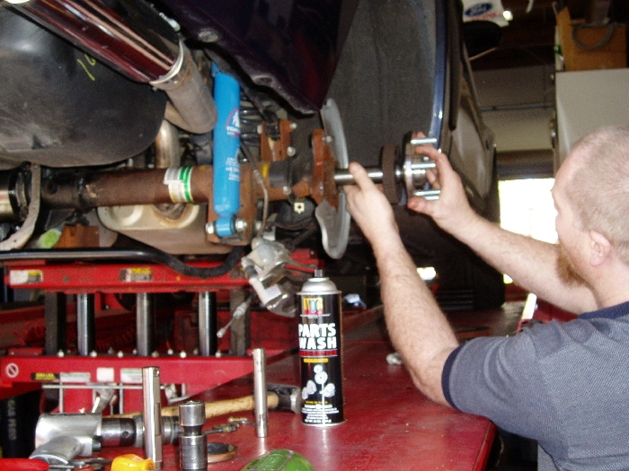

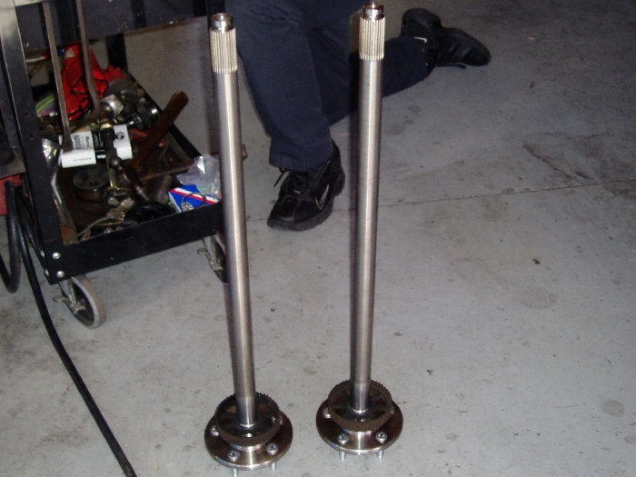

If your in there already doing the gears, do the axles as well. They have to come out anyway for the gear install.

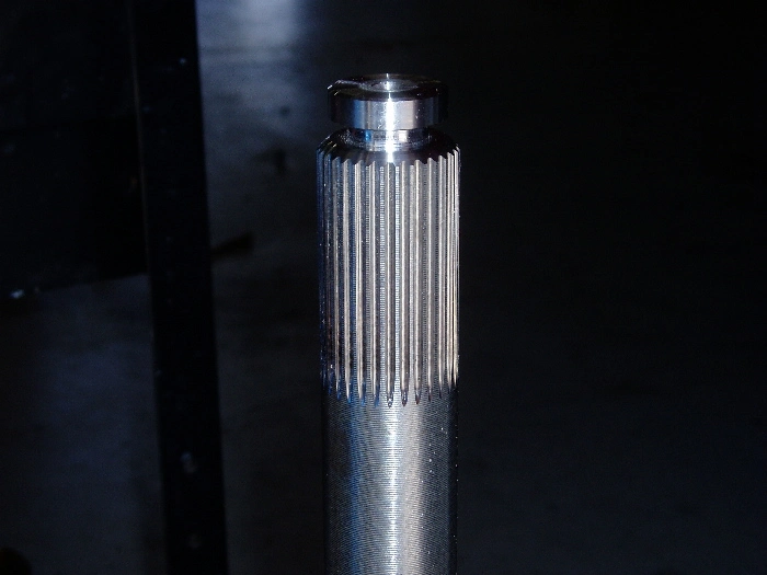

The biggest advantage to aftermarket axles is that for example Moser's are a custom alloy. Tensile strength is much higher than the cheezy stock ones.
