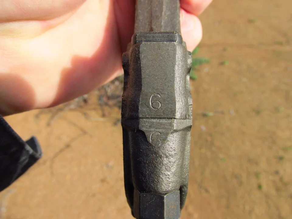

The rods and caps are usually stamped on the sides where the come together with the cylinder number ,some times they are hard to read . Numbers always point to the out side of the block on each side . Getting the caps back off with out ruining something may be tough if they are wedged .Maybe a large pair of channel locks and gently rock and pull at the same time on the caps. Inside the rod and cap you will see a notch, the bearing locks into ,they must line up when the cap is on the rod .the closest cylinder to the front is number one and that same side will be 1 through 4 .The other side starting from the front will be 5 through 8 .

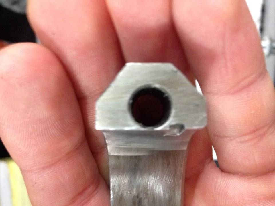

Ok so started putting it together again, made it to the last 2 cylinders. Number 4's rod cap got screwed up at some point either going on or coming off. There's a lump next to the threaded hole on the cap. So I'm assuming I have to replace the rod, is this correct? And if so can I just get a replacement and mill it to the same thickness at the crank end as the old one?
Ok so here it is, had already tried to file it but I'm sure if I kept going I would break through into the hole. So where should I go from here?
