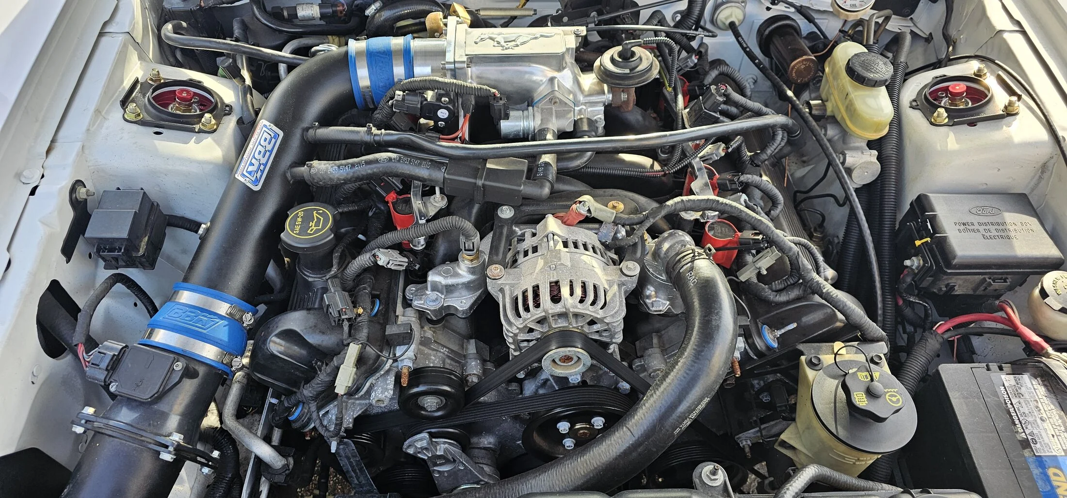

I'm currently looking at buying a 2004 that supposedly has a built 3v swapped in.
I'm confused on the intake that is currently on the motor. Any input is welcomed.

No.
The intake port is so different that a 2V intake will not work on a 3V head.
It is possible that it is a 3V short block with 2V heads, but WTF would anyone do that?
They are both the same displacement,

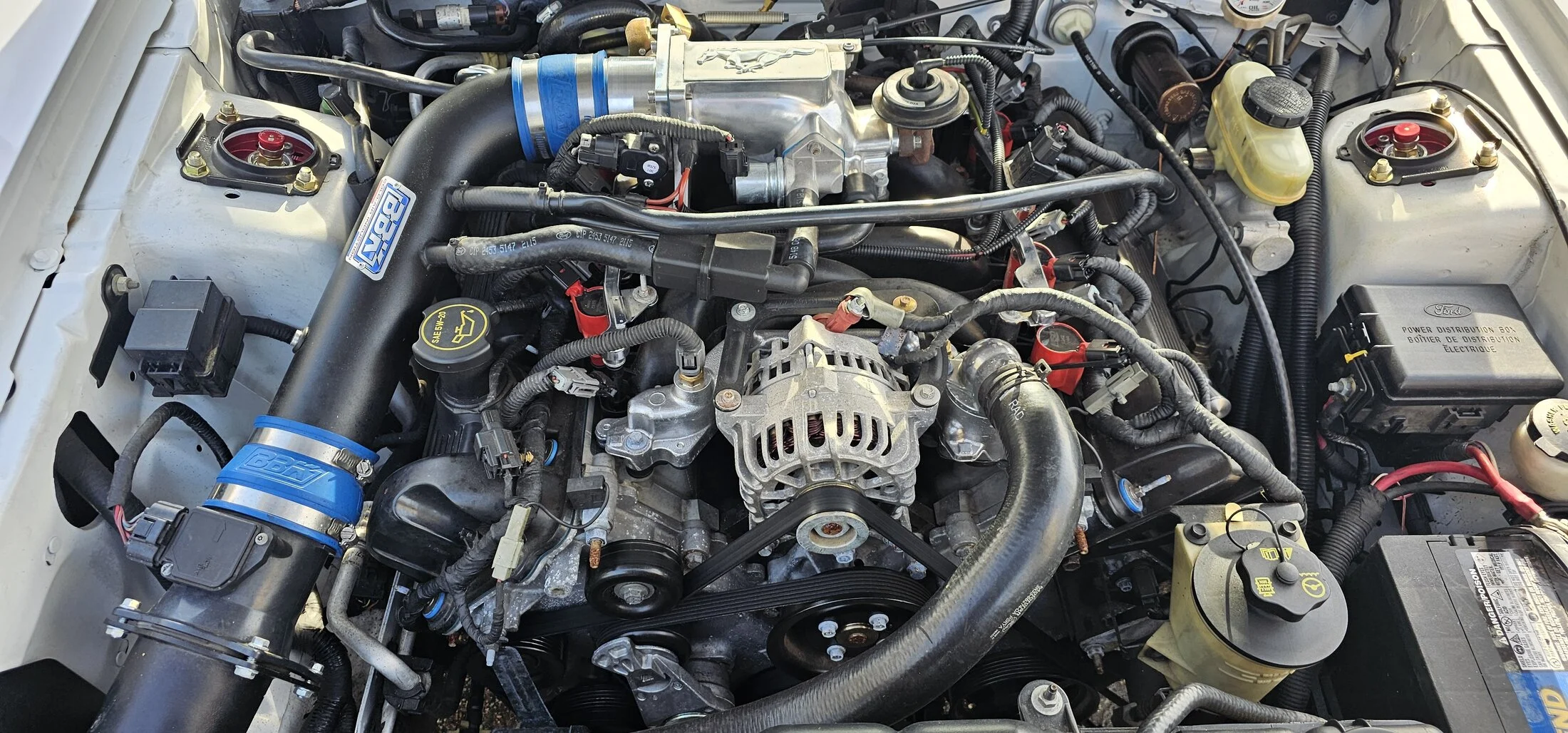

I don’t see $18k into that.
That’s a stockish 2V with a stock intake and an aftermarket plenum/throttle body. Those might be a set of pulllies. If it had cams, you’d hear it.
It’s probably making 270-280 crank HP. Closer to 300 if it had long tubes and h-pipe and good mufflers.

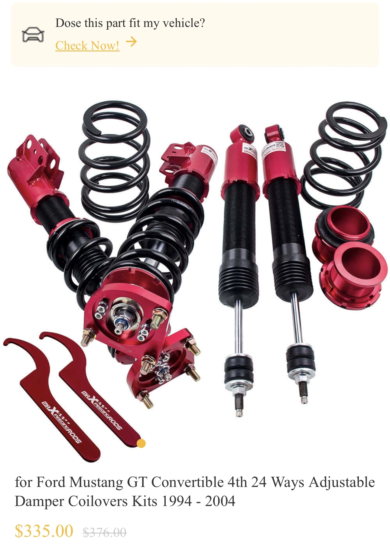

Looks like it has maxspeedingrods coil-overs which are $300 coil-overs. You can see the annodized red poking out in the strut tower. If they aren’t riding rough now, they will be.

Edit: does look like it’s an Accufab plenum. Someone stuck the stock plenum pony emblem on it, which is a good idea
