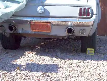

Tires have been on the car for about 1 year.. they fit snug but are awesome.. I will post pics tomorrow.. also depends on what backspacing you are using..mine are I think 5" or 4.5" they sit in there nice. I spent 6 hours with the guys at the tire shop finding the biggest size That would fit back there.. 295s were right at the quater panel lip and would have hit..

Heres the 27/60/r15s
