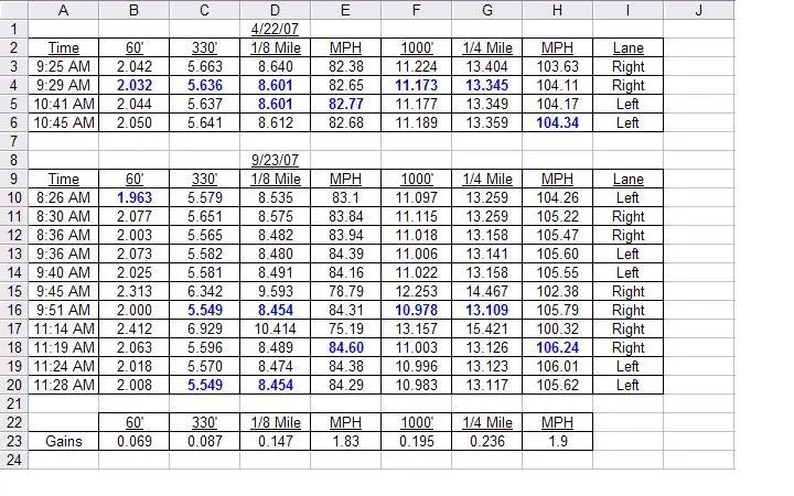

In April, I was able to launch around 1700 RPM with very little tire spin. This time however, after removing 195 lbs from April's runs, I had massive tire spin and was only able to launch just above idle. Here is a chart of all my runs from both outtings. You will see my 60' times are nearly identical, but everywhere else improved greatly. Next year, MTs and 12s:nice:
Rows 15 & 17-I spun all the way into 3rd gear in both of these runs and had to let off the gas and let the tires hook before stomping it again.
