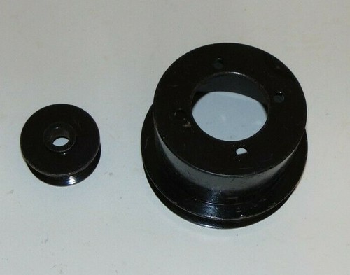

What about UDP? this one seems interesting:

I used an underdrive pulley on my autocross V6 in conjunction with the other mods. I don't see that one mod making a huge difference by itself on a 94-98 V6. And there are other concerns about charging that come along with underdrive pulleys that wouldn't make them my first mod.

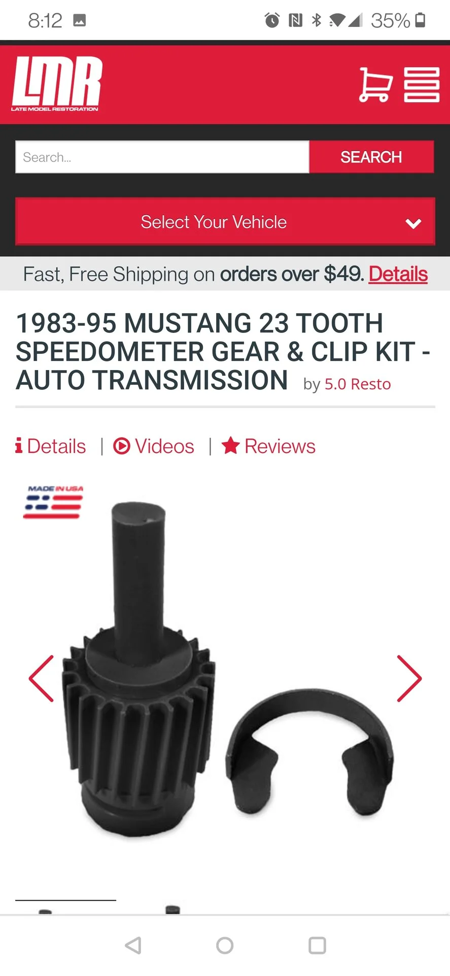

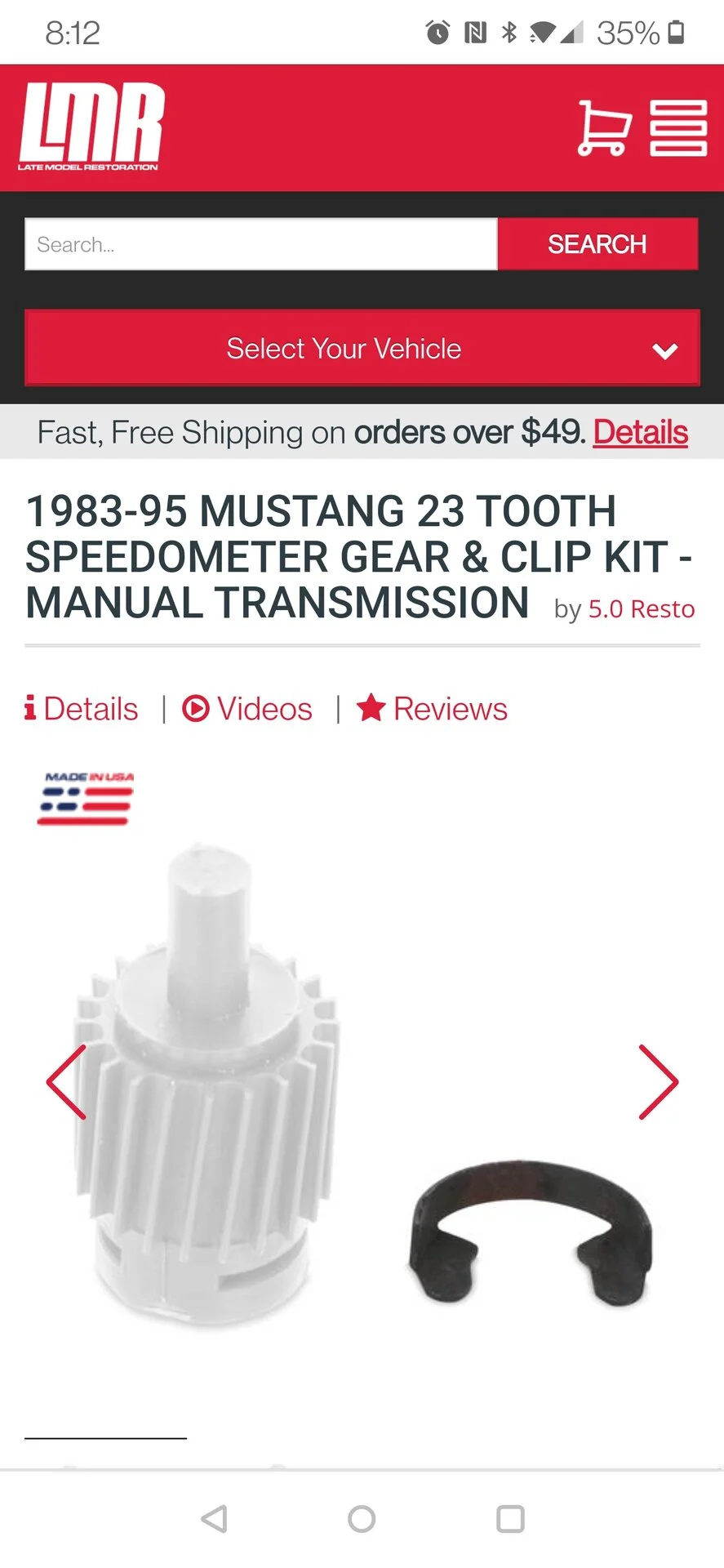

Going from a 2.73 to a 3.73 will be a very noticeable change. A LSD will only affect how your car will launch, it will not affect the effects of the gear swap. All a LSD will do is make it so both tires spin instead of one when you launch. BUT.... if you want a LSD, installing it during a gear change is the preferred method since it can all be done at one time. Another point to mention, changing your gear ratio will affect your speedometer as well, so that might be something you want to address when you're having the work done.
If you're limiting your budget to ~$600-700, I'd definitely concentrate on the axle first. I'd pick up a LSD (since I'd only want to have the rear end torn apart one time...), gears, speedometer gears to correct the inaccuracy, and go from there. Factor in oil and incidentals and I'd suspect that that would exhaust your budget. Then, when funds allow, pursue the other good advice that was given here. I think you'll be pleasantly surprised at what kind of difference just swapping the rear gears will give you. :)
Reactions: danielr410
I can't really answer those questions. I'd suspect that the only difference between the colors might be for transmissions of different years? But that's just a guess. And I can't answer the wear question at all, I have no experience with them in that application.
Looking at LMR's website, they indicate the black one is for automatic cars, white is for manuals.
