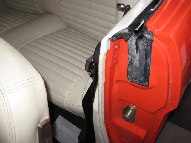

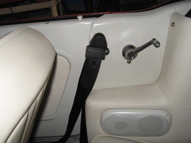

Hi,
I installed them in my cvt. Although the should belt angle is not optimum, they work very well. For me, they are better than the alternative. I've read were guys have installed them in coupes and 2+2s and get a better belt angle as you have over head "iron work" to attach the upper belt pivot.
Good Luck! door post seat belt attachment.webp seat belt door pillar attachment.webp
