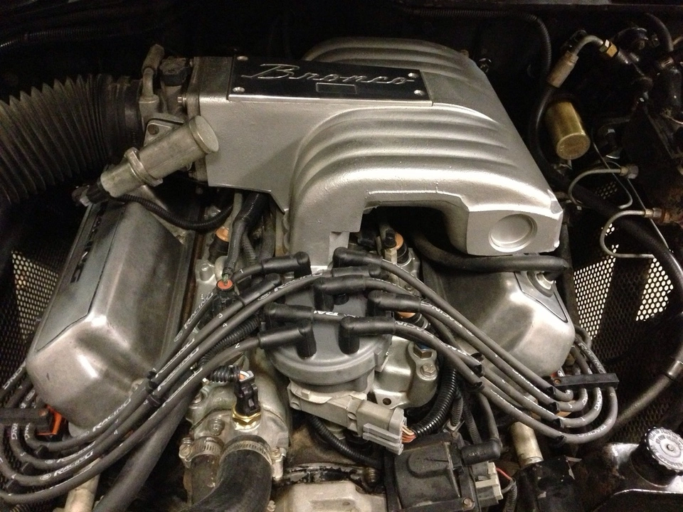

I don't know if the hood clearance will allow, but BC Broncos has a adapter. It allows for the truck 351 lower to be mated to the car 302 upper.
http://www.bcbroncos.com/store/product_info.php?cPath=131_108&products_id=1059

I know you were talking about the tubular upper pic... But here's one with the adapter I linked.
Reactions: 89oem
