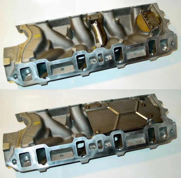

If it is your pcv valve ,this guy on utube makes a catch can ,looks simple enough.let us know what you find
And unfortunately stopped making the large better baffle!
Yup. Was a common issue so much so that Ford did change the baffle design. It's part number F6TZ-6L678-AA but it's been discontinued for a while.
Try a separator on the PCV to see if that is the cause of your consumption
Reactions: 7991LXnSHO
Is this also an issue on the Exploder intakes? If so, is there a part number for that bigger baffle?
the explorer intakes already have the new baffle. Ford started adding them in 96 on the explorer, but not the kit intakes.
My 93 cobra lower, bought around 2000 or so, has the small baffle. The 96 explorer lower i ported and installed in its place has the big baffle
