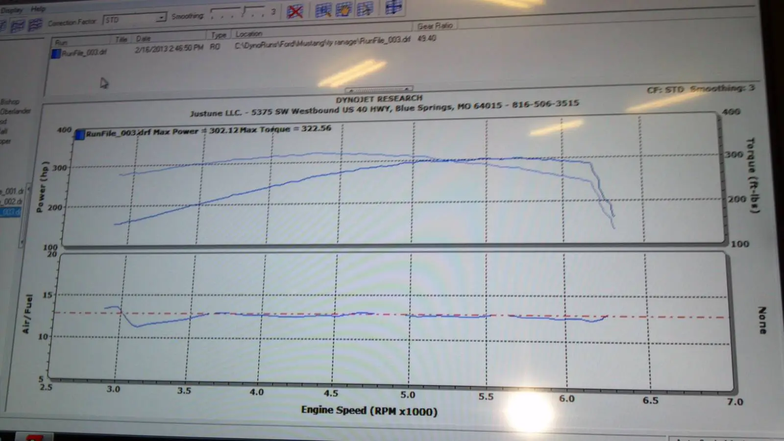

finally snapped a pic of the dyno run

The AFR looks good and it's stable, so at least the big carb is doing its job.

I does look really nice except for the initial tip in.
Looks like it needs a smaller squirter, and if the pump cam is not maxed out, more duration.
That high spot upon tip in is too much fuel from the squirter at that instant, then it runs down for a moment before the main circuit kicks in. Too much squirter, not enough duration. Duration is extended with a smaller squirter, which will lower the initial rich spot, and raise some of the lean spot. But I suspect more cam or pump volume is needed.
Edit:
I checked to see what carb he has, and with a DP, I wouldn't think you'd have to mess with the pump cams. They should be 330 cams, set in position 1, hole 1, and that should be plenty. I would focus on squirter size, mainly on the rear pump circuit, and I would also check the pump arm clearance in the rear circuit first. It might be a little loose. Since they stabbed the gas near 3k rpm, and it hit a bit rich, the front circuit may have had some residual fuel, meaning it's possible the front squirter could step up a bit in size, but until the rear circuit is tuned, that's just a guess. At 3k rpm, the front circuit should be spent, and the front main system should be all in, at least I would think....

With peak HP at 5500rpm, peak TQ at 4300rpm, and the 302HP/322TQ numbers at STD correction (SAE would be 290/310), I suspect even more that your engine is actually a 308 with the stock crank and not a 349.

Wow very informative, thank you very much for the insight and once the weather gets nicer i'll definitly start messing with carb
