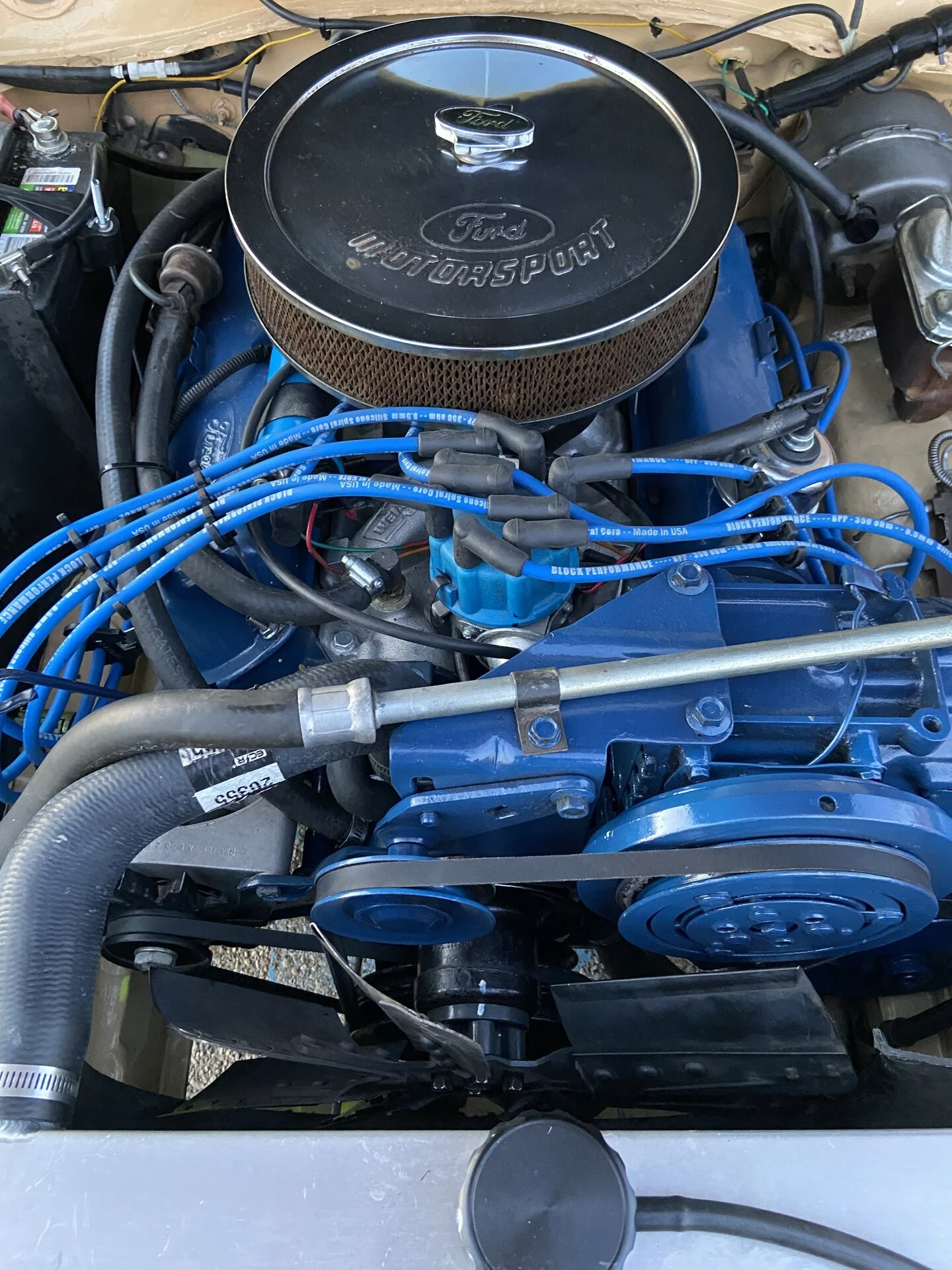

Pictures please.

Under hood looks clean!
