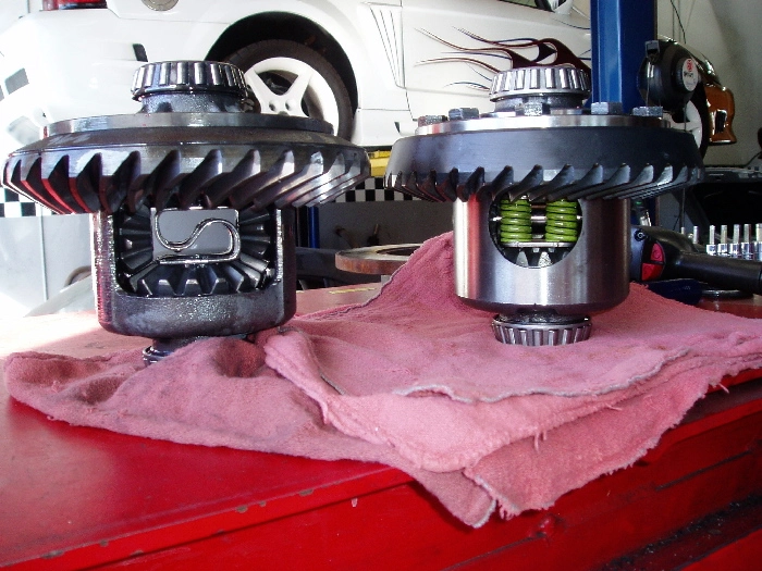

R Rocketman New Member Apr 20, 2004 730 0 0 SoCal Jul 15, 2005 #5 Jul 15, 2005 #5 Yes you will need a 31 spline carrier. Here's my Eaton 31 spline as compared to the Stock 28 spline. Attachments Stock-Eatonposi.webp 163.5 KB · Views: 113
