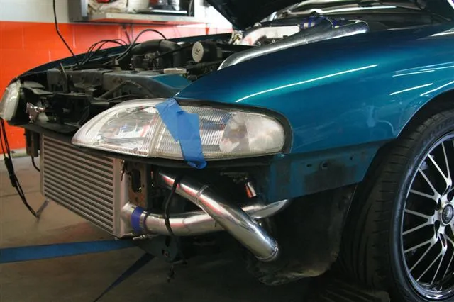

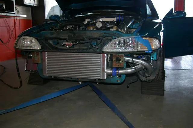

I went by the shop last night and the car is behind schedule at the moment all the tubing is welded up and in place the Kenne Bell manifolds are going out for polishing today and should be back by Monday next week then final assembly next tuesday and dyno tune and should be ready to pick the car up Wednesday. Didn't take any photos i forgot my camera but the set up looks sick i can't wait to show all of you the final product.:canada:
I have an update the Kenne Bell manifolds and all the tubing for the intercooler should be back this wednesday and then hopefully thursday will be final assembly and then dyno tune thursday or friday which means I should have my car back this friday or saturday. Can't wait:nice:

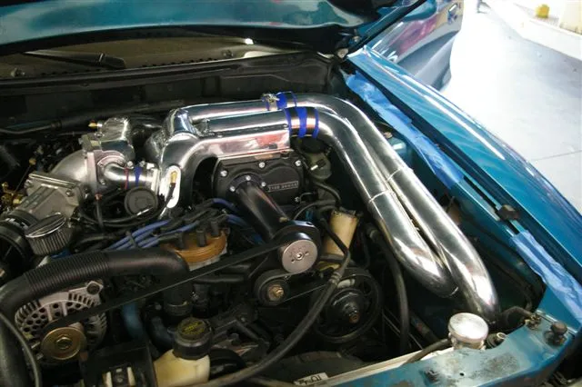

I've seen that guys set up and video on youtube it's awesome that's what motivated me to do something about my Kenne Bell. My car's putting 365rwhp and 385ftlbs (6-7 psi) when the cars at 195 degrees but as the temp rises i lose about 20-30 hp.:notnice: The car runs great right now tons of torque down low just a blast to drive but after i spent the money on the motor i want the most out of my set up it'll come in around 450rwhp and about 500ftlbs of torque with about 12-14psi it should be done this friday I'll keep everyone posted.:D
Update the car has had some tuning issues the intake is restricting the motor from making the power it should so i'll have to work some more on the intake side of the blower like custom fab a 90mm throttle body and do some work on the flowzilla manifold to maximize flow the best numbers on the dyno at the moment is 381rwhp at 4500 rpm's and peak torque of 470 ftlb's at 3500 rpm's:canada:
Some pics:jaw:

Drove the car home last night what a monster out of the hole to about 5000 rpm the car just goes wow:nice: Now over the next couple of weeks I'll be modifying the flowzilla intake manifold and modifying to a 90mm accufab TB that should take care of any flow issues I'm having now. then I'll be able to wick up the boost and make the numbers i want and I'm entitled too you couldn't punch the smile off my face right now.:rlaugh:
