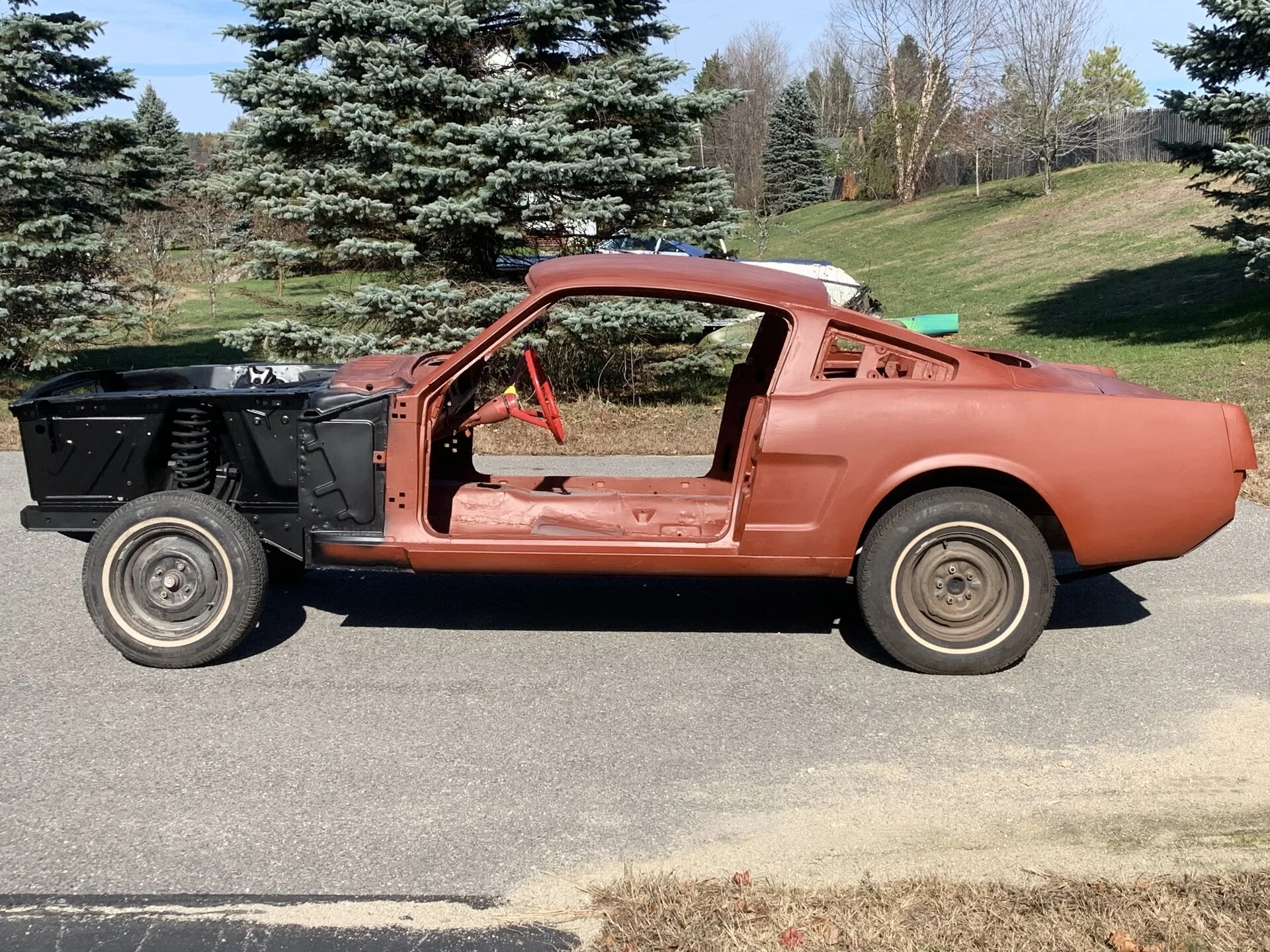

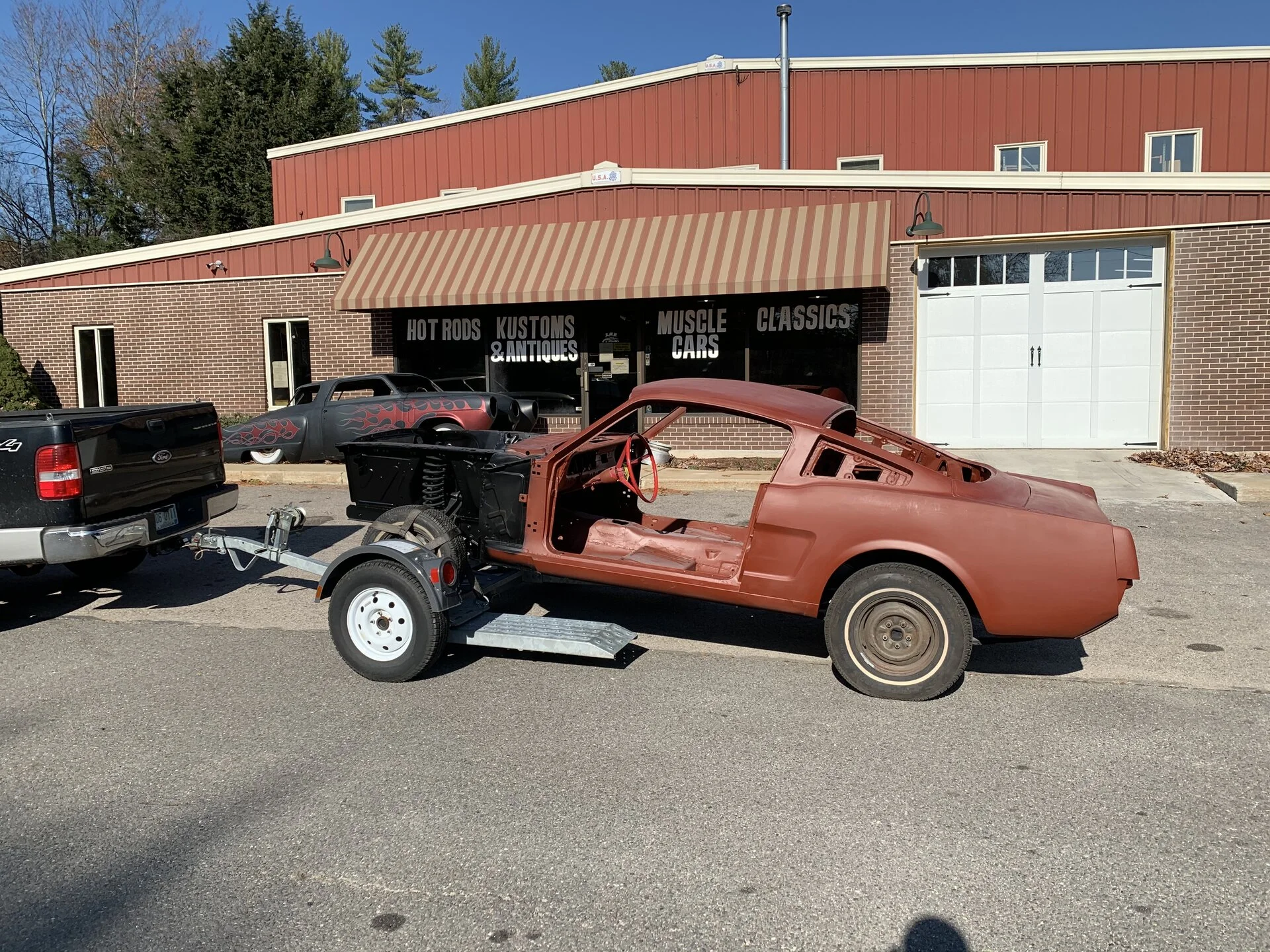

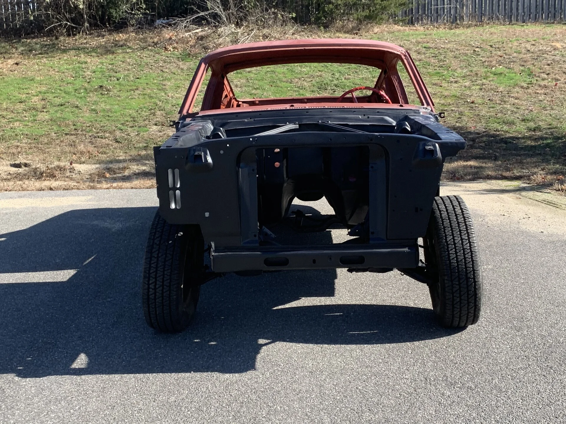

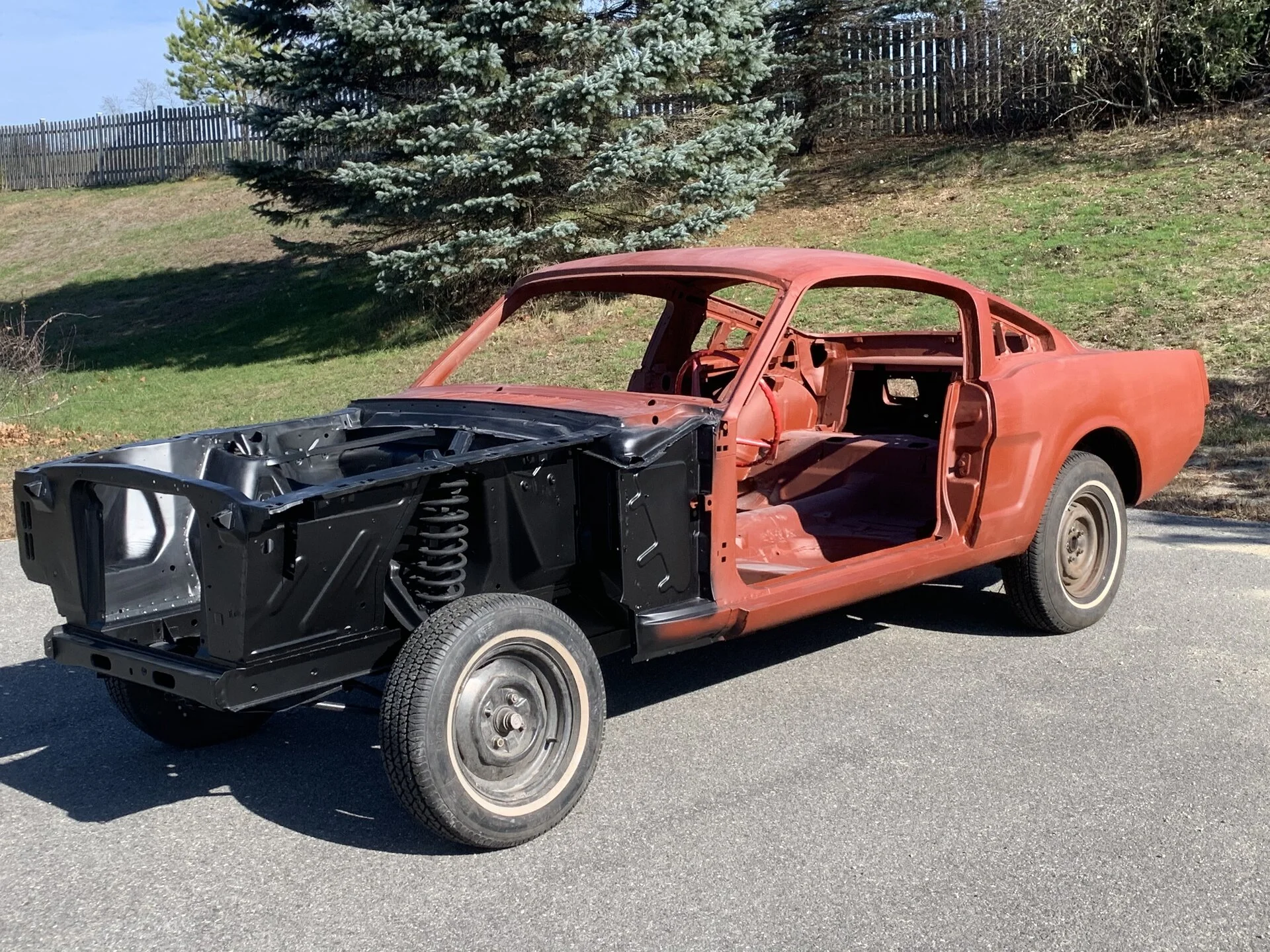

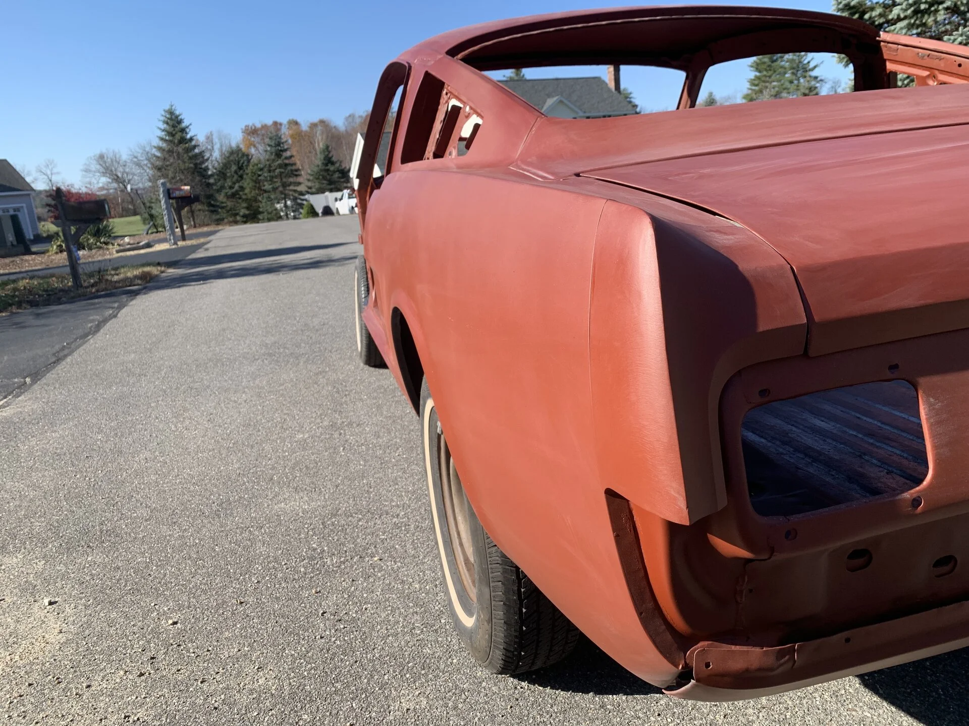

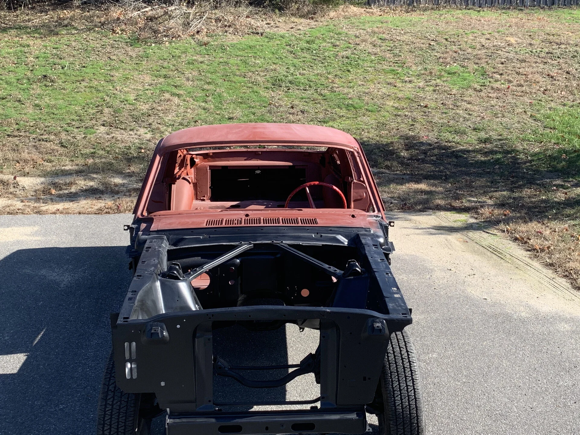

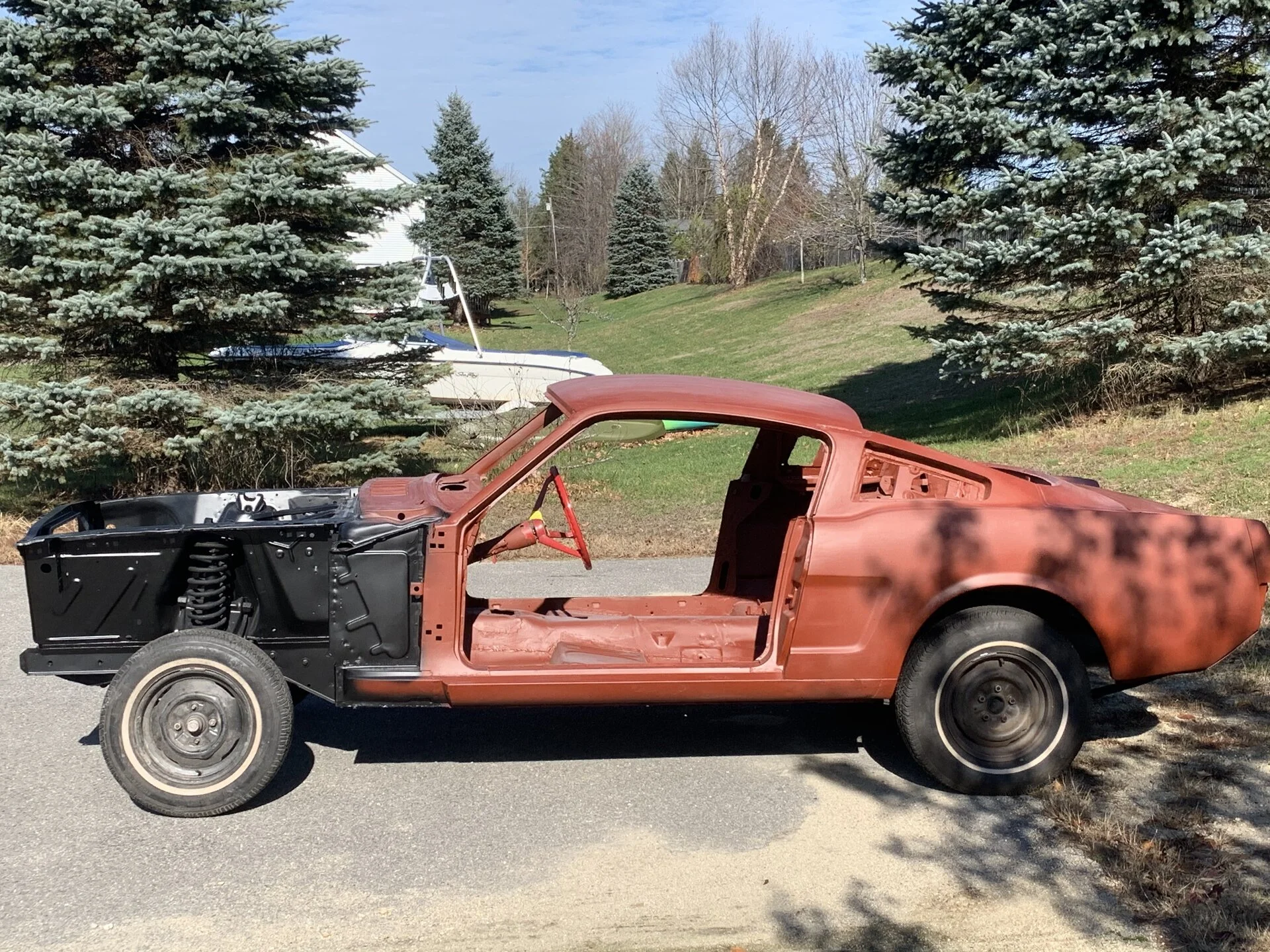

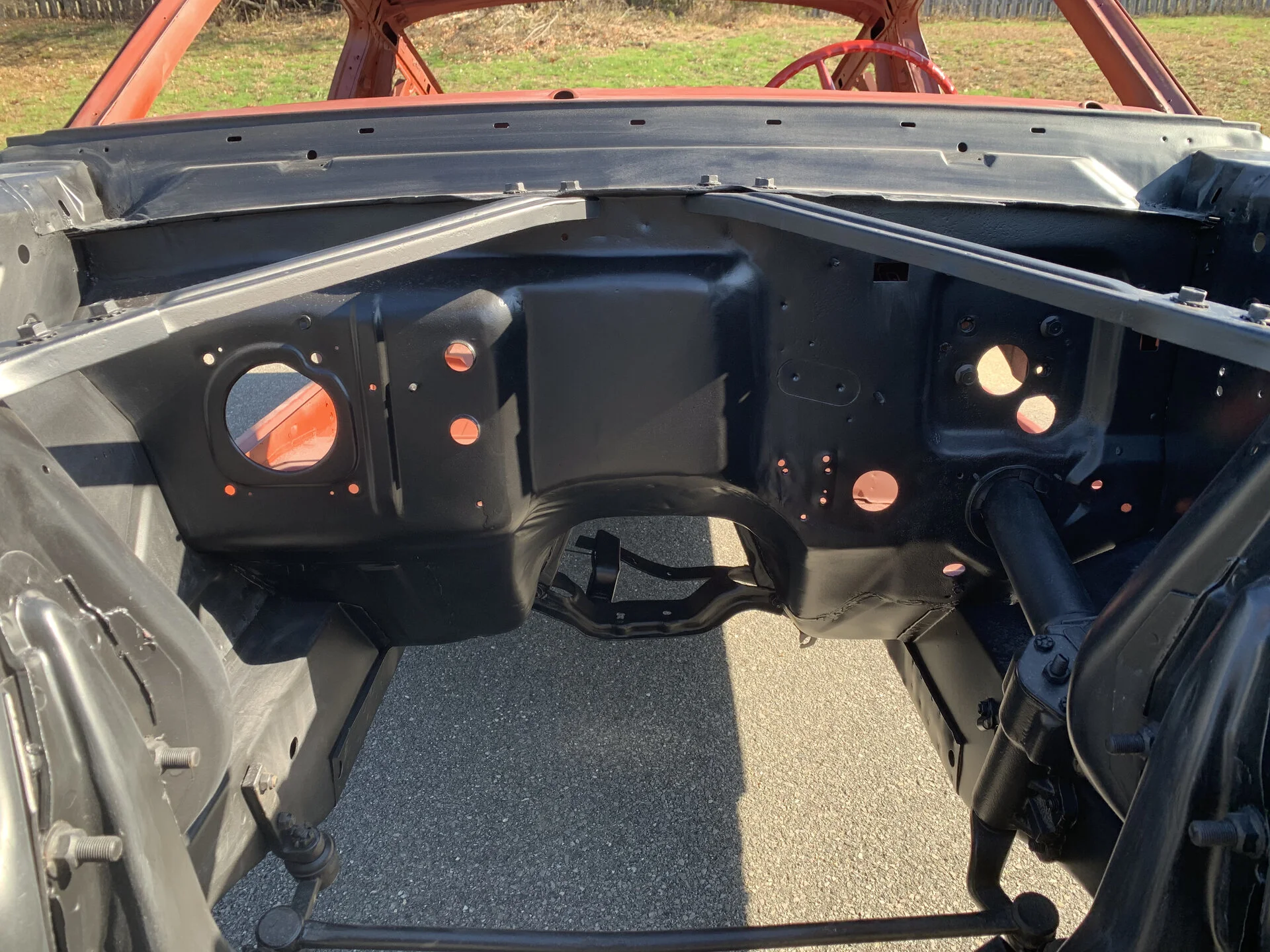

Got her back from the body shop today.
  • Hell Yeah!
  • Love
Reactions: a91what and 2Blue2

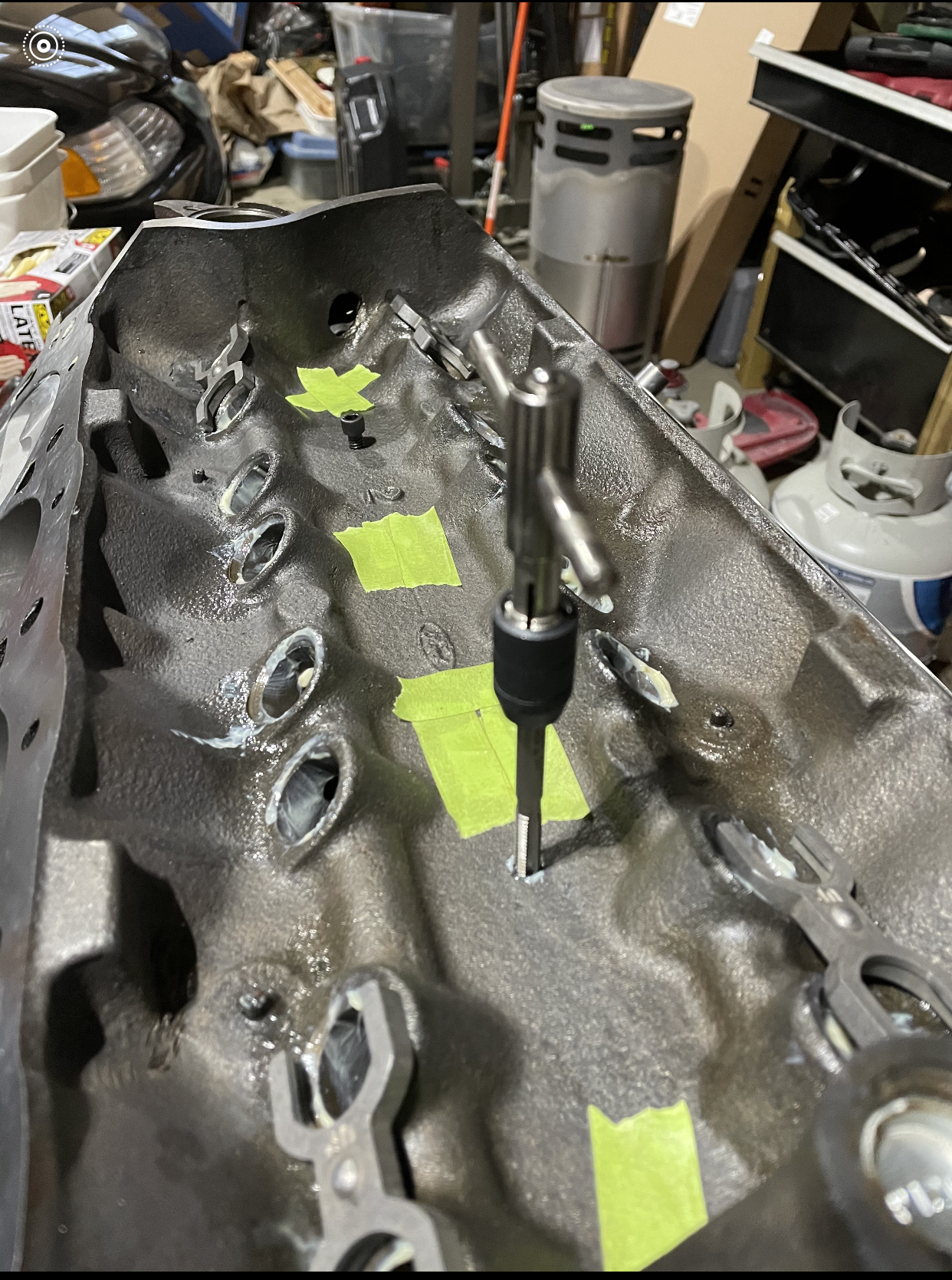

Tapping the block for the Lifter spider - converting the block to hydraulic roller.

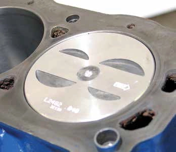

Flat top pistons with 4 valve reliefs mean that they can be installed in either orientation or side in the engine. Some pistons, domed pistons for example, can only be installed in one orientation. That's what the "4 valve reliefs" in the description means.
