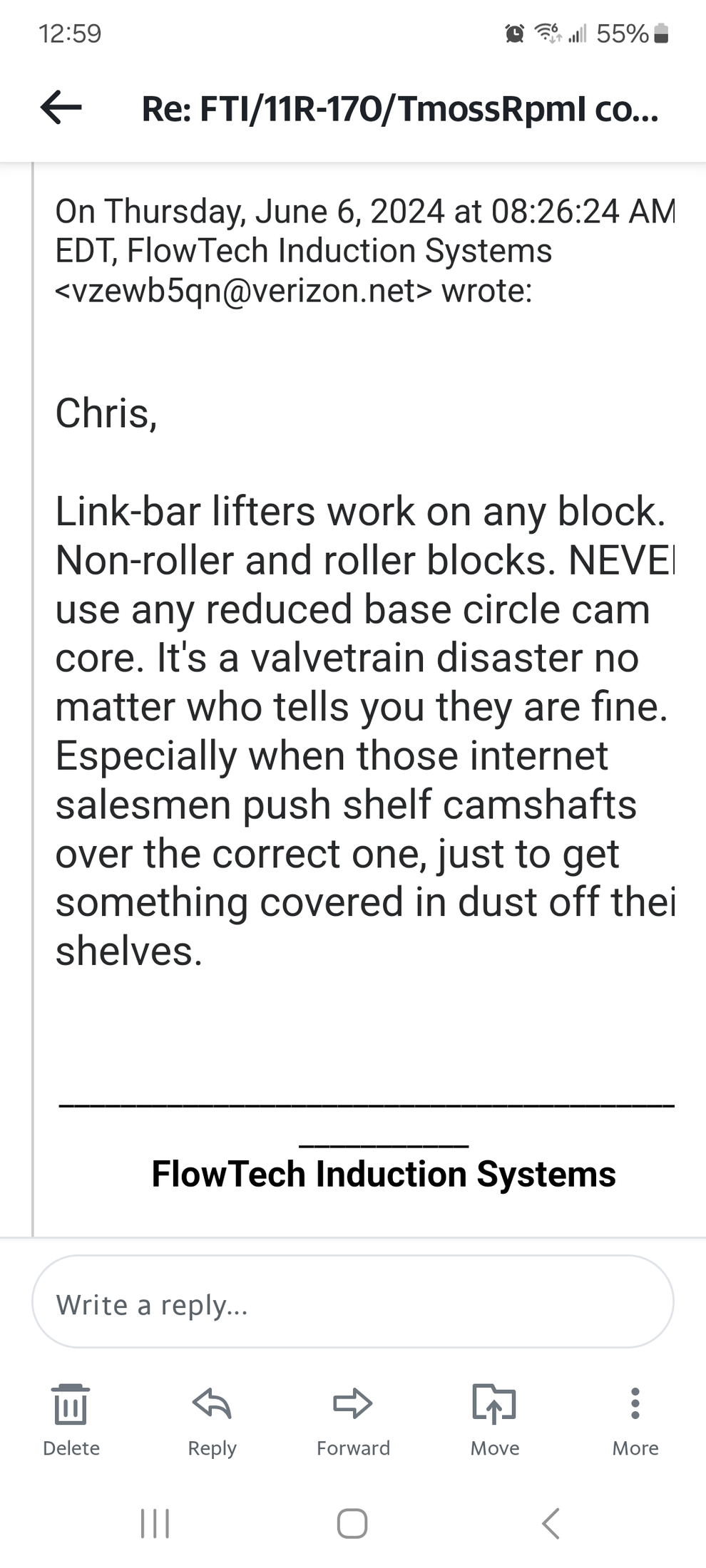

Converting to roller is not a big deal. You'd just need link bar lifters. They're a few hundred bux. Factor that into your calculus.

Well, you're right. They've gone up quite a bit in recent years, like everything has. Look up the Morel 7699 link bars. They're still going around $600 and will be going into my winter build. Not saying they're the cheapest, but at least cheaper than what you mentioned.
Looks like even stock hydraulic roller replacements would cost 170-260 from steeda depending on whether you want "high-performance."
Gotcha. Those are for "roller-capable" blocks though, right? The lifters I was looking at were the retrofit sets.... what I thought would be required for the OP's Boss block. Or I could just be confused. If so, then I blame it on having one too many (6-packs) today. :cheers:

I think you have it right.
Retrofit Style
Non Retrofit Style used to eliminate the dog bones from a roller block.
