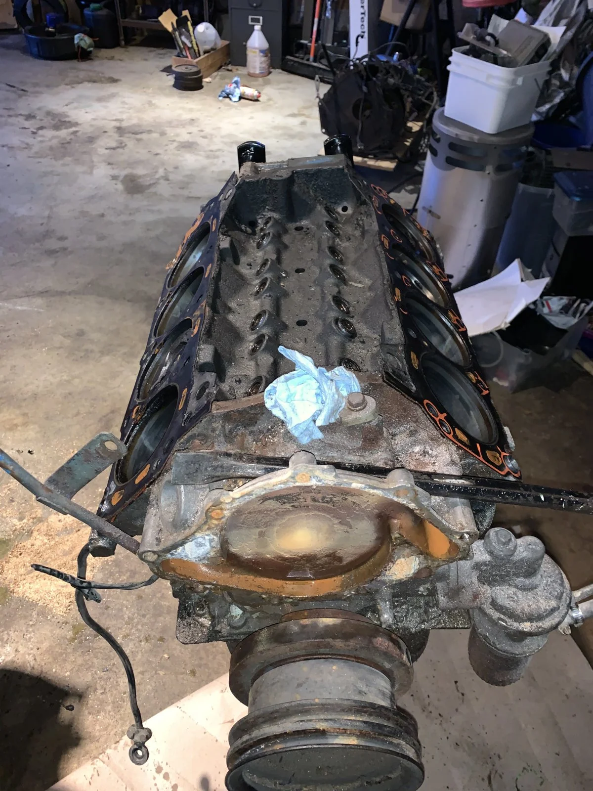

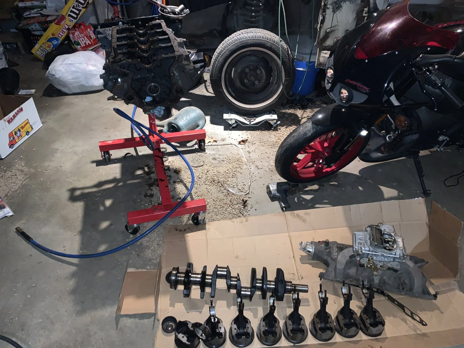

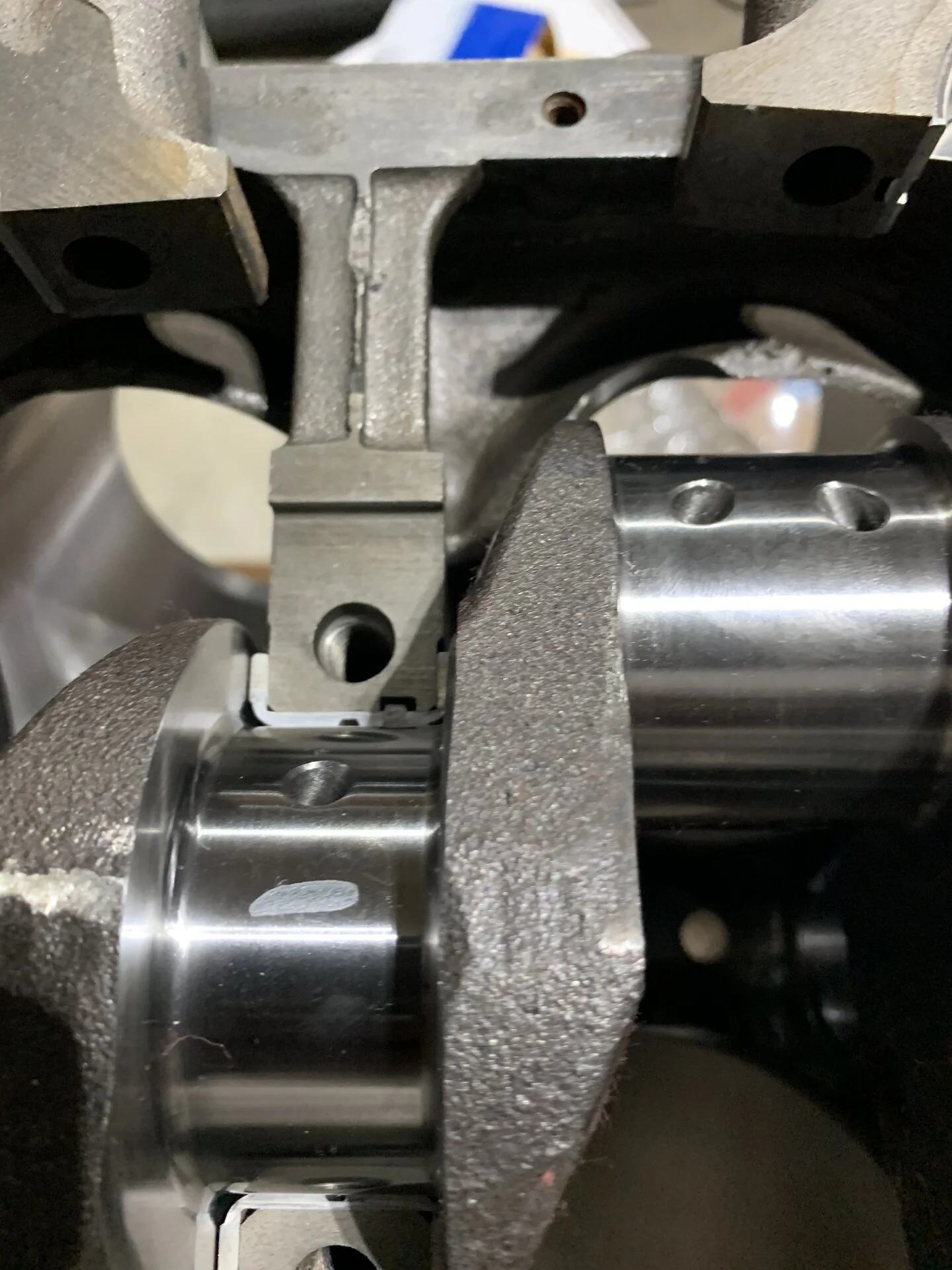

All,

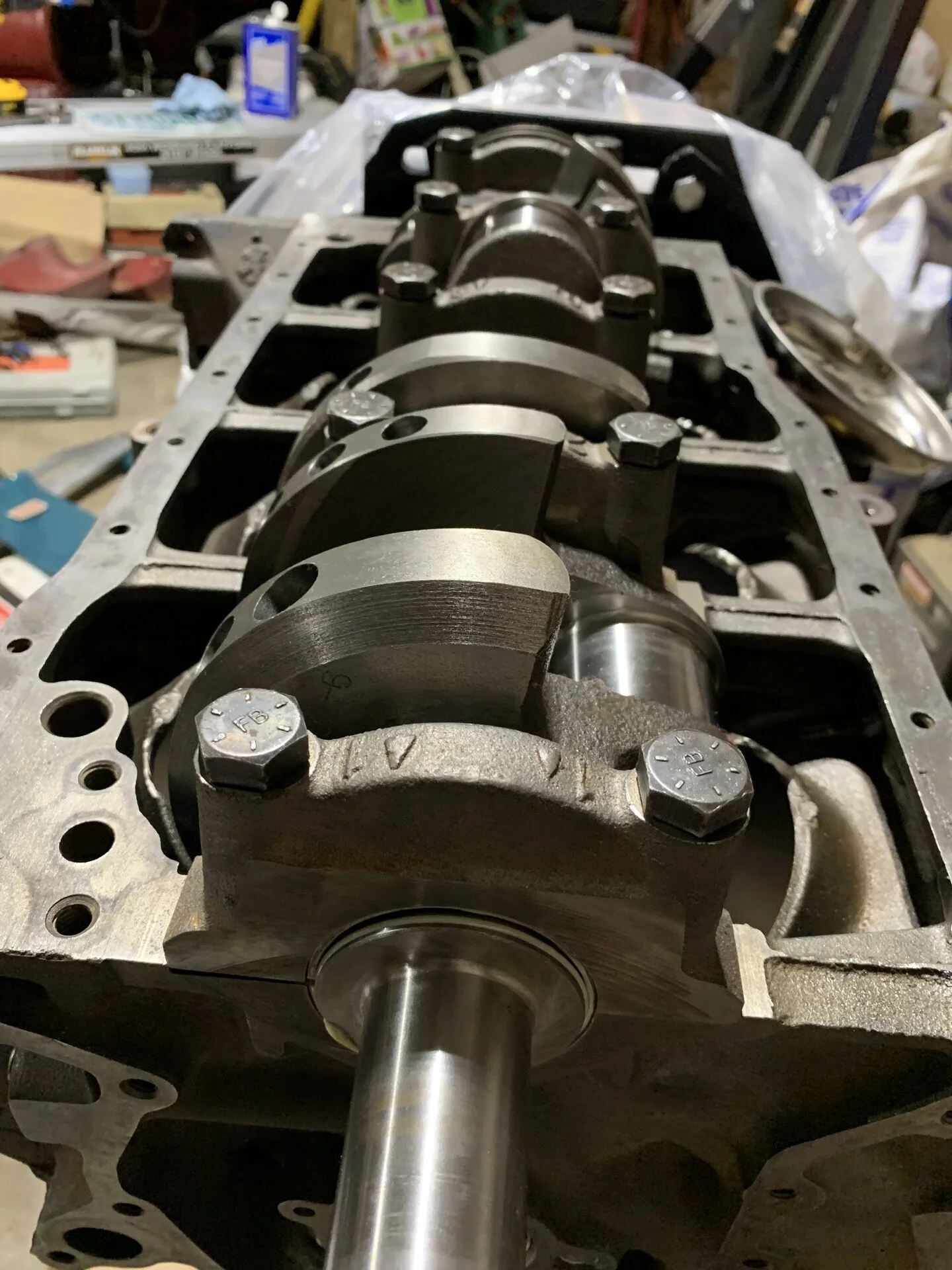

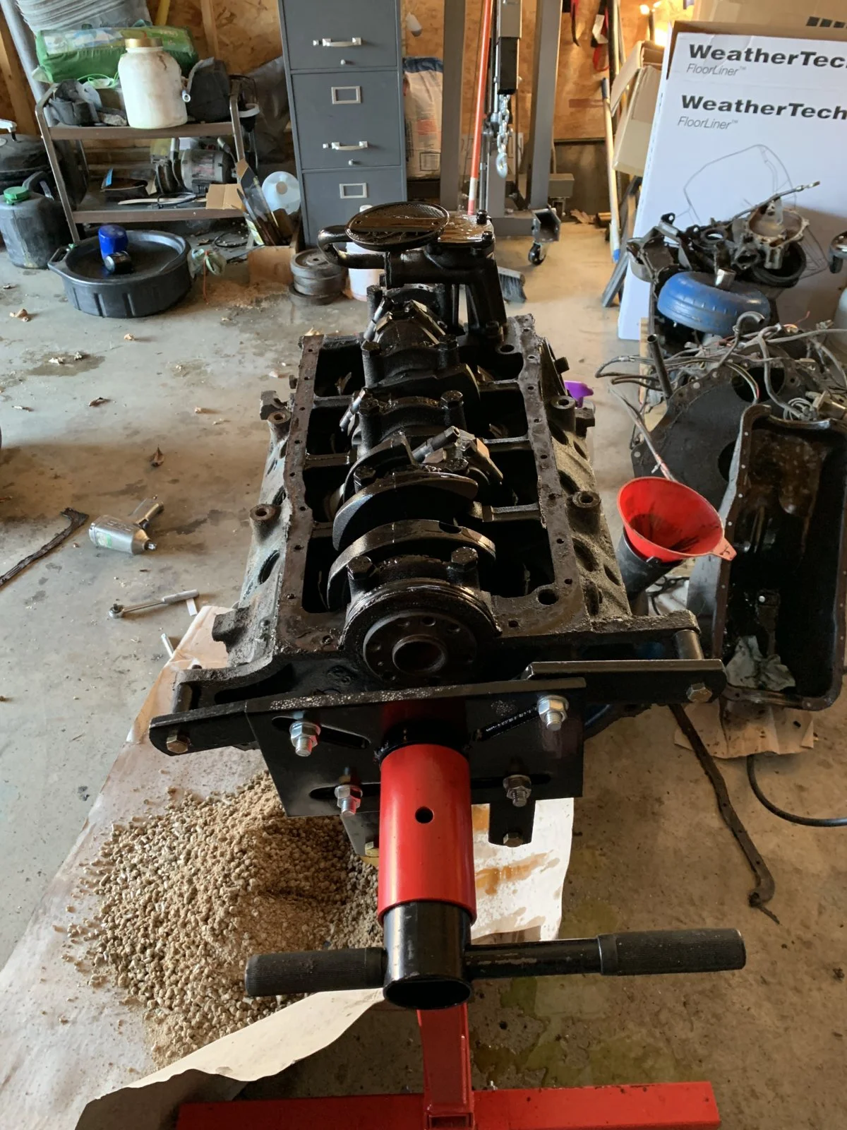

I know this has been beaten to death on the inter-webs and I have consumed mass quantities of said subject on said webs and have decided that I am going to build a 347 out of my old 302.
I wanted to start this thread for advice and things to watch out for while I am setting up to check the "Build a stroker motor by hand" check box.
I pulled the block out of a non numbers 6cyl converted to 8 cyl - '65 fastback I picked up a few years ago and am now rebuilding - was told it was a 67 -289 and was gonna sell it - but now with a 302 block - the 347 is in reach and what I plan to build. I am not looking to set records but I am looking to get well into the 400Hp mark.
At this point the plan...
  1. Eval engine block (magna flux) (other tests?)
  2. Bore block (machine shop identified - reliable verifiable work)

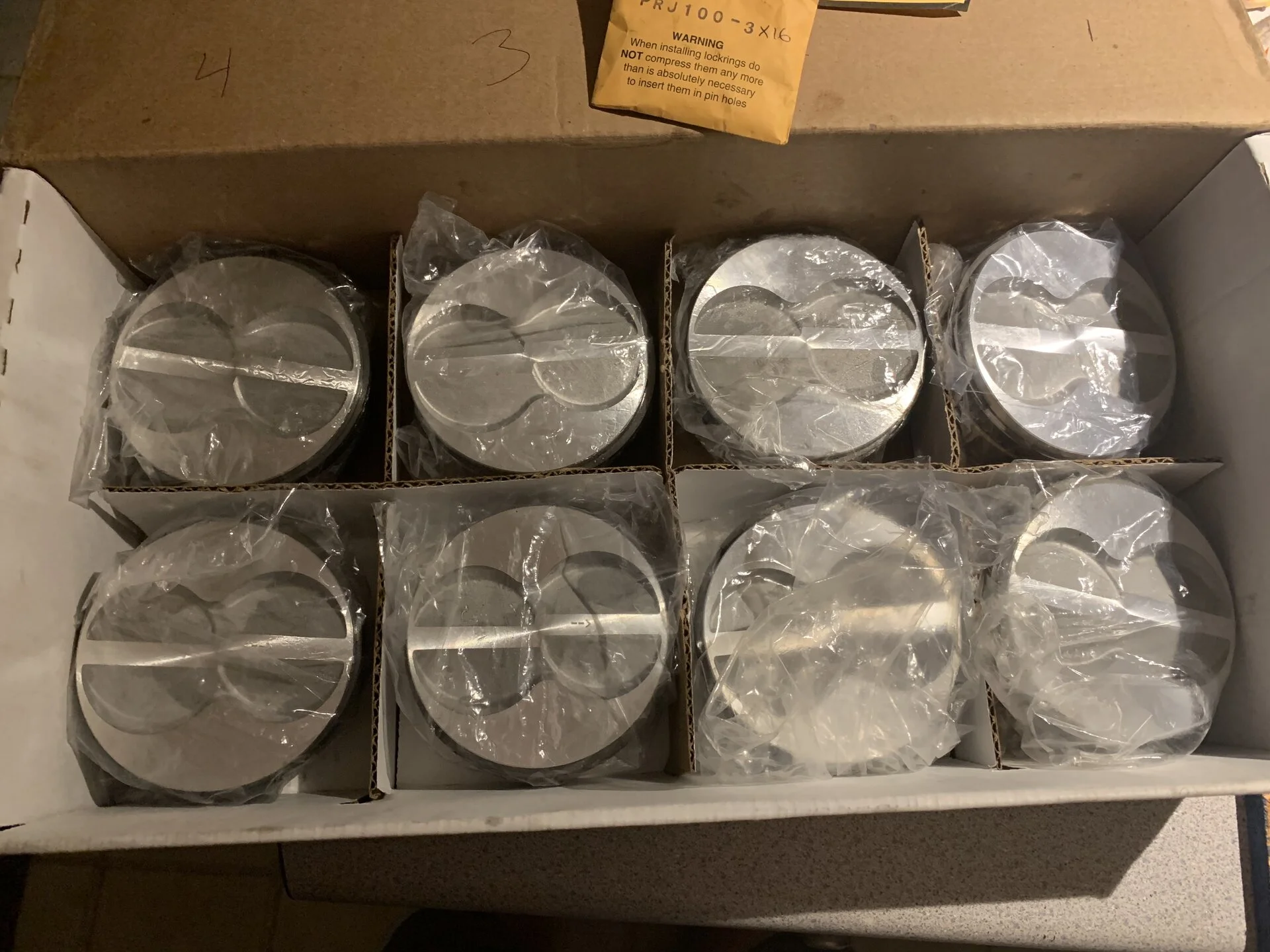

  3. AD Performance 347 kit

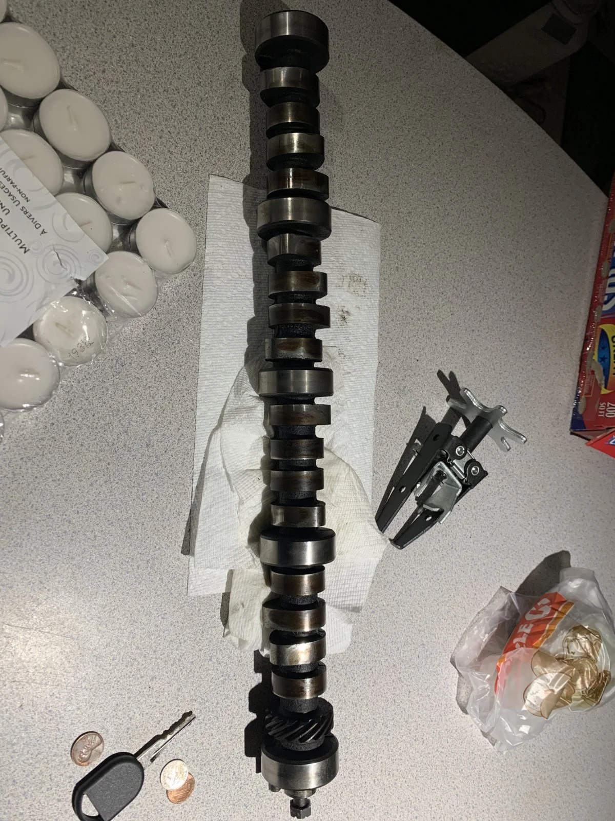

  4. There is a current aftermarket cam that I need to identify once I get it out of the block or source new CC262 or like?
  5. Cylinder Heads - Currently have iron heads from tear down - Looking for new aluminum heads - Gt40 vs X heads vs Trick Flow etc....?
Again - Purpose of this engine is going to be hard street use maybe a couple of drag runs a year. Going into a frame up Resto mod....
I have pics to post later - but wanted to put this up here so I can get thoughts from my fellow gear-heads and broaden my research to include direct input from motivated peers.
Cheers!
Ben
PS- That is a 70's Shelby lower intake manifold under the Holley 650.... Gotta look into that too :D SFJD-9425F...

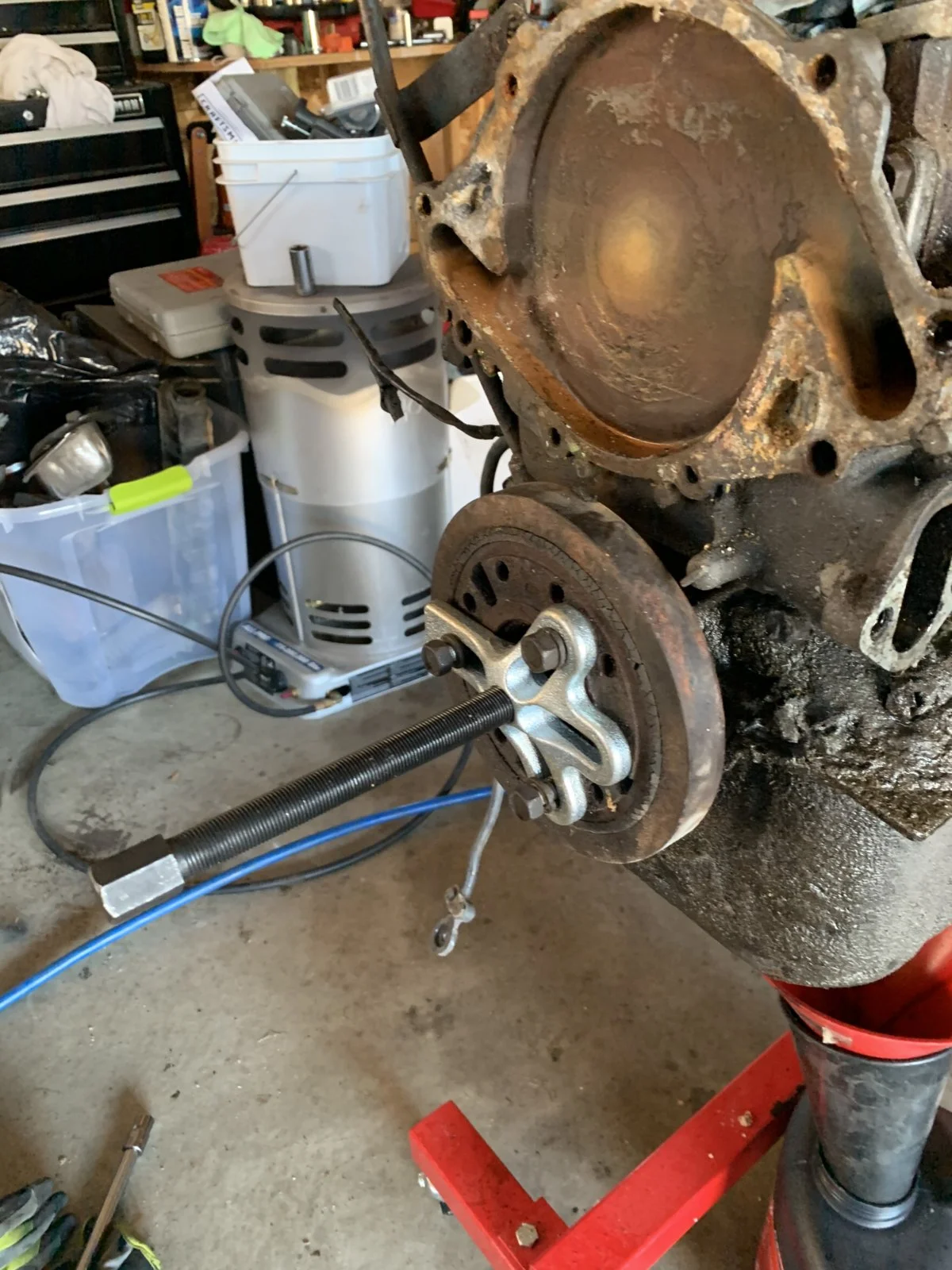

Thank much you for the input and thoughts . I will check those out! Right now having the distinct pleasure of trying to remove lifters that seriously do not want to slide out. As soon as I can get the damn cam out - off to the shop for ID :)

I like the 347 and I think you are making a good move. Good heads will be a must. They might be a little more expensive than some, but in my opinion AFR heads are the best way to go. Edelbrock makes a good head too from a quality standpoint. I'd be hesitant to trust a used flat tappet cam. 1 due to unknown wear and 2 new ones are not that expensive and then you know what you've got. Pick out the heads and engine kit you want and then call a couple of your favorite cam companies ( or some reputable ones if you don't have a favorite ) and let them suggest a grind for you after you give them all your information. It ought to be an animal when you get it built.
Reactions: bnero42
Thank you!! I like the heads, kit consult cam people idea alot... Great idea to call them and talk about the grind.

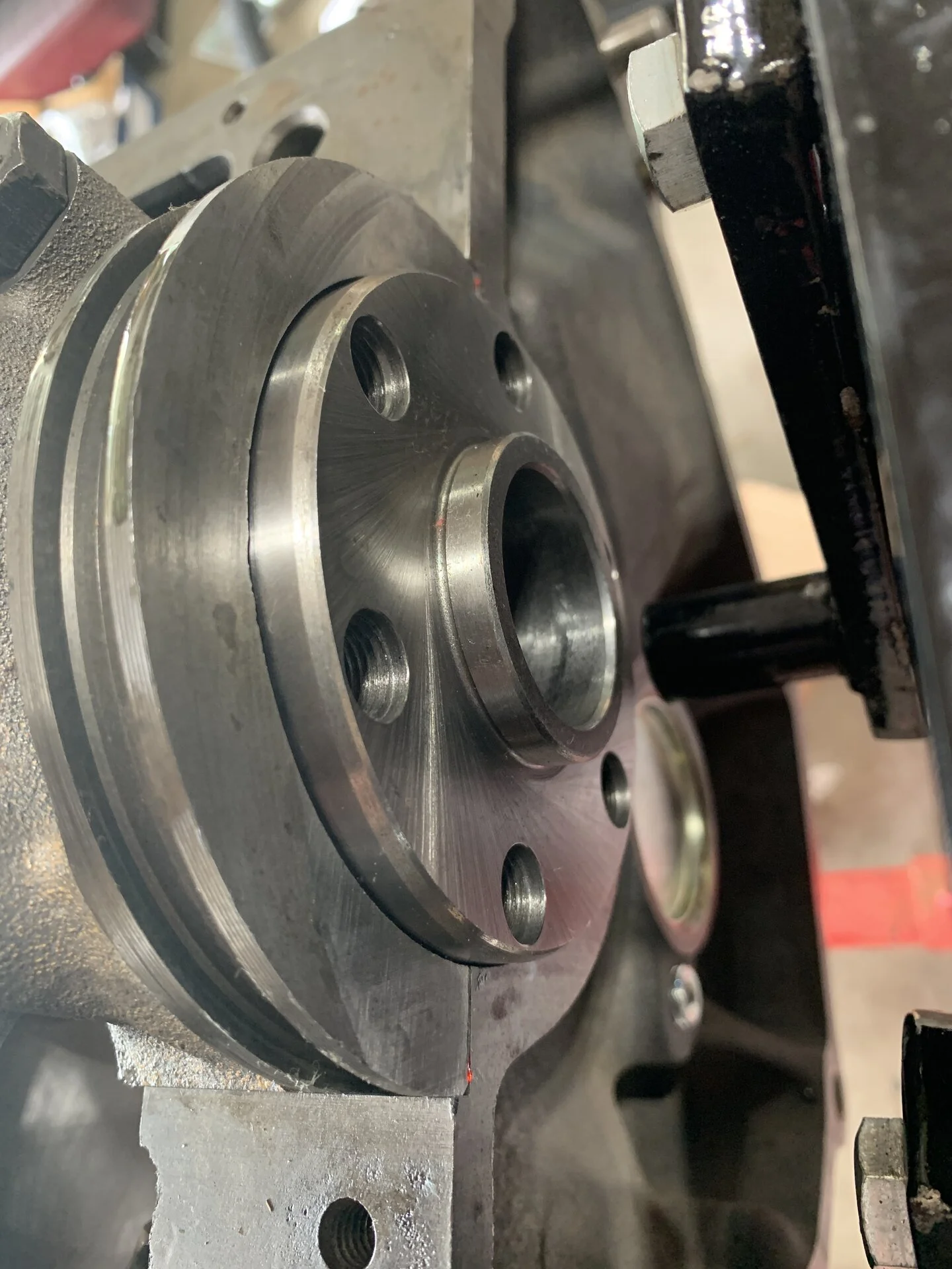

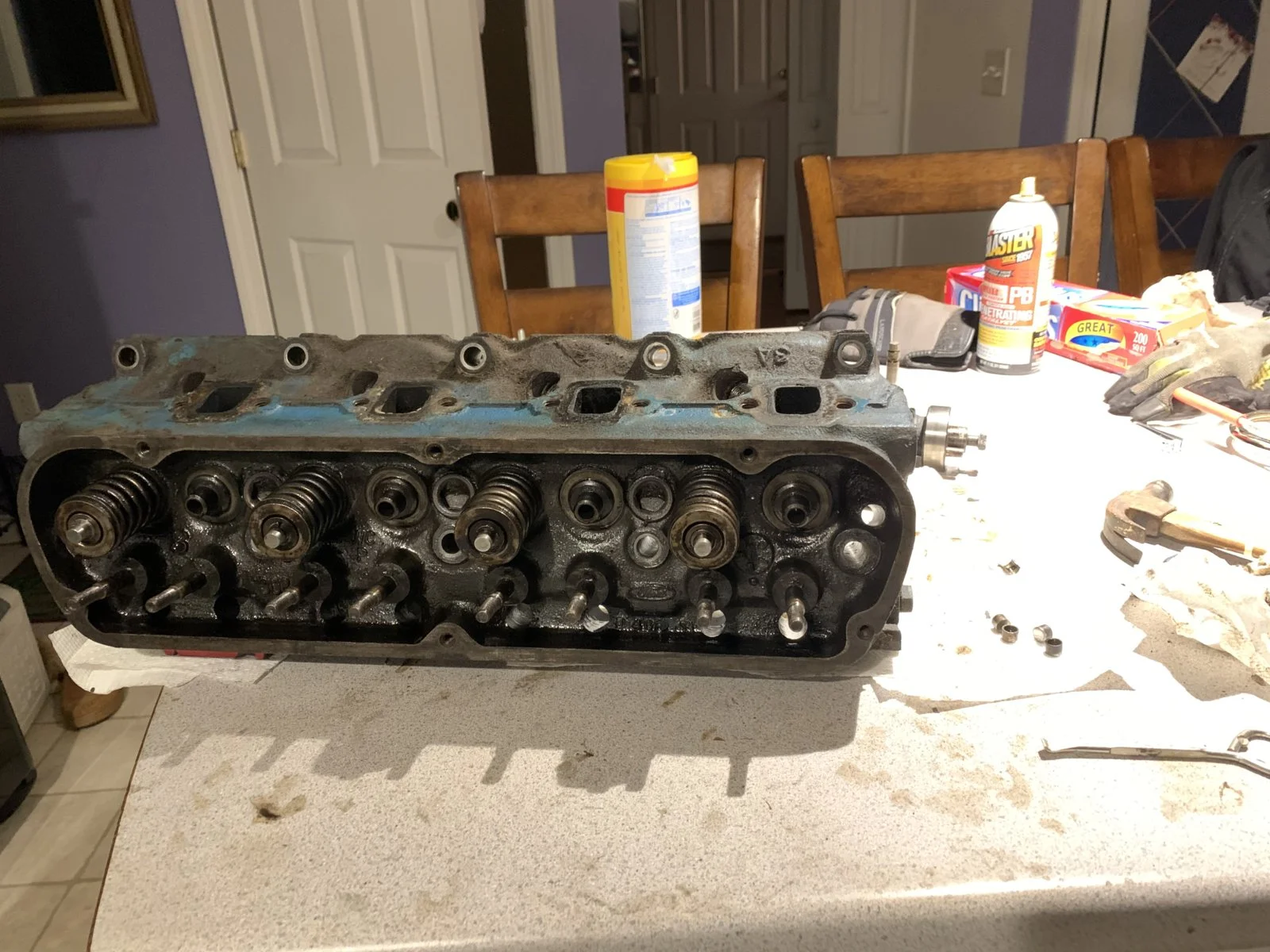

I got the cam out - still trying to id it for :poo:s and giggles.

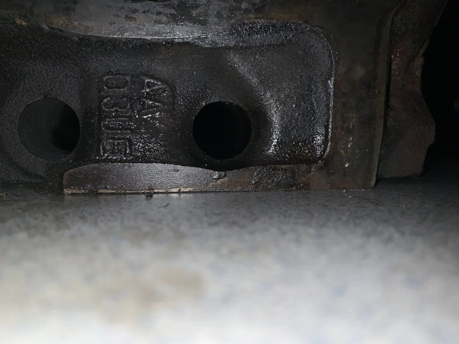

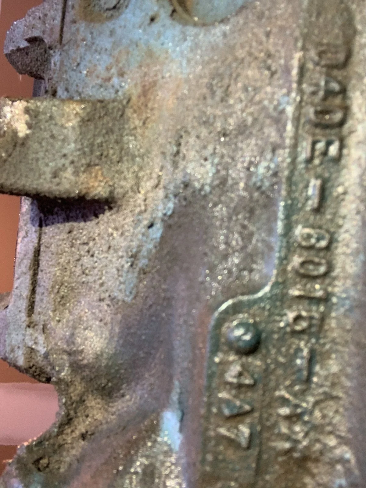

The cylinder heads have been a pain in the drain to id. D3UE-AA.
Using a small slide hammer to gently extricate the "stuck" cam shaft - haven't found any markings on it. yet but haven't cleaned it either.
Will use a new one for this build - per Rustaddict's thoughts.
I assumed the cylinder heads were not worth any work/salvage but D3UE-AA - cylinder head castings are not the easiest to find information on.
But I have googled and found they are decent - found this from a 2007 thread.
"The info I have on it is it was from a 1973 302, had 63cc chambers, 18mm gasketed spark plugs, and had no thermactor system. Might be a good set to work with."
It sounds like I will want to get new heads for this 347 build, but could clean/machine old ones for future build or maybe catch a few $$"s..
The Shelby intake is an SFJD-9425F casting 70's high flow lower - Maybe not for this build but a pretty cool little part to have.

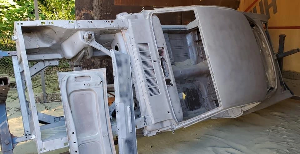

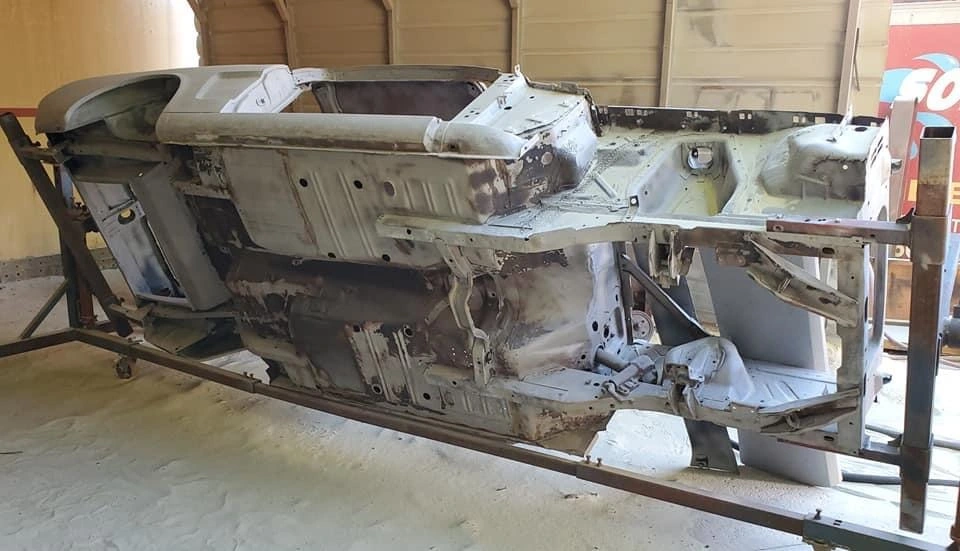

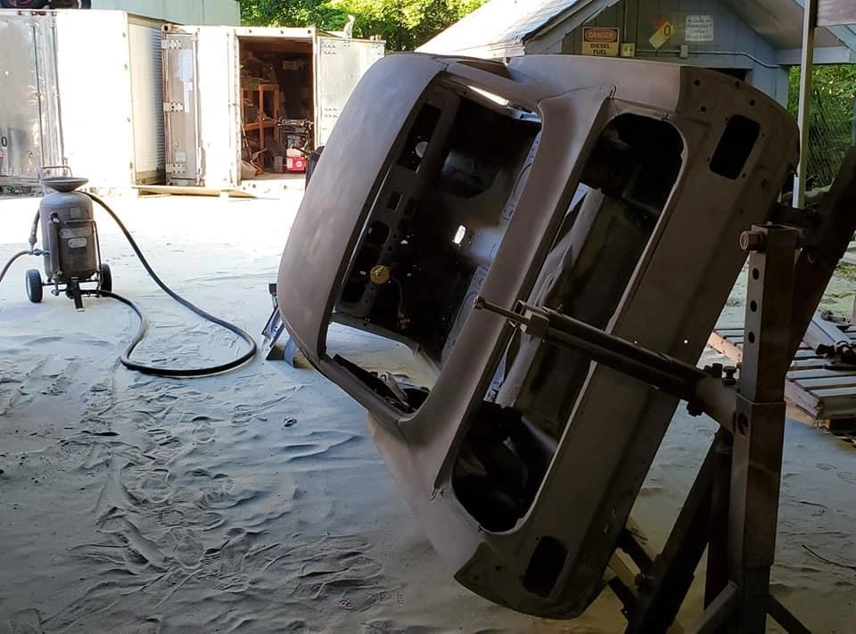

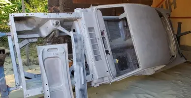

Building the 347 and my lady fastback on a rotisserie....
