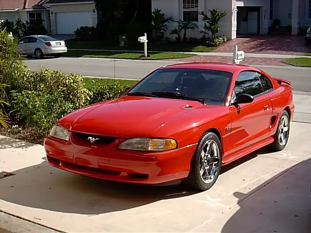

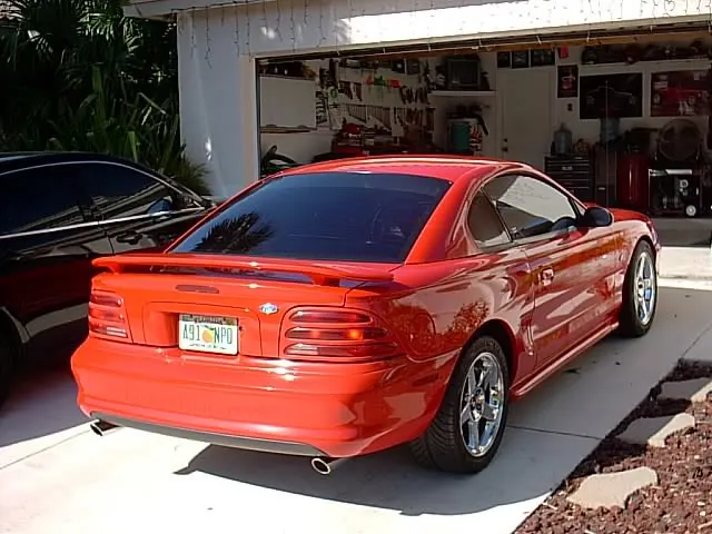

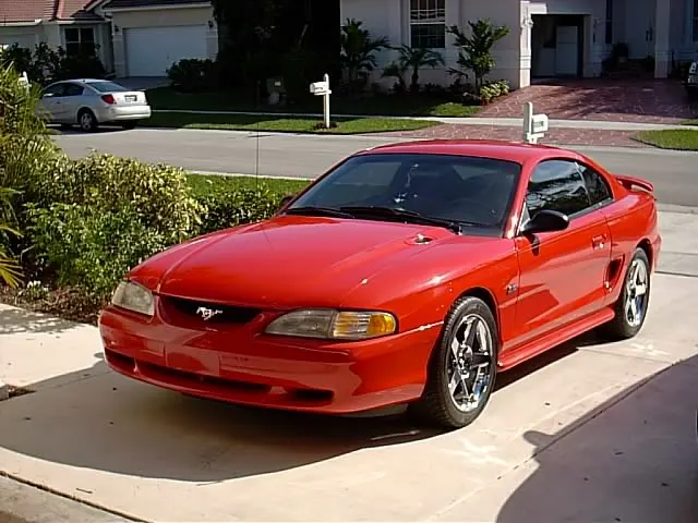

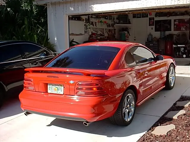

I'll take pics in a bit and post up.

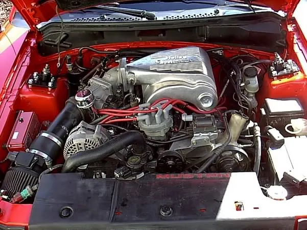

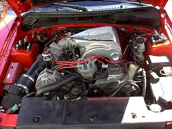

The engine pic is only temporary.

I also have some dress up stuff I need to get. Strut tower brace missing, plus some stuff isn't even bolted on yet (see hood strap). I also need to fix up all the wires and stuff.
03 Chrome Cobra's with 275-40-17's all the way around.
