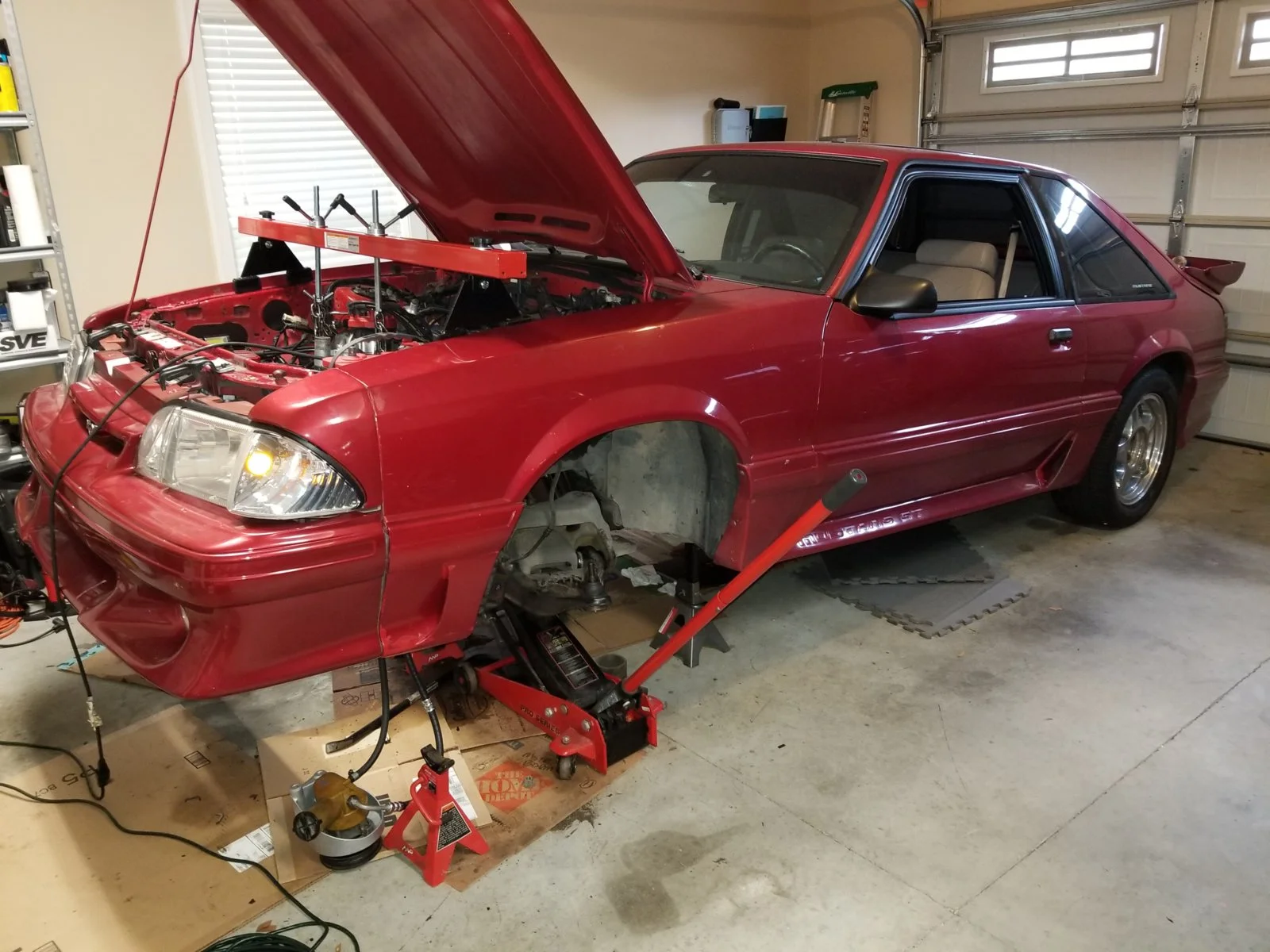

I know there are tons of threads on here talking about this subject so I'll apologize for this one up front. The car I've been working on the past several months has a 347 in it. I didnt put it together and the guy I bought it from couldn't provide much technical info. I'm in the process of sorting out the suspension and some basic engine issues at the moment. I'm hoping to poll the community with the little info I have just to get an idea of what I have going on now so I can plan a better or improved build in the future.
Current info that I have.
Displacement is 347, can't verify so just gotta go with it.
BBK SSI intake from a few years back.
BBK fuel rail and pressure regulator.
Ford 24# injectors.
Eldelbrock 75mm throttle body.
80mm ford mass air meter.
SVO X302 heads. I dont know if any work has been done to them.
Ford SVO B351 1.60 rockers.
MSD 6AL ignition.
MSD pro bullit distributor. I already had to rebuild the internals.
BBK long tube headers.

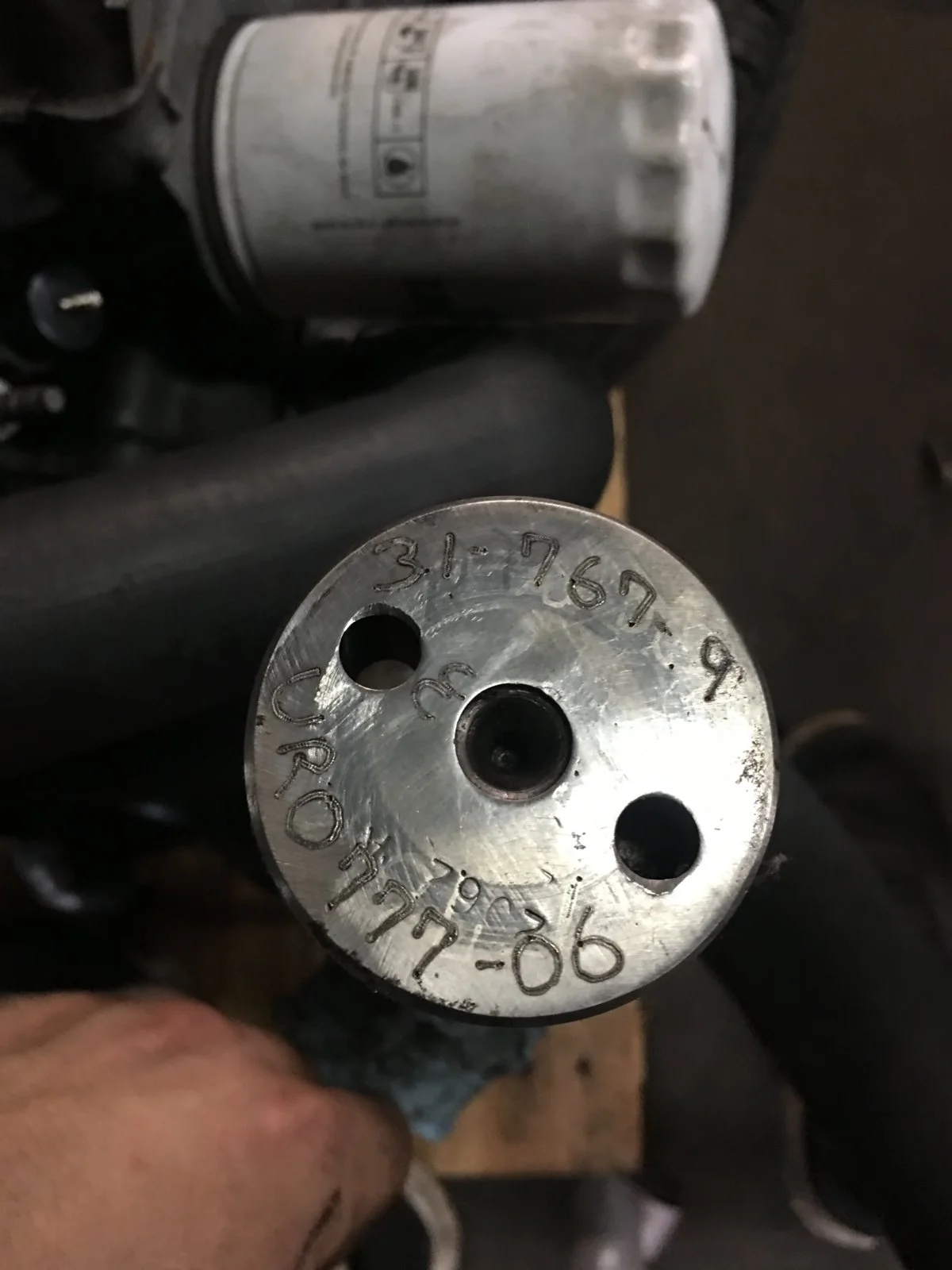

I dont know what cam is in it. I have the timing cover off at the moment. If I pull the timing gear off would the info be stamped on the end?
I also dont know what fuel pump is in it.
When I had the car running early this year it ran good but it wasn't what I would call a street beast!
Any educated guesses are welcome. I'm also open to upgrade suggestions. My goal is to make somewhere around 450 at the crank N/A. I figure the intake will go at some point and I know the injectors will need to be upgraded.
Not sure if those heads will support 450 horsepower, but should be somewhere close close to 400 at the crank depending on the cam I would think. The cam is the real factor. I know Trickflow cams have stamps on the end. Custom cams may or may not depending on the grinder. Sure wouldn’t hurt to look since you’re right there. The only negative I heard about that intake is fitment with fuel injectors. Don’t remember hearing many complaints about power delivery if you could get it all sealed up. I could be wrong there though, never went looking for info on it purposely.

Cam should have an engraving on the end of it. Get the numbers and google em.

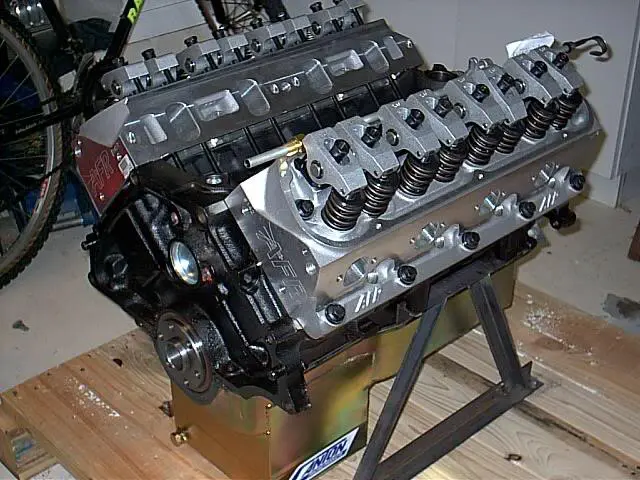

My Probe Industries 347 in my 94GT made 444HP / 458TQ at the wheels with a P.M.S. back in 2007.
347 Stroker
AFR 185 Heads
Comp Custom Cam .542 / .562 / 114 Lobe
Scorpion 1.7 Roller Rockers
Holley Systemax Intake with Ported Snout to 75MM
Edelbrock 75MM Throttle Body
Pro-M 80MM Mass Air Meter
30 Pound (Red) Injectors with Kirban Adjustable Fuel Regulator
MAC 1-3/4" Ceramic Long Tube Headers with 3" Collector
MAC 3" Prochamber
MAC 3" Cat Back with 3" Chrome Tailpipes
Full Steeda Suspension
I had those X302 FRRP Aluminum Heads N/A and also with a blower (see below). Probably not the best choice, very small valve 1.94 x 1.58, swirl chambers, castings are meh (very rough), everything just seems small. Compared to the AFR 165's it's night and day, CNC castings. The AFR 185's below on my 347 were gorgeous, didn't want to cover them. That combo is probably in the 325-365 HP range, I"m just guessing though considering you don't know all the key components like the heads, cam, etc.

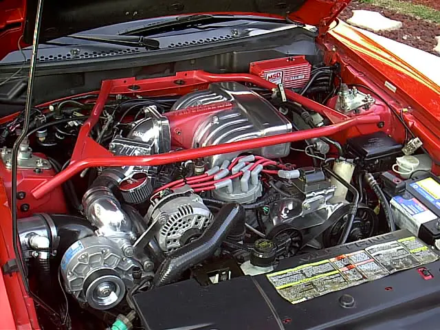

Stock Vortech Supercharged 302 being pulled, 487HP / 460TQ with FRPP Aluminum X302 Heads, Crower 15511 Crower Cam, Edelbrock RPM Intake, 42 pound injectors, MAC 1-5/8 Long Tubes, 2.5" Prochamber, MAC 2.5" Cat Back.
94 Mustang Sleeper Supercharged by jpjr501, on Flickr
Untitled by jpjr501, on Flickr

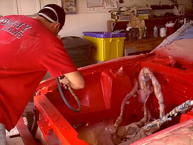

Tucked wiring harness in the fenders, blocked off a bunch of holes and resprayed the engine bay.

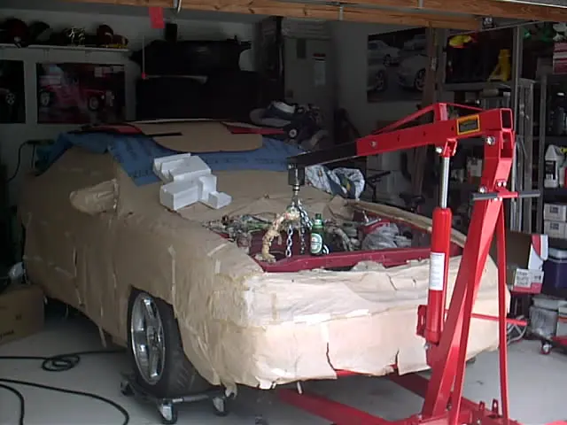

The Stroker arrives at my house.
Installed 347 Stroker

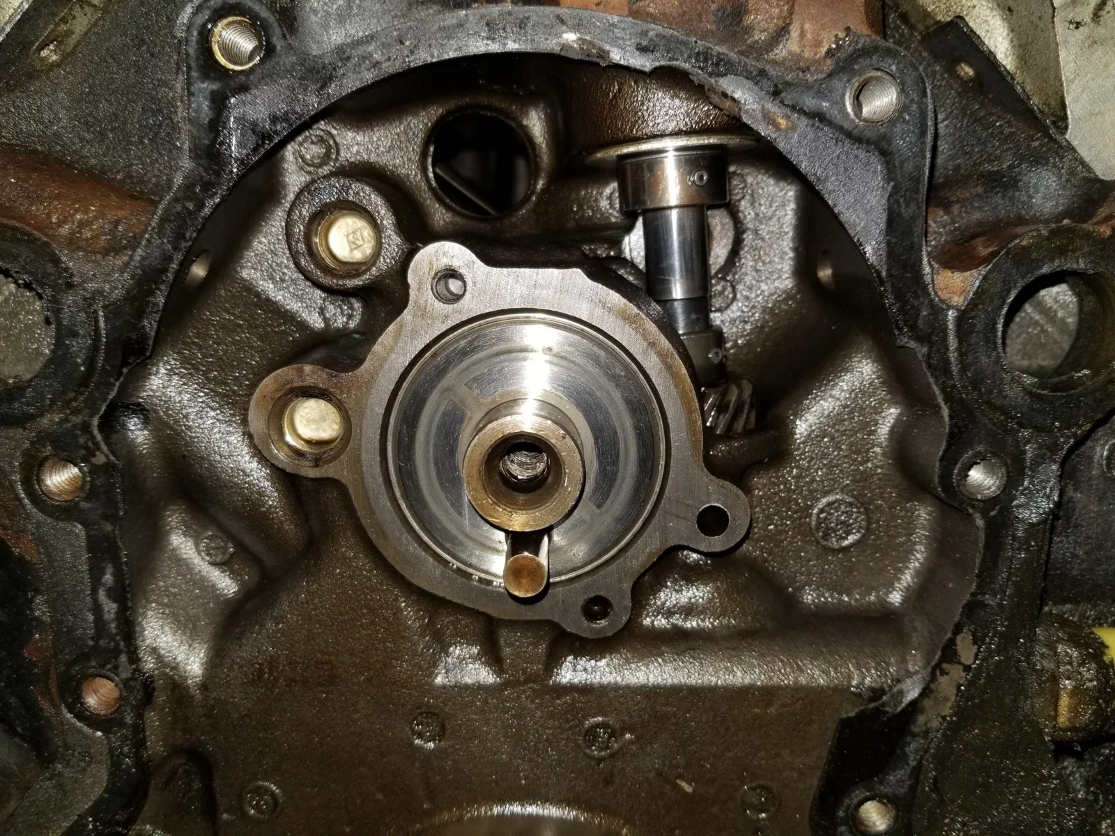

Mine have markings on the back of the cam like this.
You can also degree the cam and measure lift with a dial indicator and duration with the degree wheel. This will at least get you the specs.
Thanks for the pic. That's what I was hoping to see when I pulled the timing gear on mine. I just wanted to make sure there wasn't an extra thrust washer or something that also needed to be removed. I just put it all back together last night. I was terrified that something would happen and make the valve train shift and screw everything up! The cam is still in the car with the heads on so its under load. At some point I'll pull the motor and bust it down. It would have been nice to know the specs just for tuning and to give me a solid idea of what to expect out of the car.
I'll go ahead and ask another beginner question. Is there a way to measure any of the specs with the cam installed. Maybe from the rocker side on the heads??
Looking at pics of cam markings on line, it looks like it might be marked on the other end.
do you have the intake off? if you do its a simple job of loosening the rockers, removing the pushrods, then you can pull each lifter out of its bore once the spider and wishbones are removed.
Then you carfully remove the cam, use a long bolt that will thread into the cam as a handle and go slow. its not that difficult to do, and if its a roller engine the lifters can go back in anywhere... it does not wear in like a flat tappet.

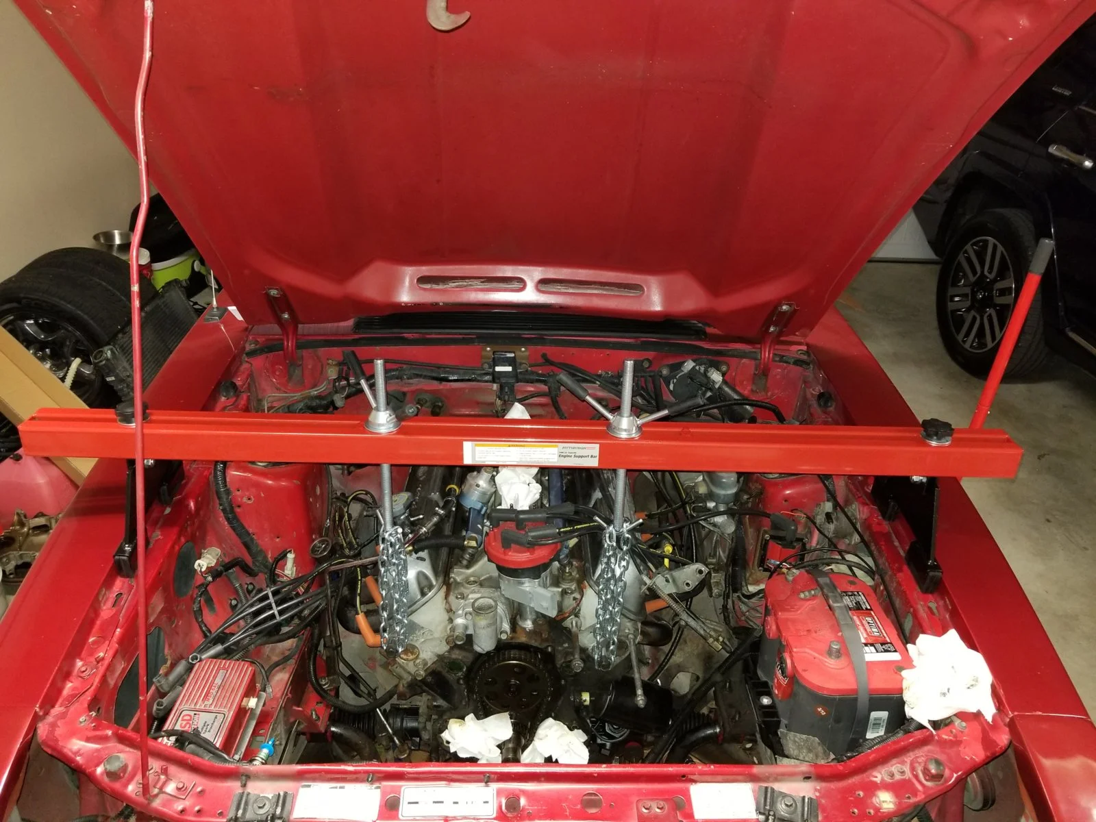

The motor is still in the car. I'm going to pull it at some point just because I want to give it a fresh rebuild and do a HCI that will actually make better power. I'm attaching a pic I took of the car just the other night. The motor is being supported because I'm in the process of dropping the K member to change the oil pan gasket. The ONLY reason I'm doing it this way is because I'm in the middle of redoing all the front suspension and the only things on the K member are the control arms. Everything else is off the car. The gasket on the motor is one with the metal core. Anyway. While I'm in there with the motor loose I'm installing some new poly motor mounts. Thanks for the help!

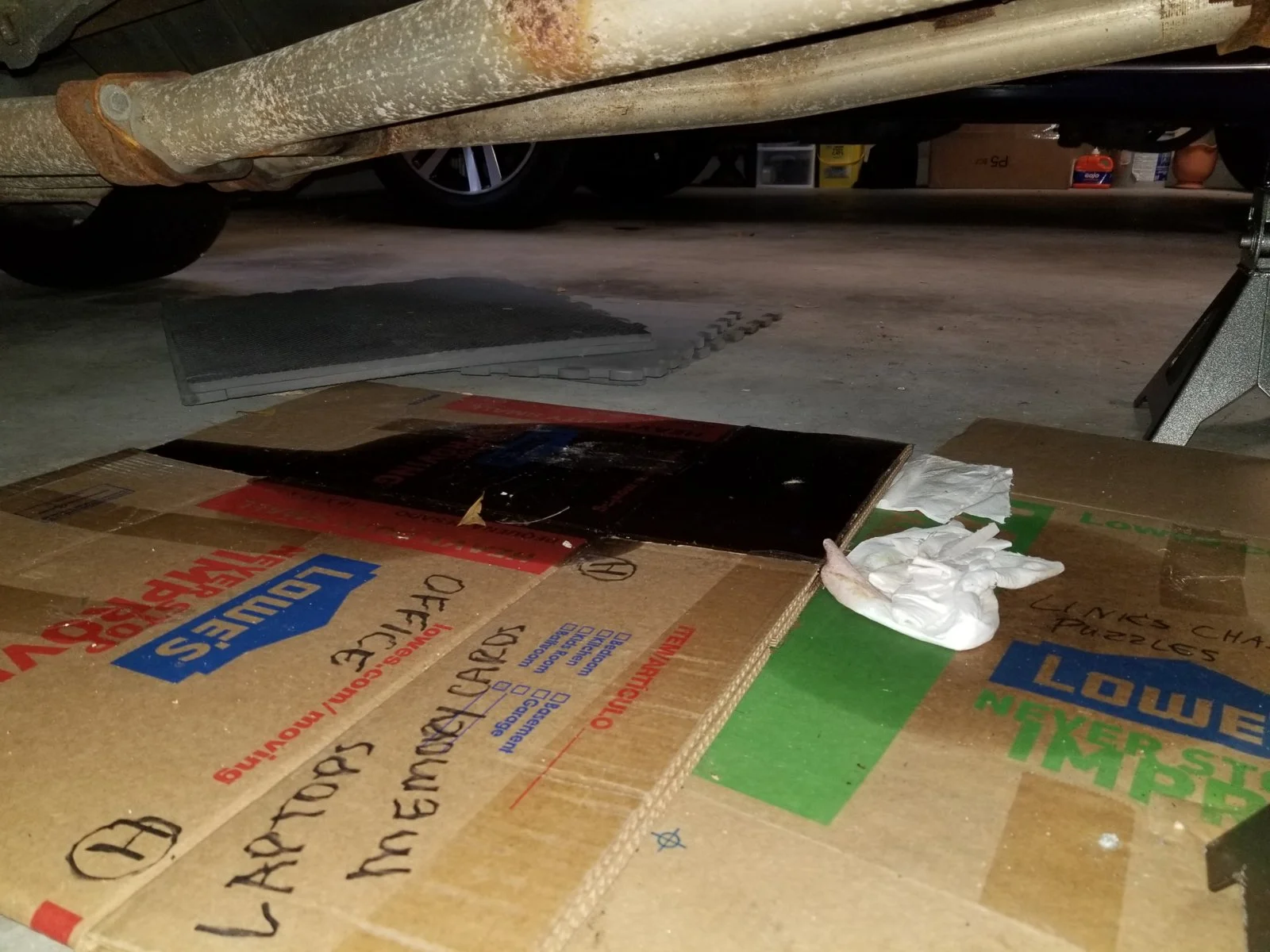

This is a little off topic, but at least it's a thread I started. I had a shop do some work on my car a few months back and one of the things I asked them to do was replace the leaking transmission tail shaft seal. The car is currently lifted with jack stands in the front to allow me to work on it. I was under it last night and noticed that the cardboard under the transmission is soaked in oil. Before I get mad at the shop, again, I thought I would ask if having the car jacked up like I do is causing the issue. I'll attach a couple of pics. The car has been on stands for about a month now, but only up this high for a few days.
