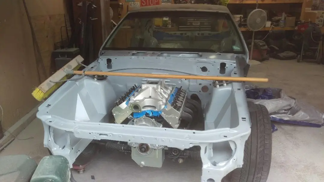

351 Hood Options

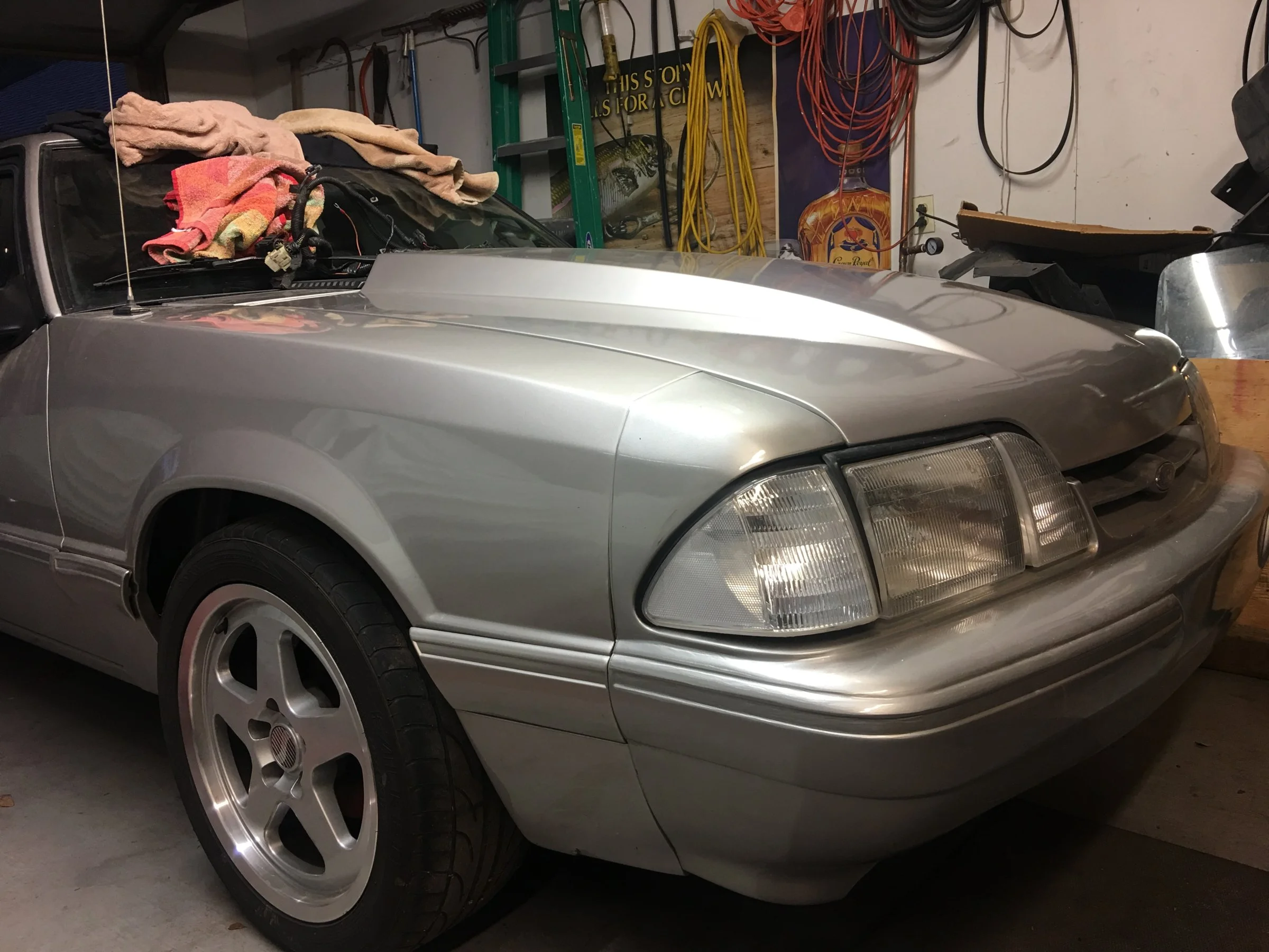

Pretty much any 2.5 inducted cowl or larger. I really like my Cervinis although I'm in a slightly different boat.
How radical/tall will your intake be?
To be determined on what intake we're going with. I prefer it as subtle as possible. Once the builder gives me the options, I'll report back. I can deal with a 2.5".

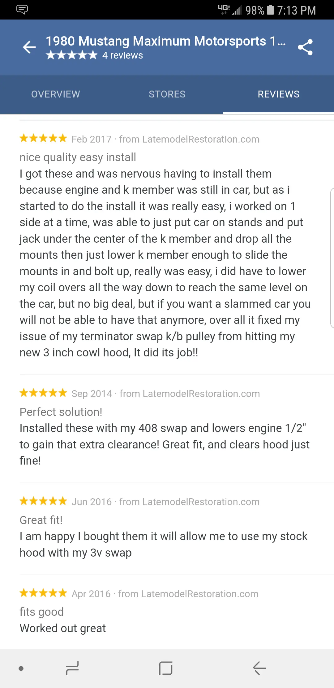

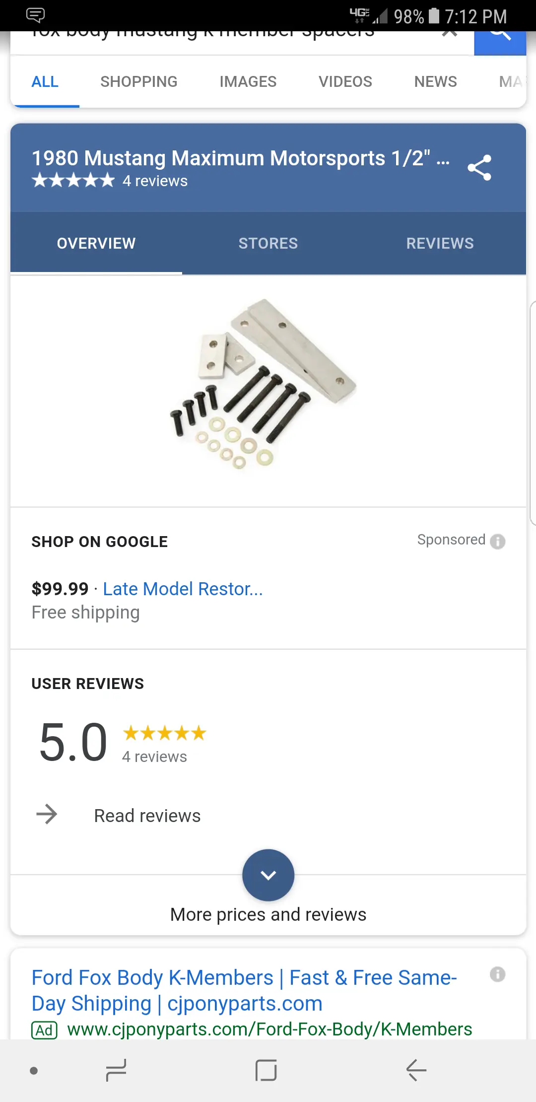

I've seen people space the k member down to add hood clearance. If using a truck lower that bolts to a Holley systemax intake you may be able to use the factory hood. If using tall valve convers it'll cause the intake to need a 1 inch spacer. You could get away with stock valve covers with 3/8 spacers under the covers... that would allow use of a 3/8 to 1/2 spacer on the intake. Space the kmember about 1/2 to 3/4 and it may clear.
Dropping the k member will cause the rack and pinion to drop as well. Offset rack bushings can help regain some off that, but it depends on the pan you're using. The steering shaft may need to be lengthened depending on how low you go.
Just keep in mind that the suspension geometry would change. Lowering the k member is like raising the front of the body. Coil overs would help even the wheel wells back out for ride height.
With 1/2 spacers you should be able to clear a stock hood..... MM makes a decent set....

It's a street car. Set up for the track, but the chances of me taking it there are slim. I just want to cruise. I have a Maximum Motorsports K Member. The car is efi and I believe we'll be going with an Edelbrock intake.
The 2.5 cervinis is doable. It looks pretty damn good on @hoopty5.0 's car!
