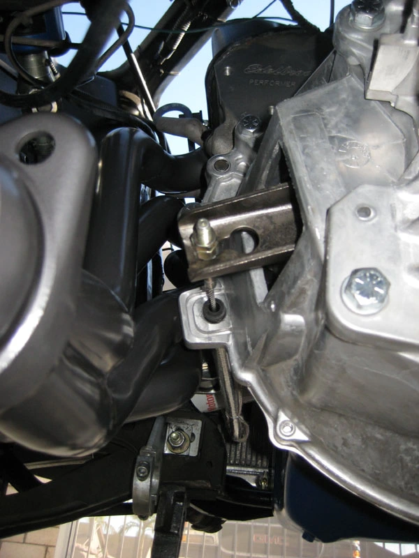

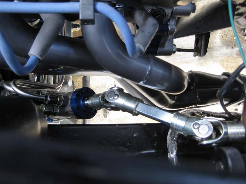

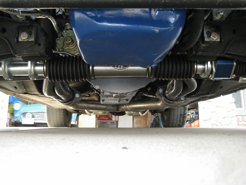

yeah. Im sure there are less expensive ones that will fit. but these are thick tubing, thick flanges. if i remember right they were coated inside and out. had them for year and 8 months, coating still looks new.
the clutch cable runs inbetween a couple of the tubes. I just put one of those aluminized fiberglass insulator sleeves where it gets near the header.. never had any issues with my clutch cable.
you can get a socket on almost every bolt except for one or two.
