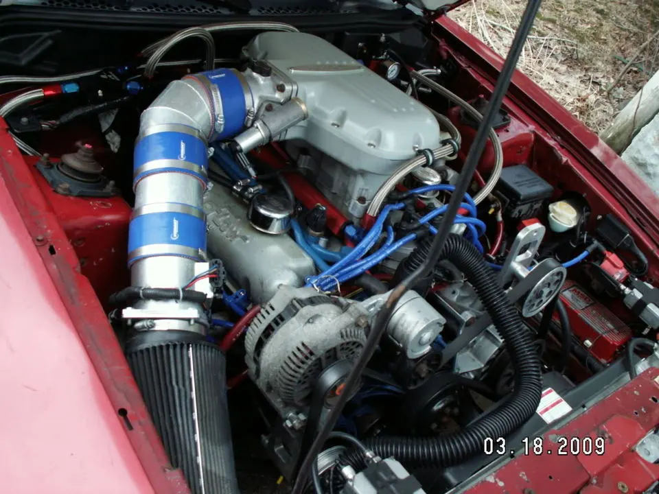

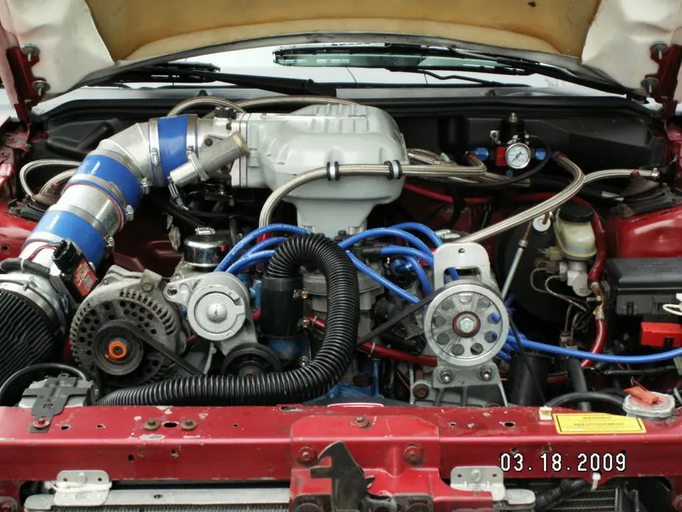

First off 30lb injectors are too small....yo need prefably 42lb injectors if you want to put down 460HP...Also what intake are you running??? Hope the Throttle body isn't smaller than 80mm or it will cut down high RPM air flow. You need either a 90mm trickflow R or a Spider intake capable of feeding high volumes of air. I have a 383 from a 351 roller and my 36lb injectors are almost too small. I also have a 90mm Trickflow Box intake....Which is a necessity on a 408 if you want to make near that 500hp mark. Heres a pic of my efi setup.

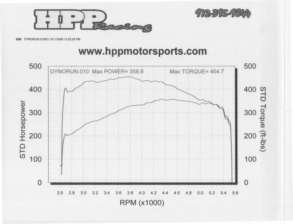

OK, so i have taken everyone's advice. Here's what i did
-new "EFI friendly" cam....at least according to Lunati
-42 lb injectors
-pro-m 90mm mass air(calibrated to injectors)
-fuel pressure set to 45 psi
-did some minor porting between throttle body and intake.
as you can see from the attached dyno run, power and torque is now about what it should have been in the car with looses. Used to be 460 hp 450 torque with another more aggressive cam on engine dyno and carburator. Now in the car, with drivetrain loss, HP down some, but torque is close to what it was on engine dyno.
Car seems to have a ton of power driving...its a shell now. Hope i can get that power to the ground.
thanks for the help
What is the engine combo including cam specs?? that engine does not want to rev at all..
cam is a lunati #61011 272/280 advertised duration
Still running the 76mm throttle body, so obviously thats part of the problem. My intake is also not rated to flow enough for the engine combo(Eddlebrock performer II intake) . The recent upgrades and mods have obviously helped it a TON, but a bigger intake and throttle body is next. My MSD 6AL2 ignition was set to limit revs to 6k but repeatedly cut out at 5500 rpm, strange.
