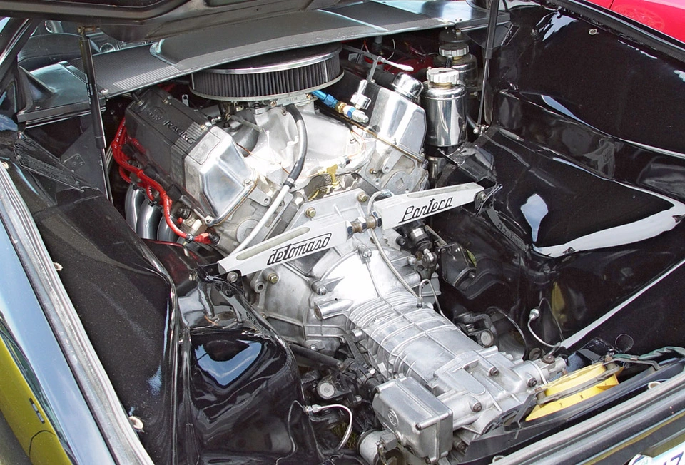

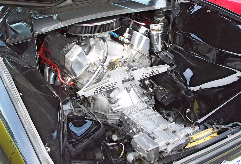

A 4V Cleveland is a nasty engine....it'll put any equally built Windsor to shame...the problem is price and part availability, not to mention the availability of the engine itself. For those who are knocking Clevelands, you should have a look at a 4V Cleveland head sometime...they're a work of art.
Oh, it was also the engine of choice for the DeTomosa Pantera..
