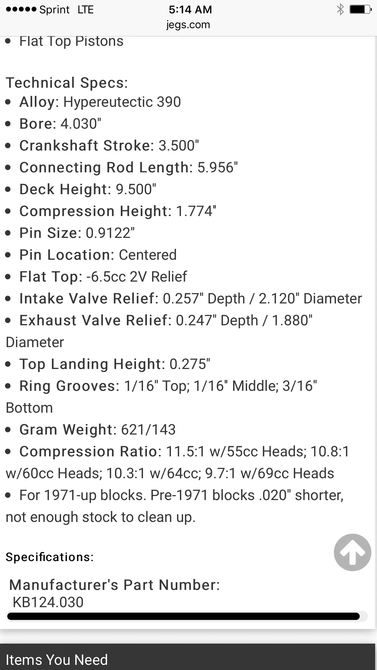

This doesn't tell what thickness headgasket they used, but piston manufacturers always give a compression ratio with different cc heads for the pistons they sell.
Here are yours:
This is claiming 10.8:1 with 60 cc heads and you have 61's. You are looking at premium fuel at minimum.
